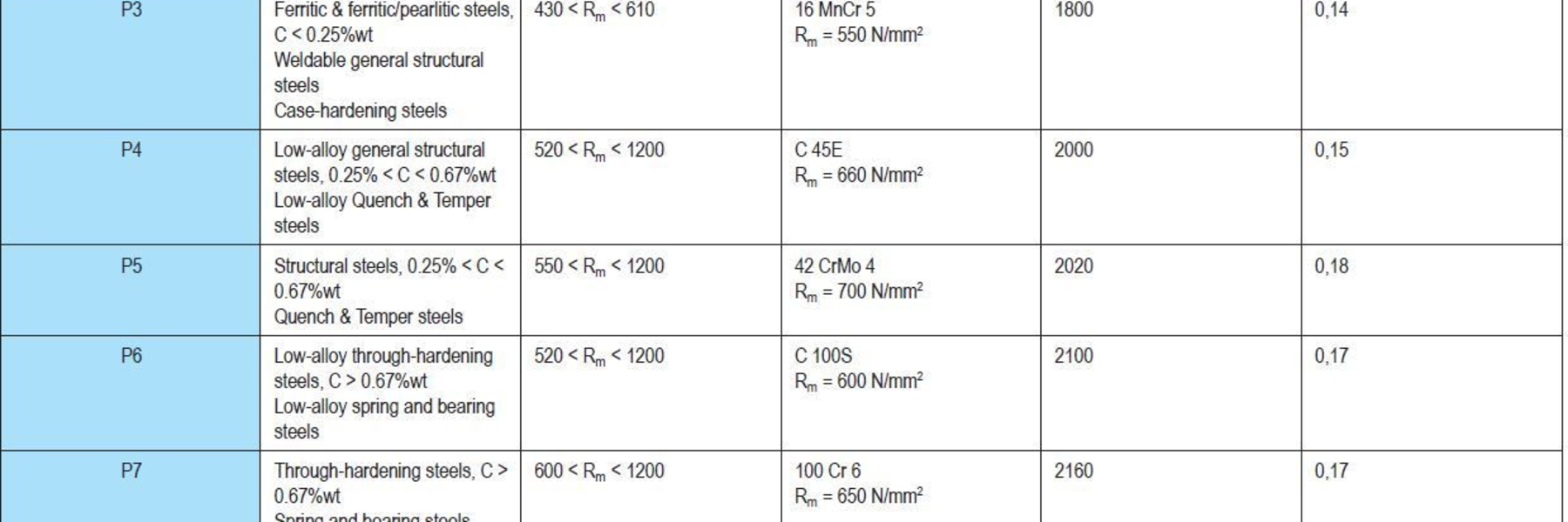

SMG P materials - Steels, ferritic and martensitic stainless steels
ISO P Tab extract
