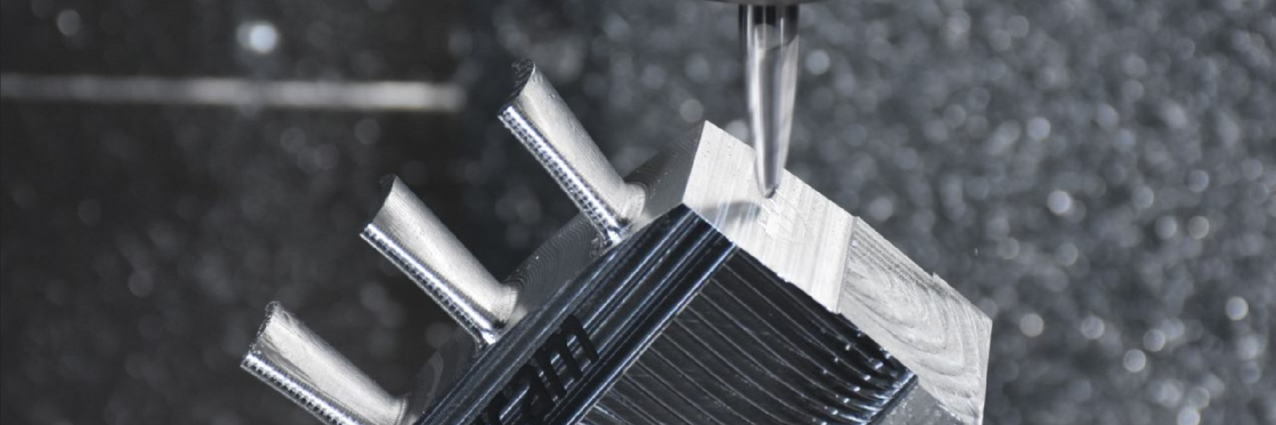

Material: 6061-T6 Aluminum
Machine: Haas UMC-500SS
![Aluminium Blisk machining](https://prod-usercontent.azureedge.net/Content/UserContent/Images/035554.png-l3koad0wbcc.jpg)
Accelerated finishing tool: Customized Seco Barrel Tool from JH7 ranges
The collaboration came to life for attendees of the 2023 Haas Factory Outlet Demo Day in Pittsburgh through the live creation of an aluminum blisk (pictured) machined by a Seco Barrel. While the flute geometry of Seco's barrel tools was originally developed for stainless steel and superalloys, Seco expanded on the design to meet the needs of machining aluminum. By customizing the flute count and geometry, aluminum chips are directed away from the cutting edge during a heavy cut. The tailored design produced improved surface finishes in aluminum and enabled more aggressive cutting parameters.
In addition to flute geometry, Seco also can specialize tool profiles to produce more reach, an alternate tangency angle or a different root fillet to optimize performance for specific applications. To use these innovative customizations, shops can type dimensions into Mastercam’s Tool Wizard to take advantage of parametric tool definitions and create matching custom geometry. Mastercam automatically generates a new tool profile with each change in tool parameters.

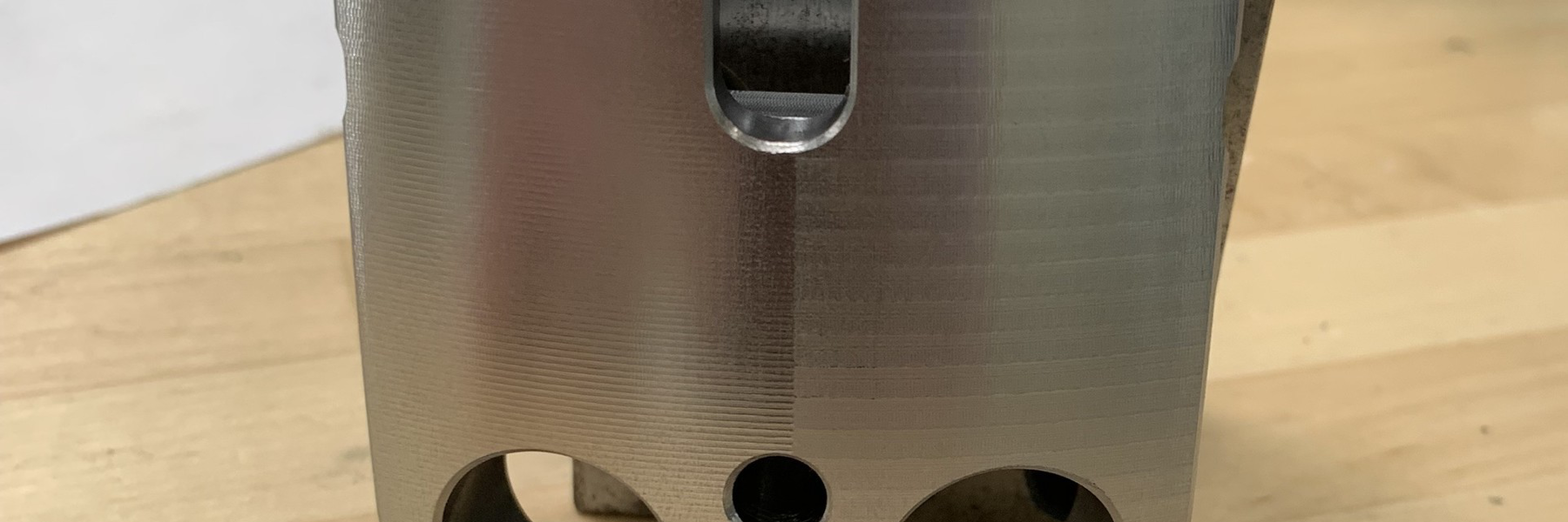

Material: 4140 Steel
Machine: Kitamura Medcenter5AX
Accelerated finishing tool: Seco Barrel JH7 series
![Steel Medical Clip](https://prod-usercontent.azureedge.net/Content/UserContent/Images/035555-5wydnkmrawk.jpg)
In addition, Seco and Mastercam know-how converged at NEXT Industries’ August open house event to showcase a side-by-side demonstration of a medical clip.
Accelerated finishing was applied to half of the clip’s surface area and a traditional ball endmill used on the other half. Each tool was programmed with its recommended speeds and feeds, but the toolpath stepover was set to leave a constant 0.0002" (0.005 mm) cusp height. This produced a stepover of 0.02" (0.5 mm) for the 12mm Ball-nose Endmill and 0.09" (2.3 mm) for the 12mm Drop Shape Tool.
Both strategies produced outstanding surface finishes. Time and the opportunity to save 6 minutes per part was the true differentiator. The ball endmill’s cycle time ran 8 minutes and 30 seconds and Seco/Mastercam’s accelerated finishing tool covered the same amount of surface area in only 2 minutes and 30 seconds.
