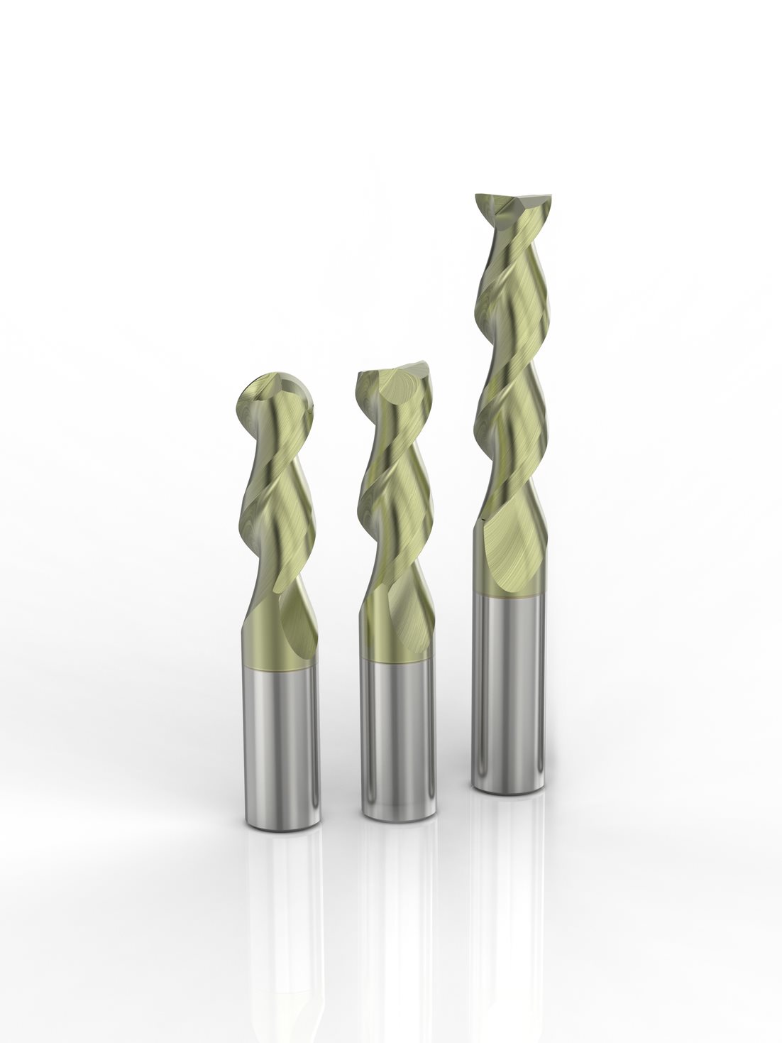

Make more aggressive cuts with geometries designed for ISO-N materials
Machining aluminum and other ISO-N materials efficiently requires tools that can handle aggressive speeds and feeds, even in less stable machining conditions. The existing A245/A345 product line addresses these issues with a cylindrical margin that minimizes chatter and vibration for superior surface finishes. Now, these products also feature a polished K-land that minimizes chip contact for superior chip formation. The helix, radial rake angle and flute shape have all been optimized. These advancements in technology allow for increased chip loads and sheer potential, resulting in a reduction in cutting forces and power requirements for truly exceptional MRR.
Your challenge:
Chatter, vibration and poor chip control lead to unstable processes and inconsistent performance.
Our solution:
Increase milling efficiency with a fully optimized geometry, including a newly engineered flute shape and K-land that minimizes chip contact during the chip formation process.
Keep gummy materials from slowing your ISO-N machining
ISO-N materials can be gummy, building up on the cutting edge of tools in a way that negatively impacts tool life, surface finish and process stability. To address this, the new ANF PVD coating developed by Niagara Cutter® creates a smoother and homogenous surface that minimizes friction and built-up edge. A substantial improvement over TiCN coating on the previous generation of A245/A345 end mills, the new ANF coating minimizes built-up edge for better surface finishes and longer tool life.
Your challenge:
Gummy ISO-N materials create built-up edge, resulting in reduced tool life and workpiece surface quality.
Our solution:
Maximize tool life and improve workpiece surface finish with the proprietary ANF PVD coating developed in-house by Niagara Cutter® to reduce built-up edge.
