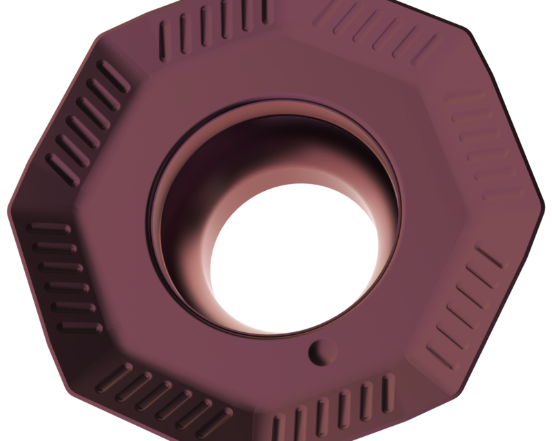

Facing mill tools like the Seco Octomill™ 06 Face Milling Cutter are purpose-built for this kind of work. With eight usable cutting edges, integrated wiper flats, and an insert pocket allowing fast tool changes, it’s a true productivity driver for any shop.
Did you know?
A 45° lead angle in face milling helps deflect cutting forces axially. It’s great for improving stability and tool life on wide surfaces.
