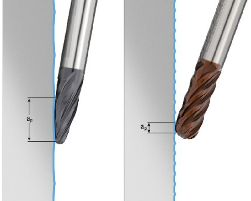

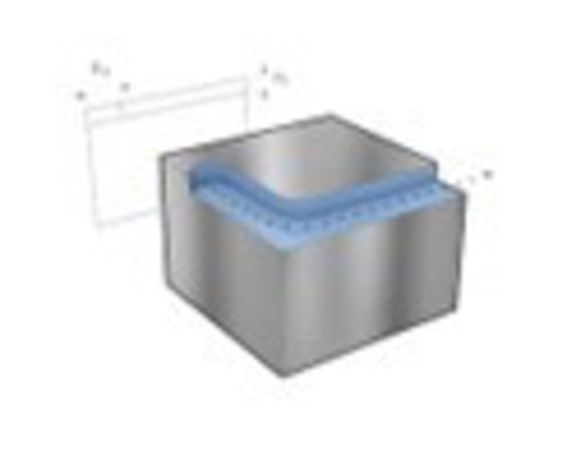

Axial Depth of Cut:
In milling, the “axial depth of cut” (ap) refers to the distance a tool engages the workpiece along its centerline. It determines how deeply the tool cuts into the material, affecting the efficiency and accuracy of the operation.
Radial Depth of Cut Slide:
The “radial depth of cut” (ae) in milling is the distance the tool steps over into the workpiece. It measures the depth of the tool along its radius as it cuts. The choice of radial depth of cut influences the tool engagement and the type of cut made, be it peripheral or slot cutting.

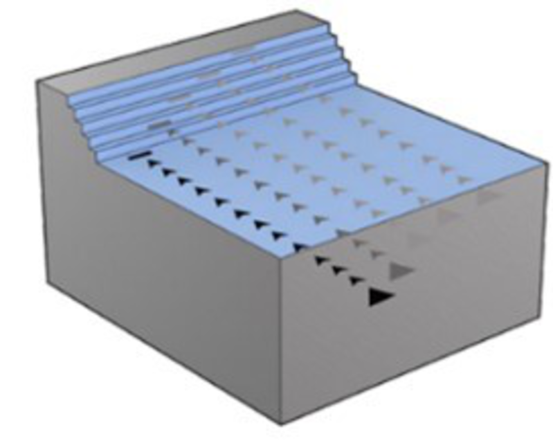

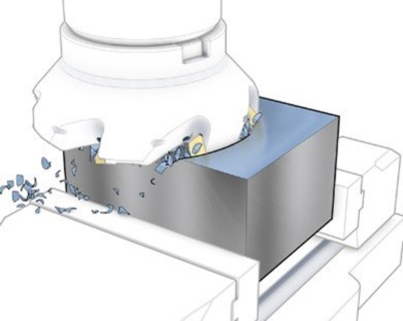

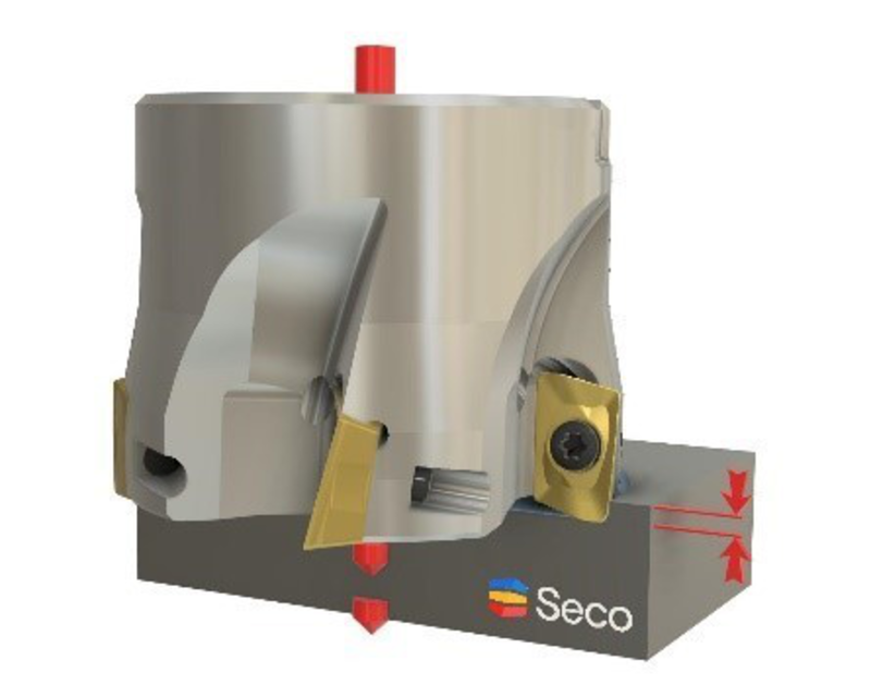

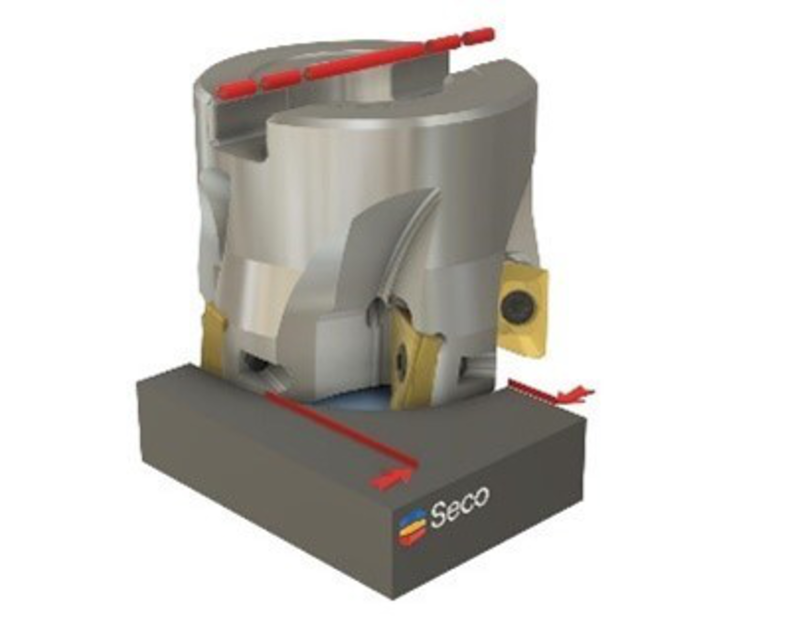

Face Milling: Creating Perfect Flat Surfaces
Face milling is a common operation used to create flat surfaces on a workpiece.
With milling tools equipped with multiple cutting edges, you can efficiently remove material in a single pass.
This process is vital for achieving plane surfaces, refining rough cuts, and getting high-quality finishes.
Manufacturers across industries love face milling for its versatility and precision, making it the ‘go-to’ choice for flawless results.

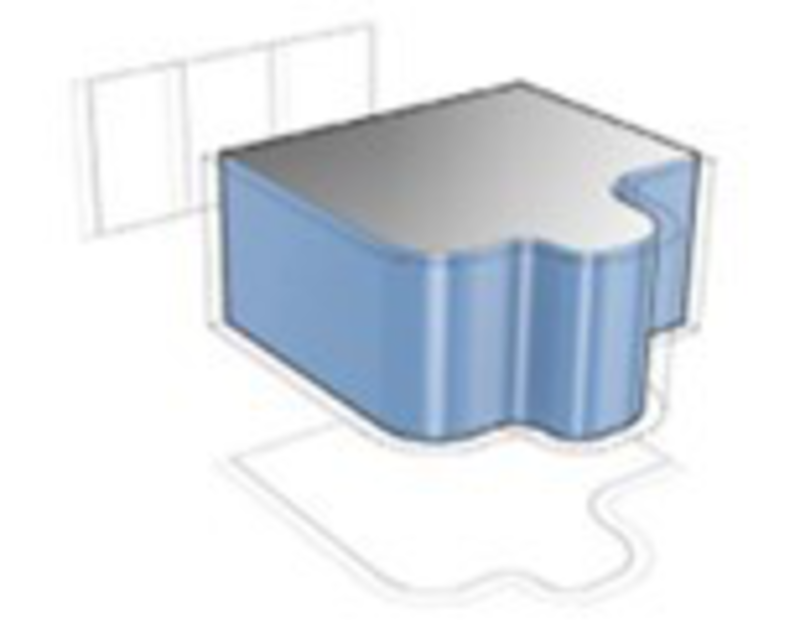

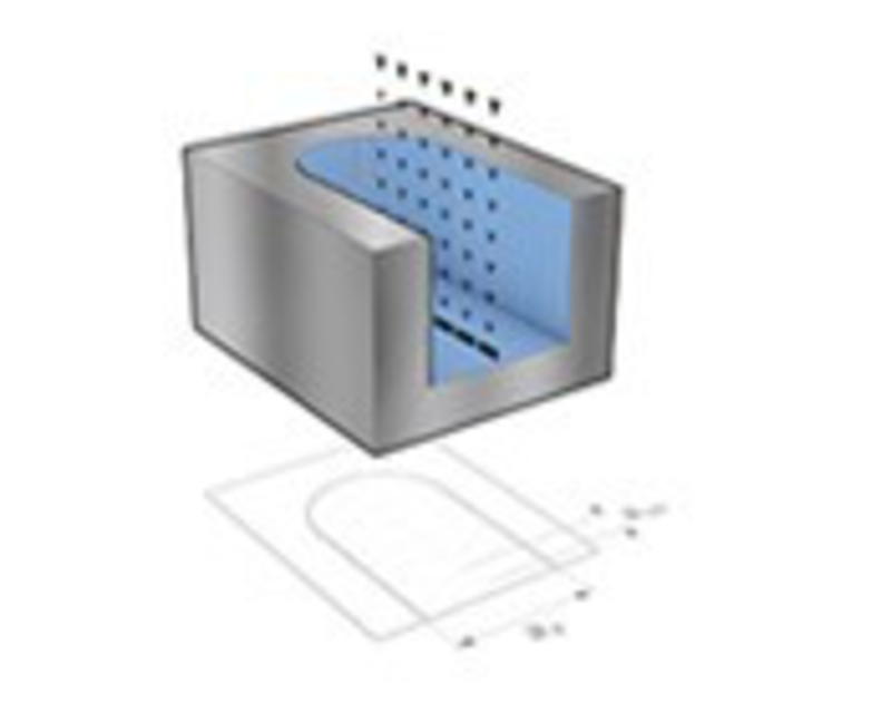

Side Milling: Beyond the Edges
In side milling (known as peripheral milling), the milling tool removes material from the outer edges of the workpiece.
This operation is perfect for contouring, profiling, and slotting.
Thanks to the tool’s multiple cutting edges, you can quickly remove material, making it ideal for roughing.
Industries benefit from the efficiency and reliability of peripheral milling, allowing them to craft intricate shapes and meet strict design specifications.

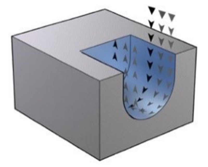

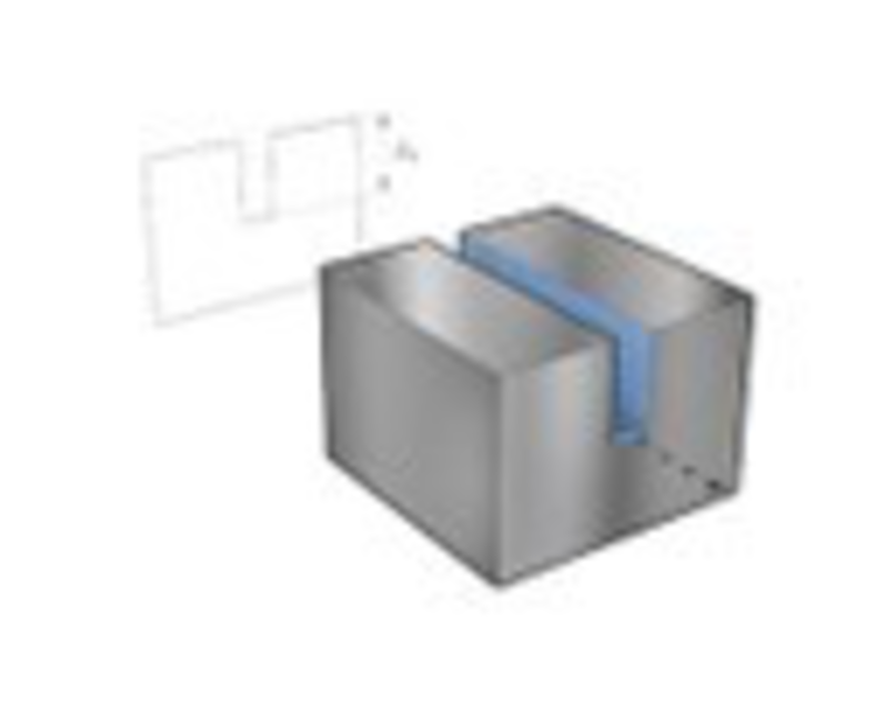

Slot Milling: Precision in Narrow Channels
Slot milling involves cutting narrow channels or slots into the workpiece.
The design of milling tools allows for precise slot milling due to their sharp cutting edges and stable construction.
This operation is widely used in manufacturing keyways, grooves, and other similar features.
Milling tools deliver exceptional performance in slot milling, ensuring industries achieve the precision necessary for critical components.

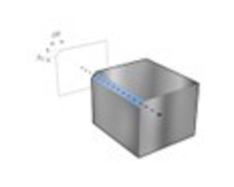

Chamfering and Beveling: Mastering Angles
Chamfering and beveling involve cutting angles on the edges of a workpiece.
Milling tools with specialized chamfering or beveling geometries accomplish these tasks accurately and efficiently, providing consistent edge finishes and ensuring precise dimensions.
Manufacturers can achieve impeccable bevels and chamfers, enhancing both aesthetics and functionality.

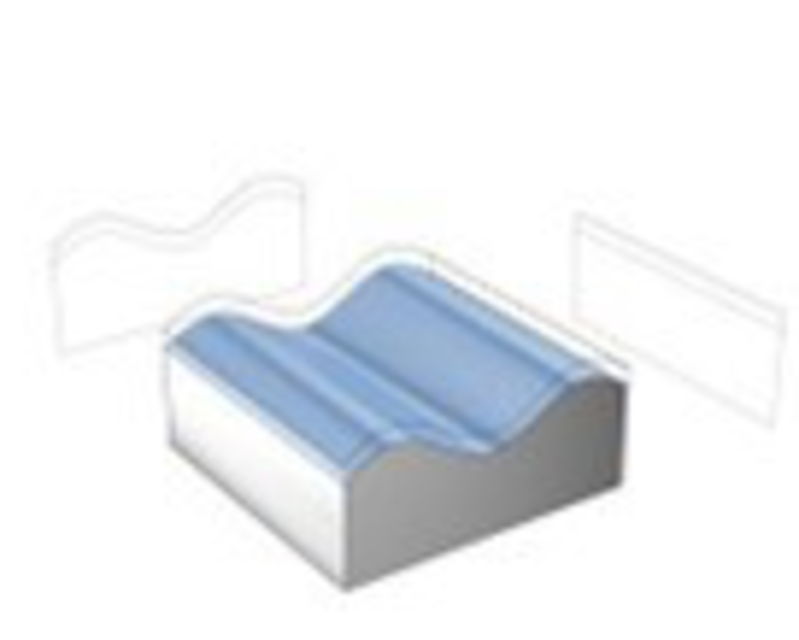

Copy Milling: Unleashing Your Creativity
Copy milling, also known as contouring, is a milling operation used to create complex shapes on the workpiece’s surface.
Milling tools with ball nose or corner radius designs are ideal for contouring, as they can smoothly follow the contours of the workpiece, producing intricate shapes with excellent surface finish and detail.
This operation allows manufacturers to unleash their creativity, delivering innovative and eye-catching designs.

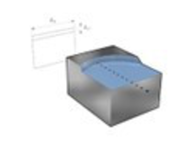

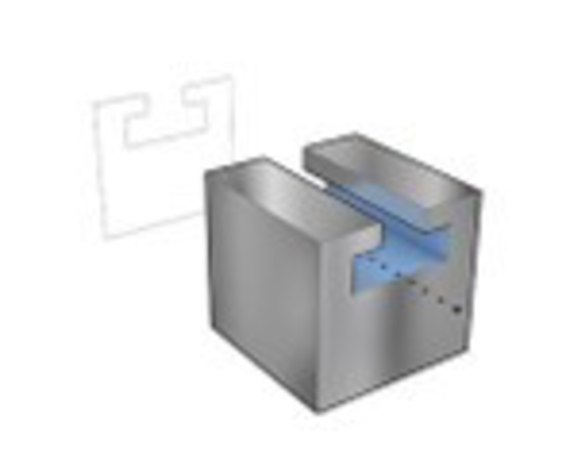

T-slot Milling: Creating Versatile Slots
T-slot milling is the operation of producing T-slots on the workpiece using a T-slot milling cutter.
This versatile process enables the creation of slots that can accommodate various fixtures and components, making it essential for many manufacturing applications.

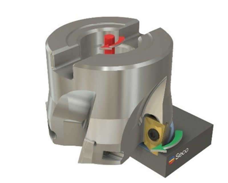

Plunge Milling: Diving into Perfection
Plunge milling is a technique where the milling tool is fed directly into the workpiece, creating pockets or cavities.
Milling tools excel in plunge milling due to their rigidity, reducing the risk of deflection and ensuring accurate results.
This operation is often used in roughing and finishing processes, providing manufacturers with the means to achieve intricate designs and perfect contours.

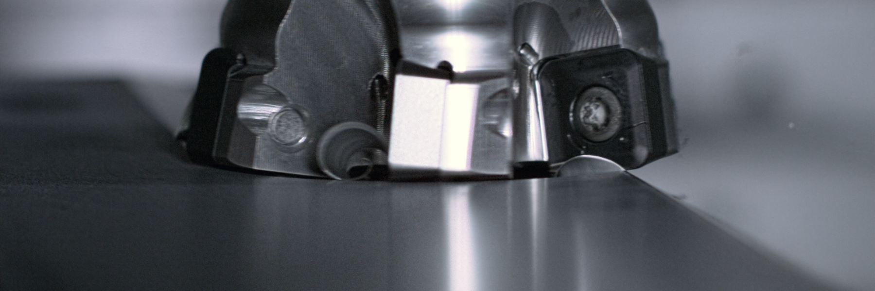

High-Feed Milling: Need for Speed and Productivity
High-feed milling allows significantly higher feed rates compared to conventional methods.
Specialized milling tools equipped with high-feed geometries are ideal for this process, rapidly evacuating chips and maximizing material removal rates.
As a beginner, adopting high-feed milling will help you accomplish quicker roughing operations and boost overall productivity.

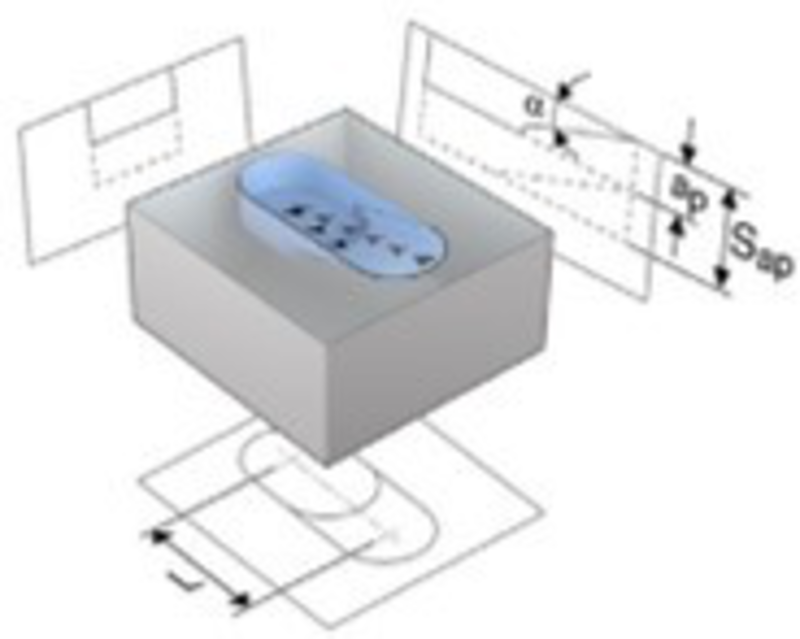

Ramping: Mesmerizing Two-Axis Ramping
Ramping in a linear motion emerges as the go-to method for approaching workpieces, especially when dealing with closed slots, pockets, and cavities.
This efficient approach eliminates the need for a drill, streamlining the machining process and maximizing productivity.
Ramping intertwines in a mesmerizing two-axis ramping dance by simultaneously feeding in the axial (Z) and one radial direction (X or Y).

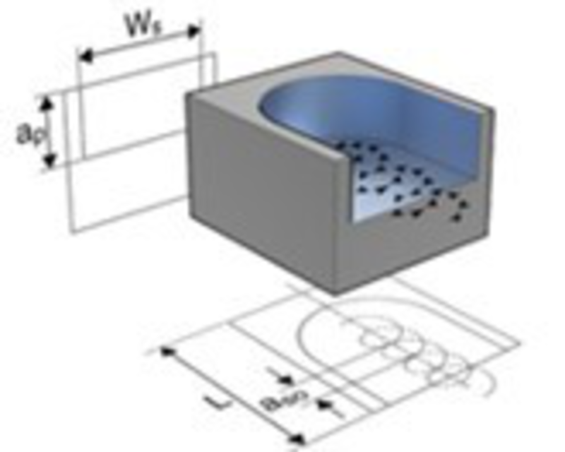

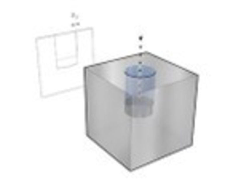

Circular interpolation: Seamless Circular Milling
Circular interpolation, specifically circular milling in a 2-axis approach, is a highly effective technique for machining large holes.
Usually, starting with a pre-drilled hole in the workpiece, we follow up with a square shoulder milling or a long-edged milling cutter.

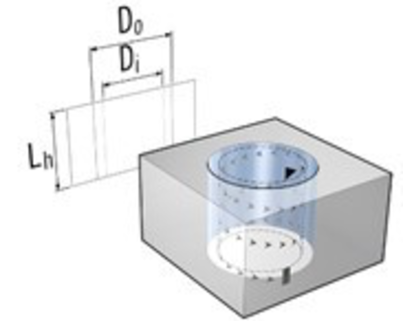

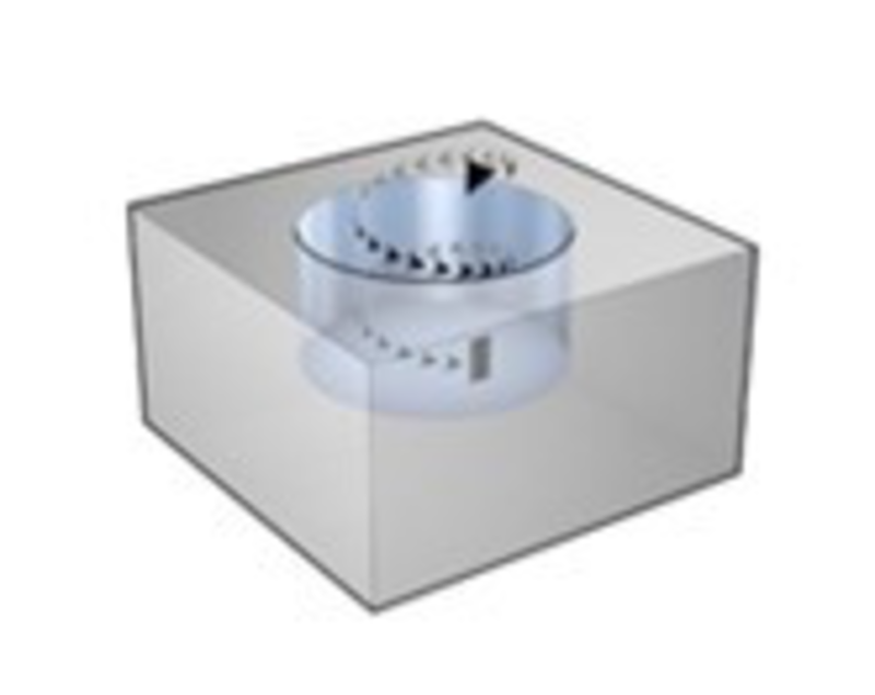

Helical interpolation: Elevating Machining Precision with Dynamic Interpolation.
Discover the art of, also known as circular ramping and spiral interpolation.
This advanced technique boasts simultaneous circular motion in the X and Y directions, perfectly synchronized with an axial feed in the Z direction at a defined pitch.
Embracing circular ramping offers an exceptional alternative to traditional drilling methods, empowering your machining endeavors with unparalleled efficiency and finesse.
Helical interpolation reigns supreme over linear ramping (full slotting) and circular interpolation for many reasons.

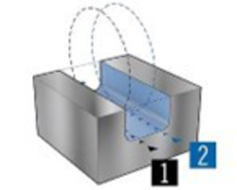

Trochoidal Milling: Optimize Efficiency and Reduce Wear
Trochoidal milling is a high-performance strategy that optimizes material removal using circular tool paths.
Milling tools with multiple cutting edges work wonders in trochoidal milling, reducing tool wear, cutting forces, and vibrations.
This technique leads to exceptional surface quality and extends tool life, making it a perfect choice for precise and efficient machining.

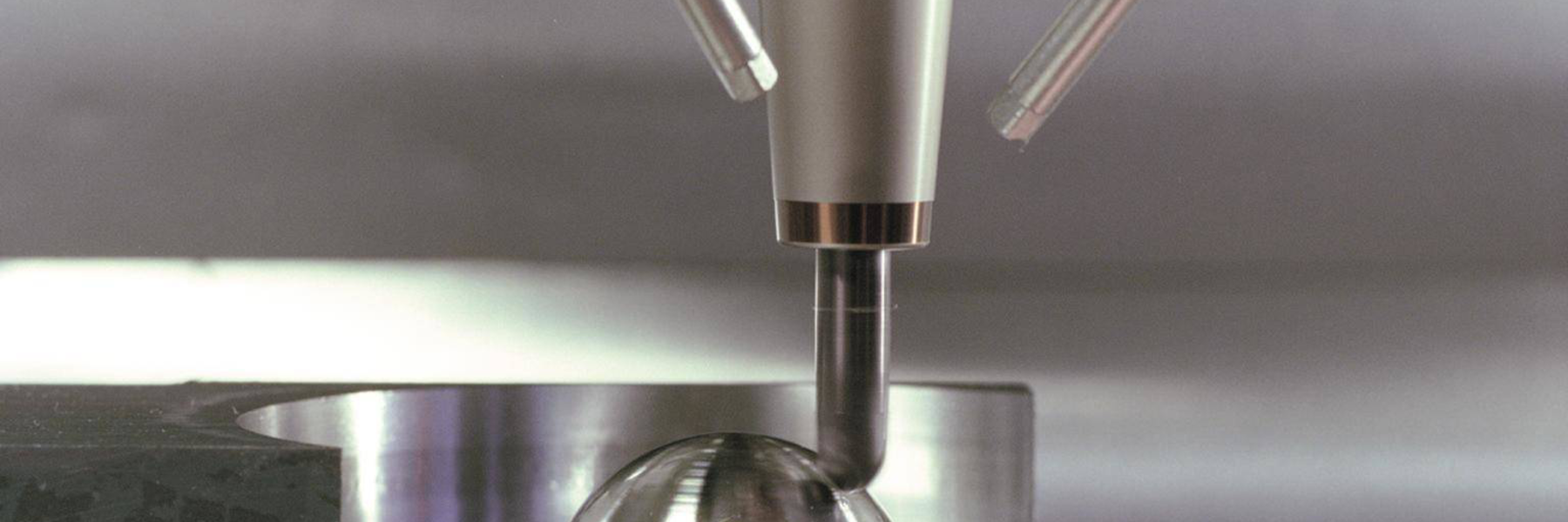

Barrel Milling: Achieve Unparalleled Efficiency with Barrel-Shaped Tools.
Barrel milling is a specialized machining process using barrel solid end mills and a 5-axis machine. With innovative circle-segment end mill geometries, you can finish parts up to 80% faster than conventional ball-nose end mills, as these circle-segment end mills have a unique contour with a considerably larger radius, allowing for increased step-over distance during finish milling.
Barrel end mills demonstrate exceptional proficiency in handling finishing and semi-finishing machining tasks for 3D surfaces with minimal stock removal. This is made possible by their unique toroidal cutting geometry, which enables them to operate at high feed rates, leveraging the chip thinning effect for enhanced efficiency.

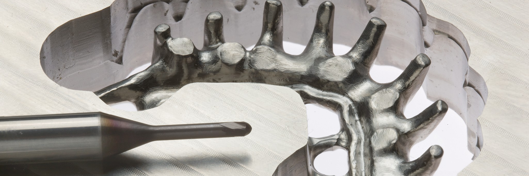

Micro Machining: Tiny Tools, Mighty Precision - Crafting Perfection!”
Micro-machining is the unsung hero of CNC, using tiny tool diameters (Ø 0.1 to 2.0 mm) for precision-critical applications. With meticulous craftsmanship, it creates intricate cavities in various materials. Precision and stability are crucial, requiring high spindle accuracy, RPM control, and thermal stability. From medical to electronics, micro machining plays a vital role in modern technology.
The tools used in this specialized strategy involve using incredibly small tool diameters ranging from Ø 0.1 to 2.0 mm. Despite their diminutive size, these tiny tools wield mighty precision, crafting intricate components with immaculate detail.
