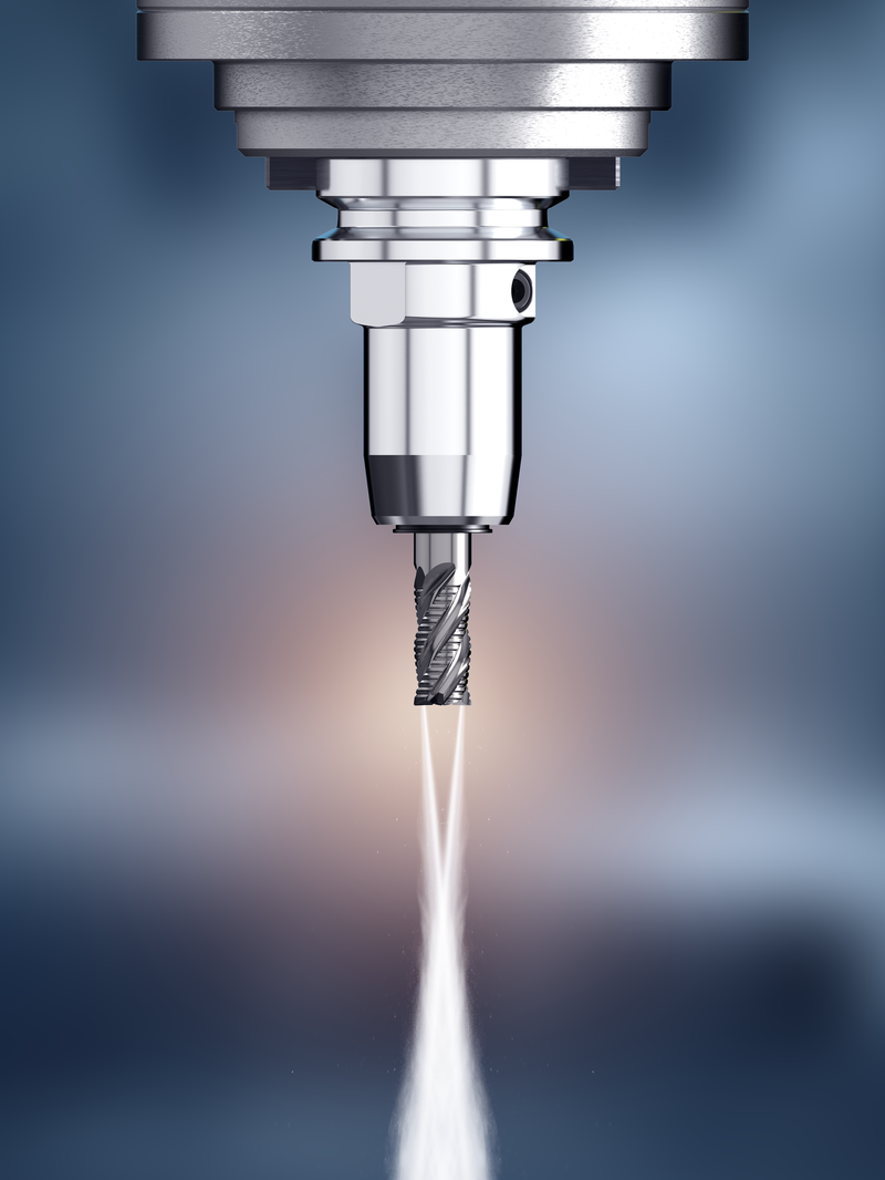

- Heat Dissipation:
![Hydraulic Chuck](https://prod-usercontent.azureedge.net/Content/UserContent/Images/034118.tif-ewcyegw4iuj.jpg)
Metal cutting generates substantial heat due to material deformation and removal. Cutting fluids help dissipate this heat, preventing the workpiece and cutting tool from overheating, which can lead to tool wear, reduced tool life, and workpiece deformation.

- High Pressure Directed Coolant (HPDC):
High Pressure Directed Coolant systems use specialized nozzles and high-pressure pumps to deliver cutting fluid at very high pressure directly to the cutting zone. This method is particularly effective for heavy-duty machining operations and materials that require superior cooling and chip evacuation.
