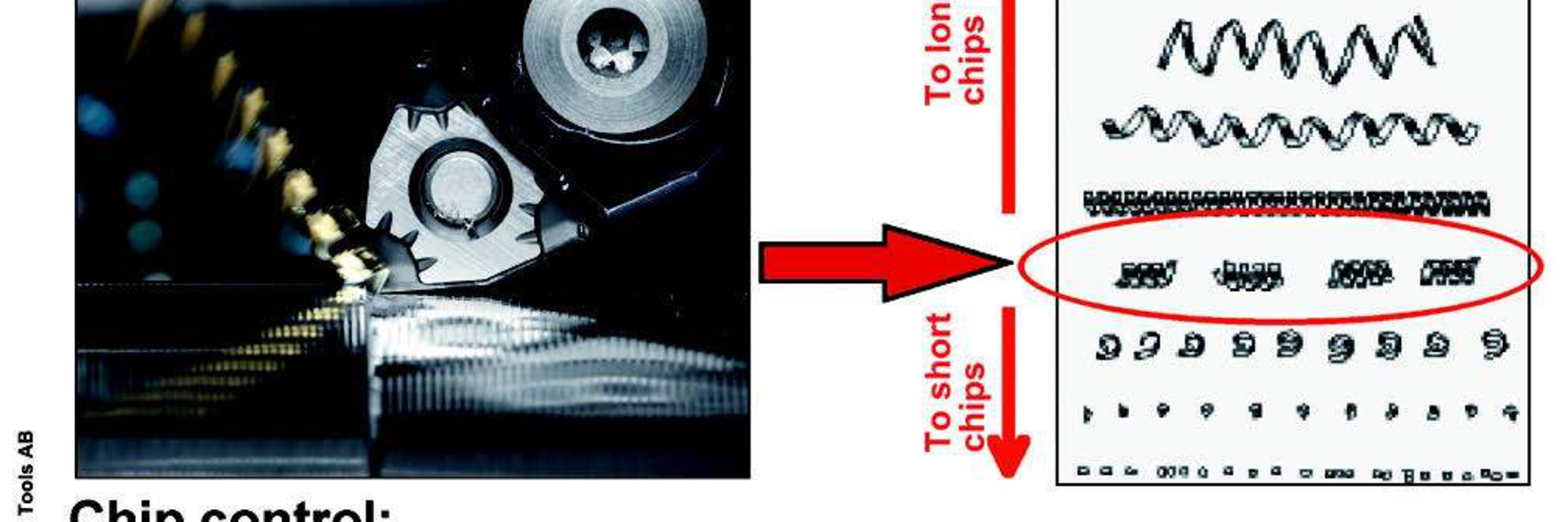

There are two basic types of ‘sintered-in’ insert geometries. The first is called a micro geometry or a micro sharp geometry and is very close to the cutting edge itself. The moment the chip is formed, it is bent, broken and removed by this geometry. These typical ‘F’ geometries produce short chips. The mechanical strength of such a cutting edge is rather limited – everything is concentrated on the cutting edge, increasing fragility. This requires that we limit depth of cut and feed with this type of geometry.
The other basic type of geometry is called a roughing geometry or ‘R’ geometry. The big advantage with a roughing geometry is that it makes the cutting edge stronger; a disadvantage is that we give the chip more liberty, producing longer chips.
The most interesting geometries are combinations of ‘F’ and ‘R’ geometries. At Seco, we call these combined geometries ‘M types’ e.g. the MF5 geometry. With these types of geometries we try to find the best possible combination of mechanical strength and good chip breaking capabilities.

There is an increasing demand for so called ‘wiper’ inserts. A wiper point offers the possibility to overcome this feed limit and apply higher feeds (at lower depth of cut) even on an insert with a smaller nose radius. This is important to remember if you are looking for maximum productivity. The feed can’t be too small, because the cutting edge itself won’t cut and the operation is reduced to a rubbing process. With some of the ‘F’ geometries we can go very low in feed because these cutting edges are specially developed to handle very low feed.
Another very important factor is the ratio between depth of cut and feed to achieve well-shaped chips, i.e. chips that are not too long, and not too short. The ratio of depth of cut to feed should also be within certain limits. Based on empirical measurements for long chipping materials, the ratio of depth of cut to feed should be somewhere between five and 15.
Normally, we consider an ideal ratio of depth of cut to feed to be somewhere around 10. For instance, if we have selected a feed of around 0.3 mm, the ideal would be to combine that with a depth of cut of 3 mm.

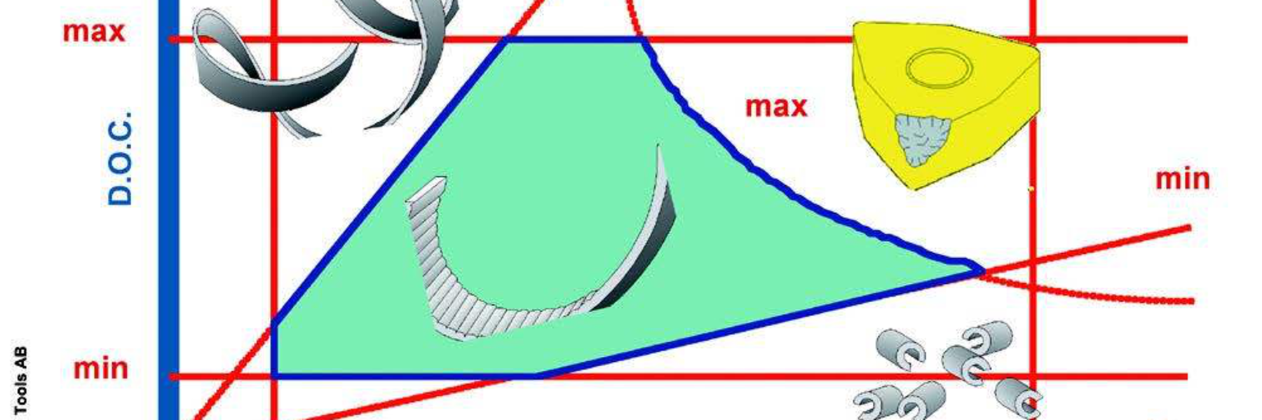

All of these considerations, when put together in one picture, are what most of our customers know as the chipbreaking diagram. Depth of cut not too high, not too low; feed not too high, not too low; the ratio of depth of cut and feed should be close to what is ideal for having the correct chip shapes and the product of the two should not be too high because otherwise we risk breaking the insert.
Looking at the chip breaking diagram, you can see directly how to solve chip breaking problems. If you are operating outside of these parameters, problems will occur. Of course there is much more to say about the impact of a geometry on a turning operation. The geometry of a cutting edge is the sum of the cutting edge geometry itself, the chip breaking geometry and nose geometry.

All practical limits together form the "chip breaking" area of an insert.
