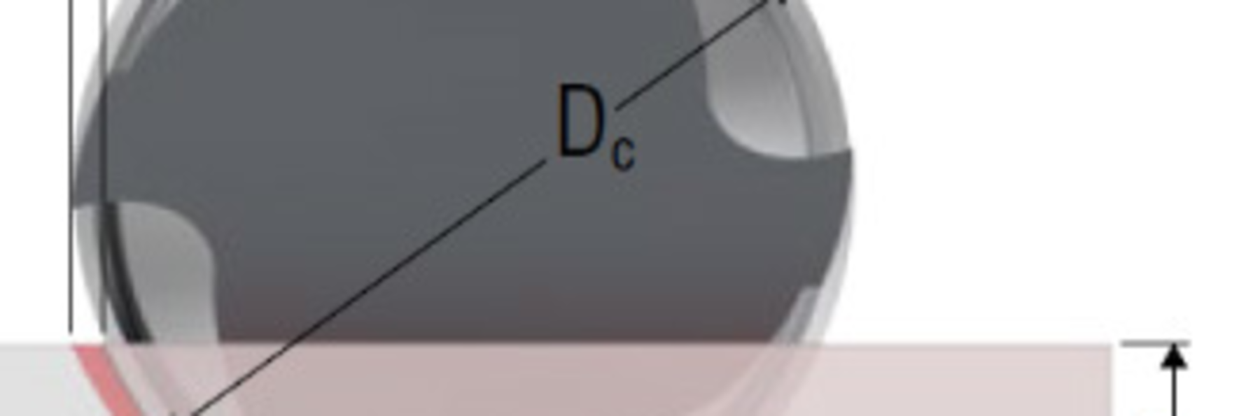

- Thinning the chip: By decreasing the tool radial engagement or stepover (a e ) to 42% (40° contact) or less. When less than half the tool diameter (Dc) is engaged in the cut, the average chip thickness (hm) decreases. This principle is also applied in the high-speed strategies, which were implemented globally in the early 1990’s and were particularly effective in hardenend steel machining. To achieve similar efficiencies compared to classical machining, the cutting speed needed an impulse. This was achieved by high speed spindles when 15-40.000 RPM spindles were introduced.

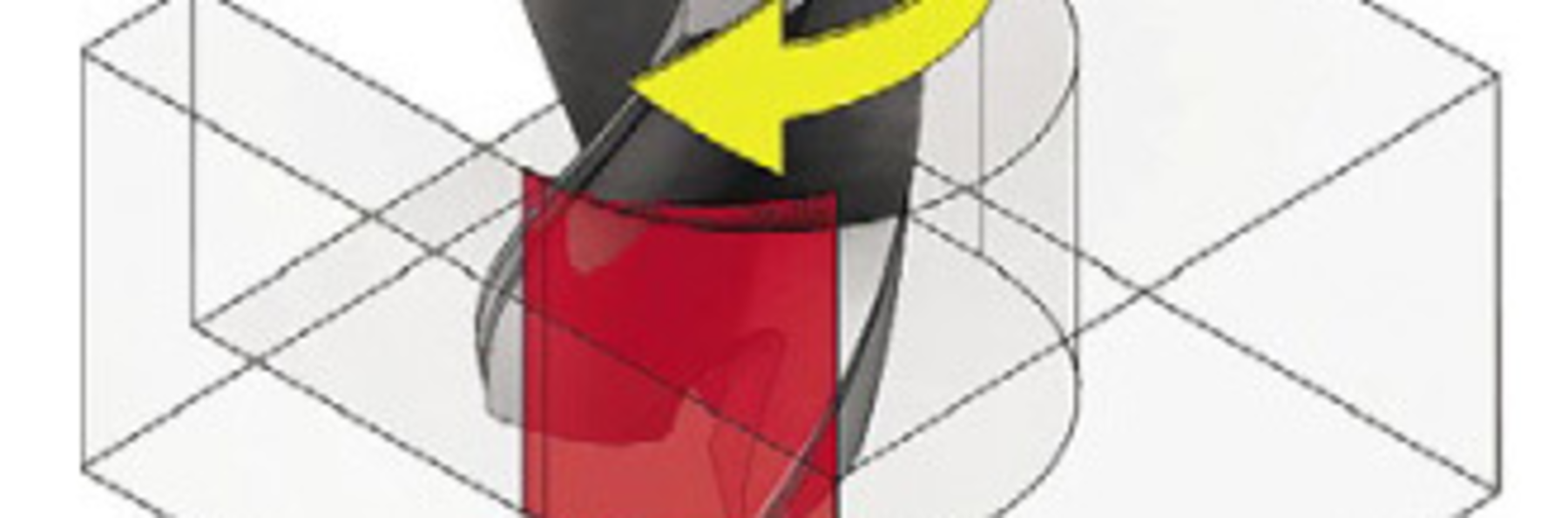

- Constant load: If chip load remains constant, the chip thinning is very effective and while adapting many other settings continuously the constant flow of material allows the process to be extremely reliable and efficient. The tool life of the cutting tool is also prolonged since the machining is constant and the thermal load is constant. It is important to manage heat removal, to avoid sudden and early tool failure. Material scientists have been aware of this theoretical possibility for over 50 years, but unfortunately technology was not up to speed. In the last 5 years, cam systems enabled the realization of these theories.
