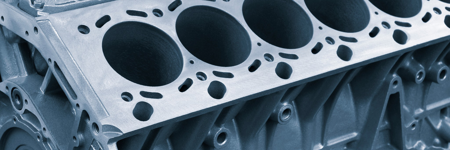

Truck Engine Block
Optimize engine-block production with combination tools and off-the-shelf inserts. Reduce part costs with less tooling. Meet specifications easily.Lead production to efficiency
Engine-block manufacturers face pressures from every direction. With every new engine design, they must invest in new CNC equipment and automation. When vehicle models change over, so must expensive customized equipment and tooling. Customers demand more productivity and lower per-part costs. At the same time, political factors reshape the production map – but leave engine suppliers with little access to component development and knowledge.
As new factories come online around the world, the competition for work and workers becomes more intense. With a shortage of skilled labor, many tools and tasks must accomplish more while they make work simpler for less-experienced operators. Every minute of cycle time saved, every tool or process eliminated, helps engine-block manufacturers stay competitive.

Castings vary in size and develop oxidation as they age. Heavy cutting interruptions can cause drag marks that damage surface finishes. Smaller milling cutters can produce cutting marks as they overlap on large part surfaces. Long reamers can sag, losing alignment and concentricity. Features with multiple chamfers require special toolholders and cutters to reach and machine them. Spindle tilting to overcome non-center cutting tools makes specific contours difficult to create.
