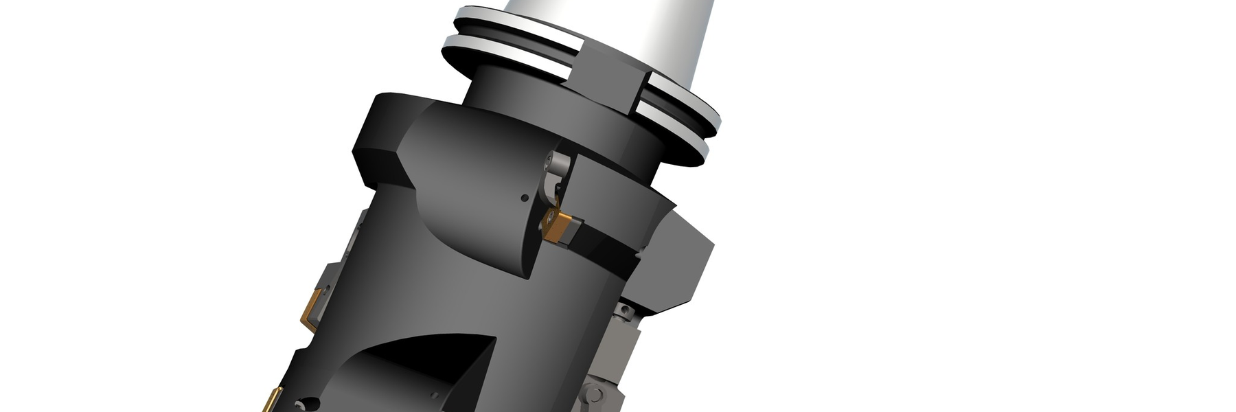

| Our proven Solution: | Custom multi-step boring bar that roughs, semi-finishes and chamfers. The grooving tool uses double sided ISO / ANSI inserts. The illustrated special boring tool performs a rough and semi-finish bore for the bearing seat and chamfers its lead edge all in one motion. The special groove cutter mounted at the end of the boring head is designed to interpolate a retaining ring groove in the bearing bore once the finish bore tool clears the part upon retraction. |
