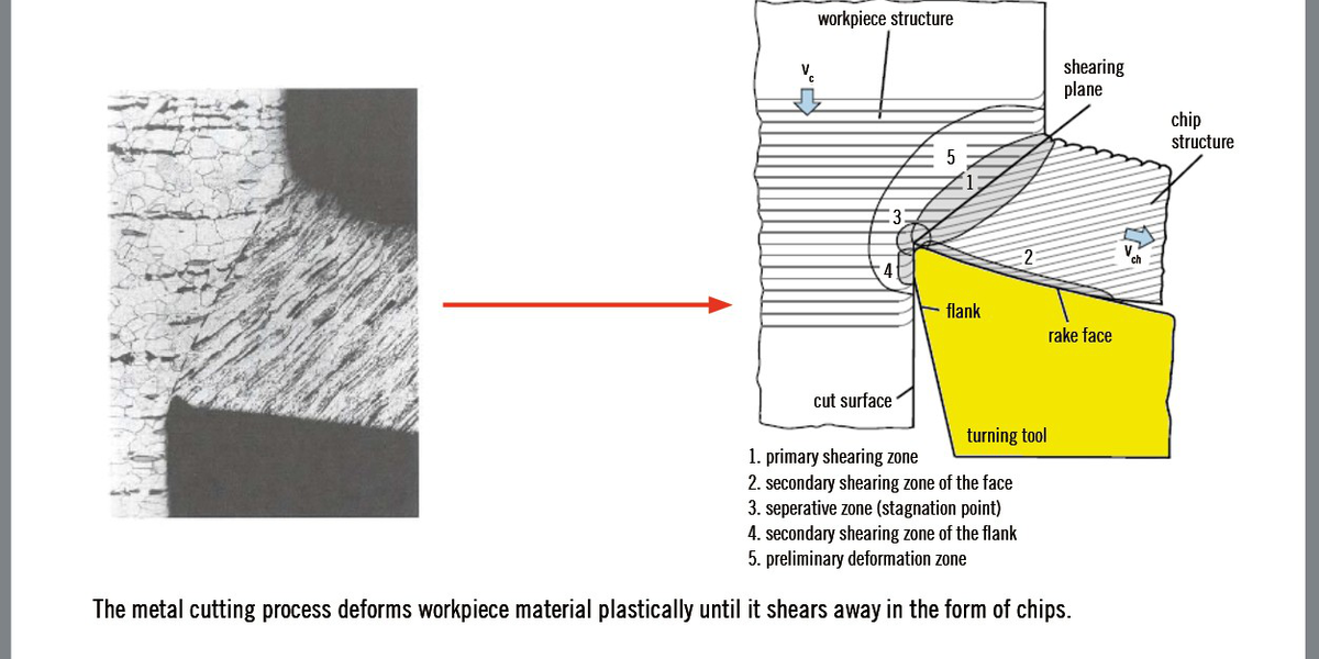

Tribological research has determined that the cutting process does not simply involve a single shearing event and subsequent disconnection of chip and tool. In fact, secondary and tertiary connections and disconnections also occur. The chip shears away, adheres to the rake face and then shears away again before finally sliding off the tool. The main wear mechanism is repeated shearing, not friction.
Figures 1 and 2 illustrate the metalcutting process as described via tribology. Figure 1 shows preliminary deformation of the workpiece material in Zone 5. Zone 3 is the separation zone, also called the stagnation point, because the relative movement of the workpiece material and tool at that area is essentially zero. Initial shearing takes place in Primary Shearing Zone 1, where the material shears off and the chip forms. Then, in Secondary Shearing Zone 2, the chip is in contact with the rake face. The high pressures cause the chip to adhere to the rake face of the tool.

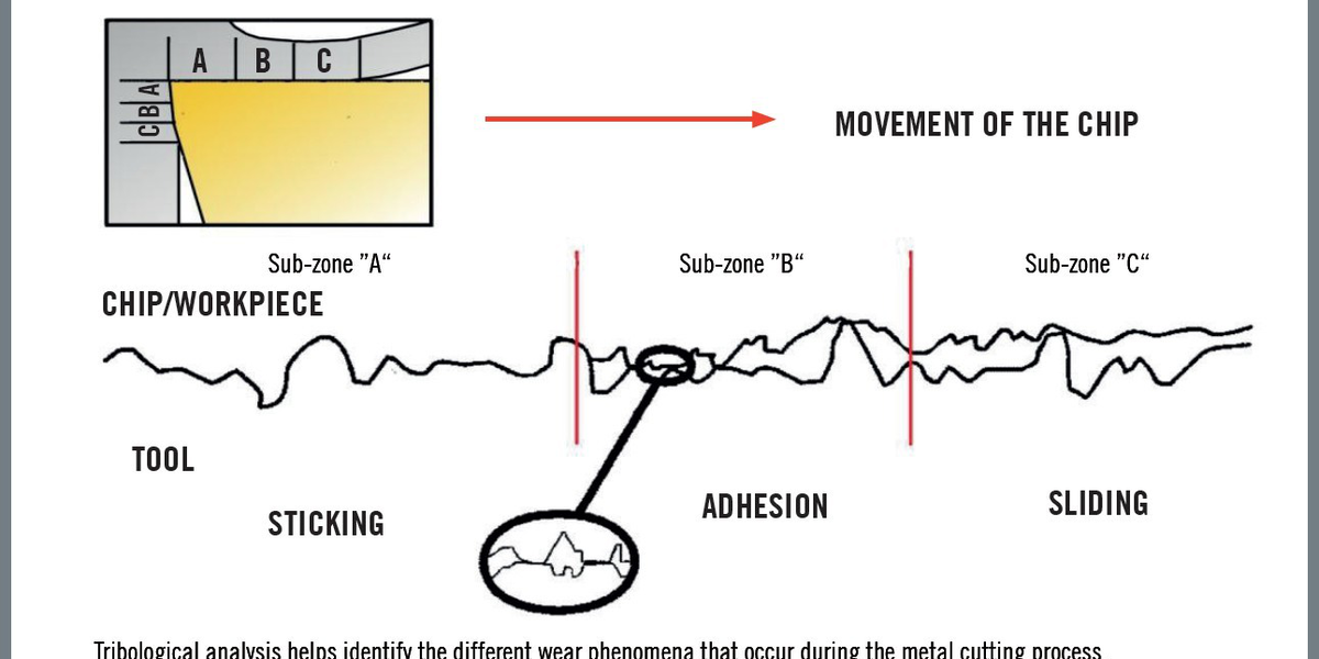

Figure 2 provides a closer look at the action in Zone 2. In Zone A, the workpiece material presses against the cutting edge with extreme force and begins to stick to the tool. In Zone B, the material adheres to the rake face. In Zone C, the chip shears away from the rake face and slides across it, ending contact between it and the tool.
Figure 1 also shows secondary shearing on the tool flank in Zone 4. The same shearing and adhering sequence that occurs in Zone 2 on the rake face also happens on the flank. The events in Zone 4 produce flank wear, which is more predictable than the rake face wear in Zone 2 and is relatively harmless. In some workpiece materials, however, shearing on the flank face results in surface hardening or work hardening that has a detrimental effect on the cutting tool and workpiece.

Two aspects of the cutting process contribute to attachment of the chip to the rake face. One factor is the very high pressures and temperatures that exist in the cutting zone. The other factor is the relatively slow speed of the chip across the tool rake face, beginning with zero motion at the stagnation point. When two materials are in contact with each other under high pressure and temperature, and move slowly, the conditions are prime for them to adhere to one another and for built-up edge to form.
Minimising adherence and the chances for forming built-up edge involves reducing the contact time between the chip and the rake face. The most straightforward solution is to increase the cutting speed and apply a sharper tool. Faster cutting speeds reduce the time the tool and workpiece material are in contact with each other. The resulting higher process temperatures can also reduce the strength of any edge buildup or eliminate it entirely. The sharper tool has a higher approach angle that forces the chip to travel a longer distance over a set period of time, i.e. move more quickly.
