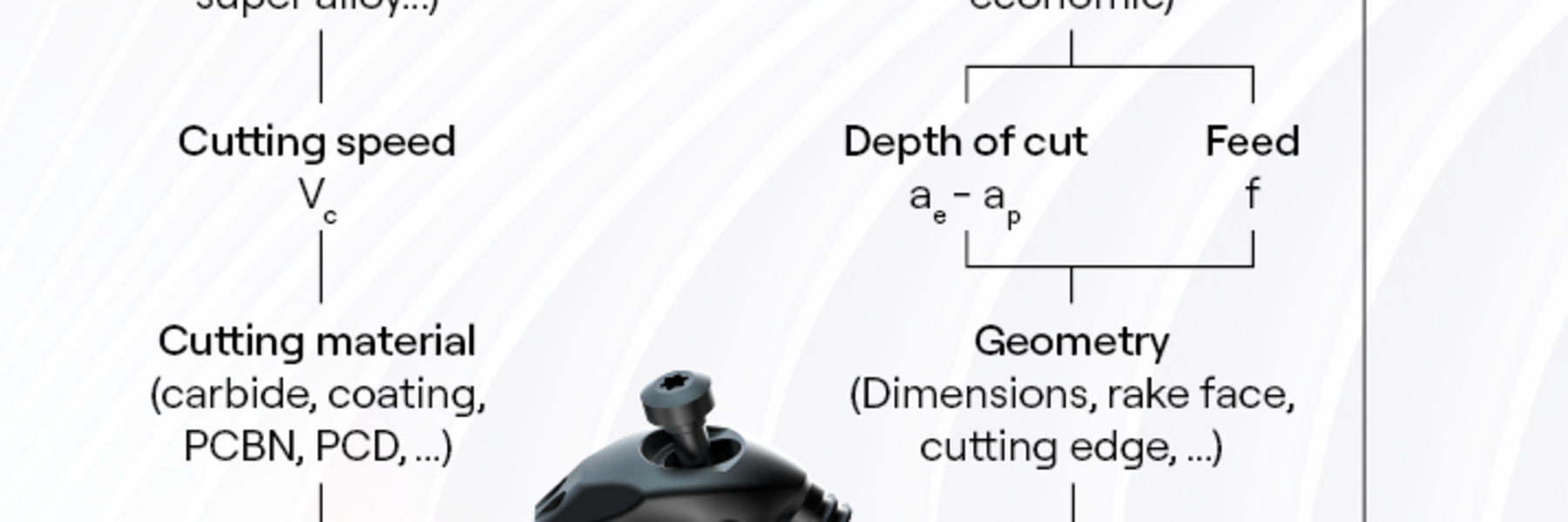

The selection of cutting tools is based primarily on the workpiece material that needs to be machined. But workpiece material properties and cutting tools features need to work together. The two must have a connection, and that is defined by cutting conditions such as speeds, feeds, and depths of cut. Cutting speed is the connection between workpiece material and cutting material, while depths of cut and feeds connect tool geometry with the application type and to some also extend the workpiece material.

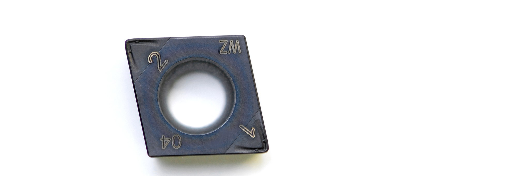

The other elements of geometry are the rake face, cutting point, clearance face and transition (T)-land. The rake face positioning geometry is one of the two plains that cross to form the cutting-edge line. It is the part of the tool where the chip, as it is formed, will glide over, and be evacuated, while the cutting point type, position and geometry is where the main cutting edge ends in the operation – on the level of the machined surface essentially. The clearance face position geometry is the second of the two plains that cross to form the cutting-edge line. The clearance face position serves a dual purpose: making the penetration of the cutting edge in the workpiece materials possible and offer stability to the cutting edge.
In between the rake face and cutting-edge line is the T-land. On PCBN and ceramics tools, the proper T-land geometry can be the difference between success and failure. Using inserts made from those cutting materials but combined with the wrong T-land geometry will destroy the tool in a matter of seconds.

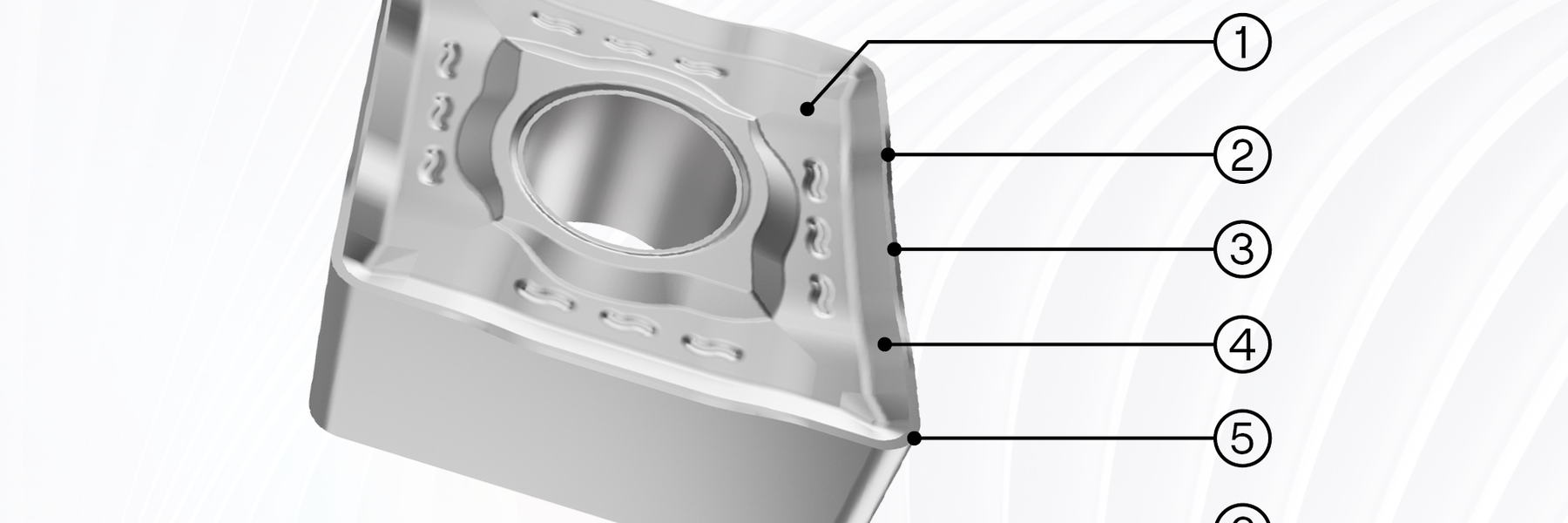

Geometry features with purposes
Each feature of a tool geometry serves a purpose, whether for tool life, chip control or edge stability. These features include the shape and dimensions of an insert; the cutting-edge length; primary and secondary cutting edges; the position and geometry of the cutting point; the edge line, rake and clearance face position; cutting edge angle; rake face geometry; and micro cutting-edge geometry.
- Global Shape and dimensions of cutting edge carrier
- Cutting edge line type and position
- Cutting edge geometry
- Rake face position
- Cutting point type and geometry
- Clearance face position geometry
- The global shape of an insert as it is defined by its rake face, clearance face and point have a big impact on the strength of a tool. The larger the point angle of the cutting tool, the higher the tool’s overall resistance to breakage.
- The length of the cutting edge determines the maximum depth of cut the tool can handle.
- The primary cutting edge of a cutting tool performs the actual machining. That edge ends at the cutting point, and when it extends beyond that, it is referred to as the secondary cutting edge – also called the scraper or wiper cutting edge. The secondary cutting edge along with point geometry and feeds significantly influence workpiece surface finish quality.
- The strength of the cutting point enables higher cutting conditions. Stronger points allow for bigger depths of cut and higher feeds.
- Edge line, rake and clearance face position give a cutting-edge line its positioning. This is called the inclination angle (or helix angle), and it encompasses how the cutting-edge angle is orientated as compared to the cutting direction. This geometrical element is used to influence chip formation – for reliability of the process – and cutting pressure – for tool life.
- The cutting-edge angle also defines how cutting edges are positioned. The lead angle or cutting-edge angle is the positioning of a cutting edge compared to the feed used with the tool.
- The rake face geometry influences how chips are formed and evacuated. In this respect, there are sharp, medium, and strong geometries, which refer to the application. A fine or sharp geometry is for finishing, medium geometry for the average operation and a strong geometry is for roughing applications.
- The micro cutting-edge geometry is very small, and changes during machining due to wear appearing on the cutting-edge line.
