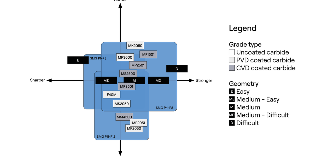

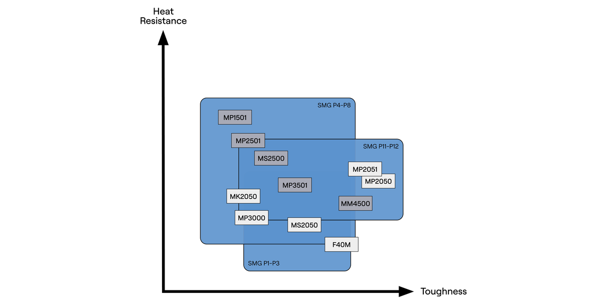

Mapping of Steel milling grades
Discover our Product Range
Get to know our grades for Steel milling
