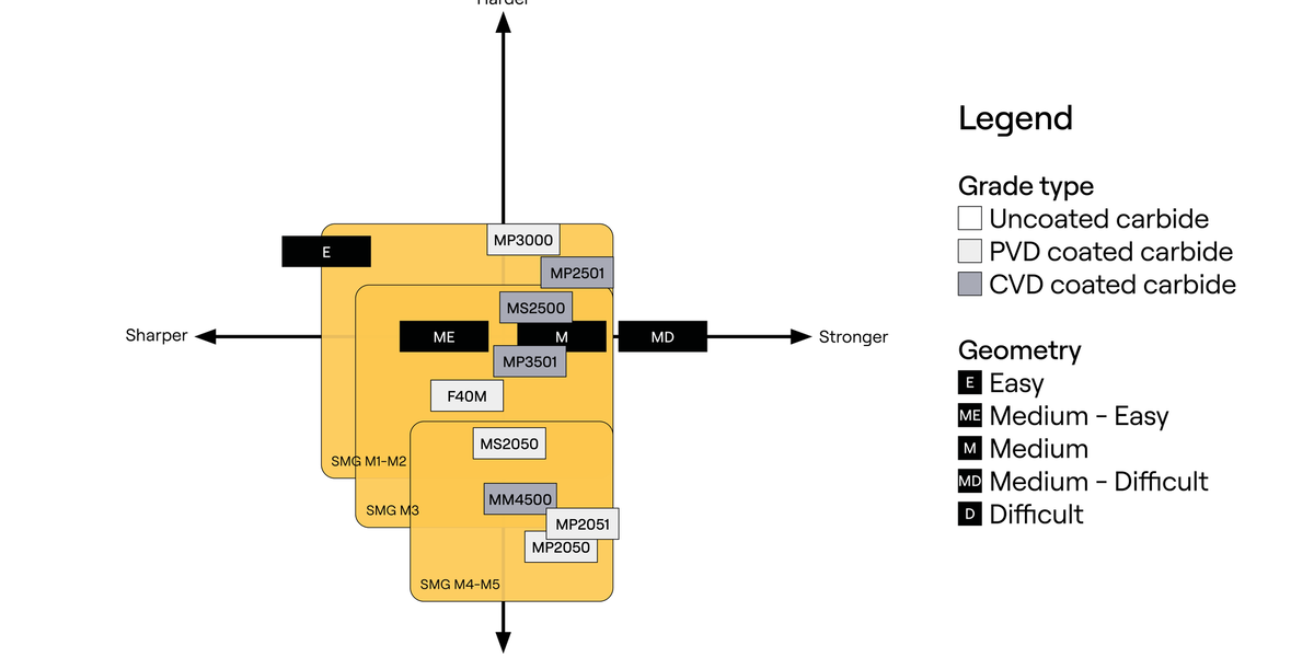

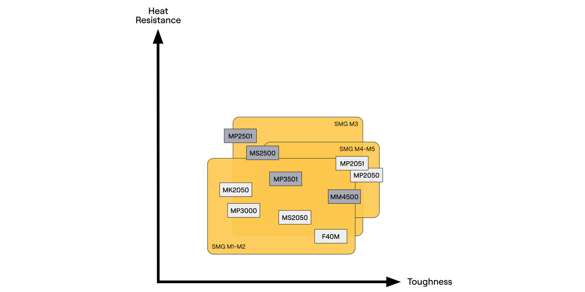

A mapping of Stainless Steel Milling grades and how to select the right one.Material grouping and Grades references for Stainless Steel
SMG M (Stainless Steel) is divided in 5 sub-groups, to capture specific material characteristics and reduce the complexity of every specific material.
Based on grade portfolio, first and second choices are provided for each sub-groups. This is a starting grade recommendation which can be optimized depending on the application, based on below mentioned grade mapping.

Mapping of Stainless Steel Milling grades
