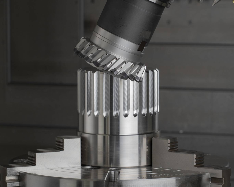

It is a gear manufacturing process, which with a dedicated solution is applicable both on internal and external gearing. Skiving - especially as regards the solution with an interchangeable solid carbide head - allows the finishing of the tooth profile, and today it can be performed not only with the latest generation CNC gear cutting machines but also with multi-tasking machines or modern machining centres .

To get a rough idea of the operating principle, you can imagine combining the gear hobbing with gear shaping. The skiving cutter can be associated to a process with a multi thread gear hob; by extremizing the number of threads of the gear hob, so that each principle corresponds to a cutting tooth, you will obtain a skiving tool.
Unlike gear hobbing, the skiving process however creates an irregular distribution of the chips with a negative rake angle at the exit of the tool tip; for this reason, a multi-pass approach is required in skiving.
