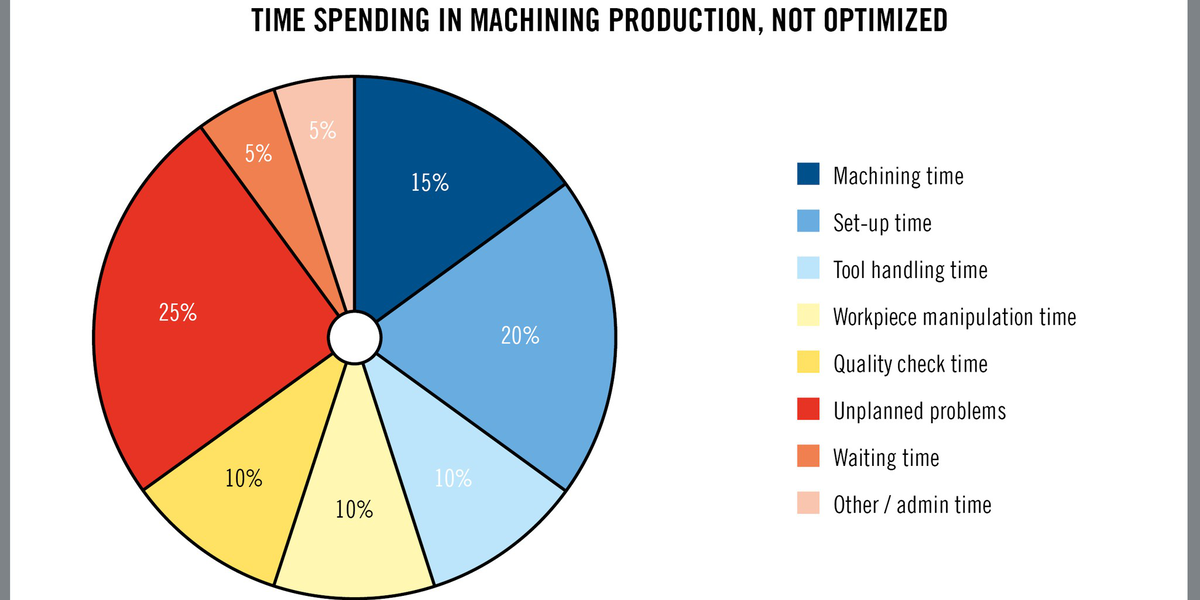

Competitive pressures prompt manufacturers to perform cost-reduction analyses. The analyses include examination of spending for materials, tooling and machining time. Seeking out and eliminating the many instances of lost time offers significant opportunities for controlling costs (see figure 1). Methods used in cost analyses include OEE and Lean programs. Such analyses, however, often are based on a view of the manufacturing process as a kind of self-contained, simple box. A shop puts raw material or a semi-finished product into the box, machining processes occur, then a certain number of workpieces exit the box, either as finished products or as semi-finished workpieces destined for another box.
