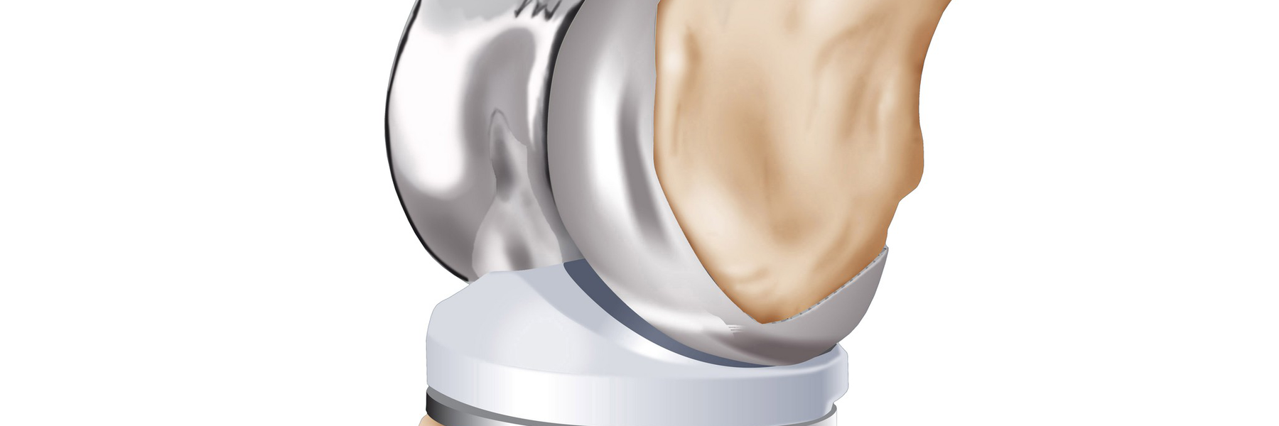

Typical components
| Figure 1: Complete Knee Components |
Orthopaedic devices include hip and knee replacement components, artificial elbow and ankle joints, trauma repair instruments, spinal bone plates and various repair pins, rods and fasteners. Joint reconstruction makes up over 40 percent of the market, with the majority of that in hip and knee replacement. The key requirements for these parts are strength, reliability, light weight and biocompatibility.

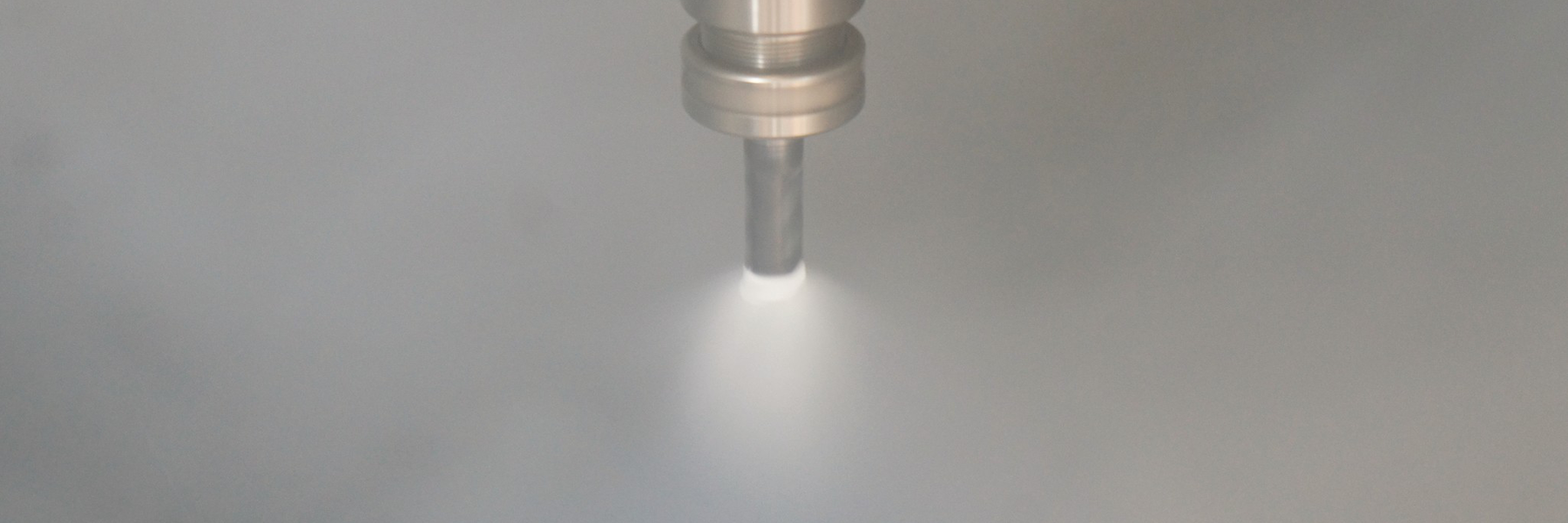

Because machining the materials used in orthopedic implants typically generates excessive heat, use of coolant is required. However, in many cases use of traditional coolants is either prohibited extremely limited to prevent contamination of the parts. Otherwise, time-consuming and expensive post-machining cleaning processes are needed. In addition, coolant itself poses environmental issues in regard to employee health and safety and disposal policies. An alternative coolant technology involves the use of super-critical carbon dioxide (scCo2) dry-cutting technology. this supercritical Co2 acts as a vehicle to deliver dry and enhanced lubrication to a cutting zone.
Developed by Fusion Coolant Systems, the process provides the capability to machine parts without oils, emulsions or synthetics. When carbon dioxide is pressurized above 74 bar (1,070 psi) and 31° C, it becomes a supercritical fluid. In this state, it fills a container like a gas, but with a density similar to a liquid. When delivered to the cutting zone, scCO2 expands to form dry ice, though it does not create a cryogenic substance like liquid nitrogen. The end result is an incredibly effective coolant solution that often outperforms existing systems that incorporate high pressure water/oil, minimum quantity lubrication (MQL), liquid CO2 and liquid nitrogen.

A total knee replacement typically consists of three basic components: A contoured metal (cobalt chrome or titanium) element called the femoral component is attached to the knee end of the femur, the large upper leg bone. A metal component called the tibial tray is affixed to the top of the tibia bone of the lower leg and consists of a short shaft or keel that supports a flat surface with raised edges. A plastic bearing insert between the metal parts permits motion of the joint.

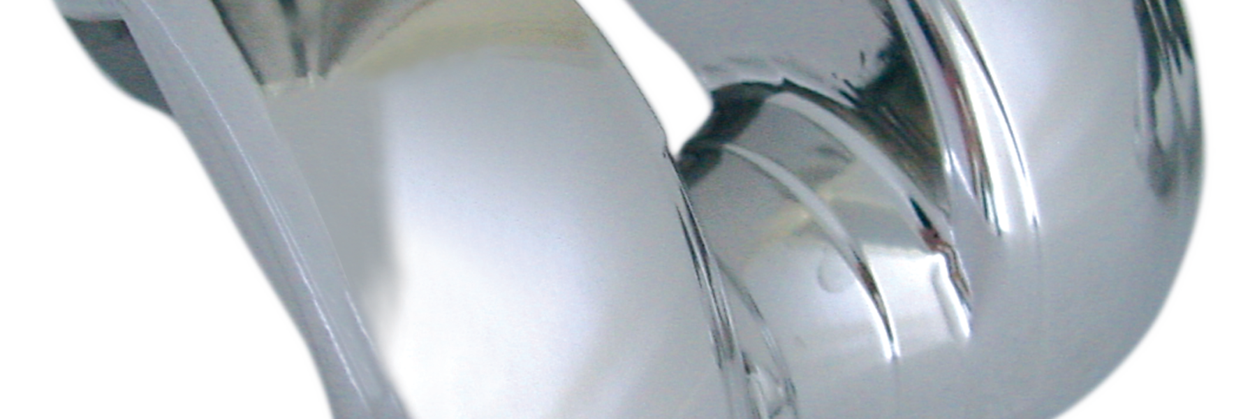

The metal alloy components of orthopedic implants must possess excellent surface finishes to minimize wear of any plastic parts and permit the joint to function for its projected lifetime of 20 years or more. In a knee replacement, for example, both the femoral component and tibial tray must be absolutely smooth to protect the plastic bearing insert against wear.
Accordingly, manufacture of orthopaedic components typically requires that grinding operations follow the milling process in order to achieve a sufficiently fine finish. Grinding, however, is time consuming and impact overall manufacturing efficiency and flexibility. Equally important, grinding generates high temperatures and stress in the ground components, leading to component dimensional errors and affect the product’s strength and performance.
Grinding can be supported or in some cases replaced with the application of advanced cutting tools and high-speed milling strategies. The goal of the milling operations is to achieve a burr-free outside profile and a superior surface finish that offers the exact required surface quality, integrity and dimensional accuracy. If there is a post treatment such as polishing, the time for that task can be minimized because of the defined surface roughness and structure achieved in the milling process. On the tooling side, parallel goals are long, reliable tool life and maximum productivity.
In a representative application, a cast cobalt-chrome femoral component was finished using a ball-nose end mill on a 5-axis milling machine. High-speed copy milling strategies and use of a high-performance end mill enabled elimination of a grinding operation. The resulting cycle time of 11 minutes per part represented a 50 percent time reduction compared to prior method. The change from grinding to milling the condyle surface eliminated the generation of scrap parts. The solid-carbide end mills employed featured a dedicated tough solid-carbide grade and a hard, polished TiAlSiN coating and were engineered to provide high metal removal rates and smooth cutting action to achieve superior finish and minimize polishing time.
