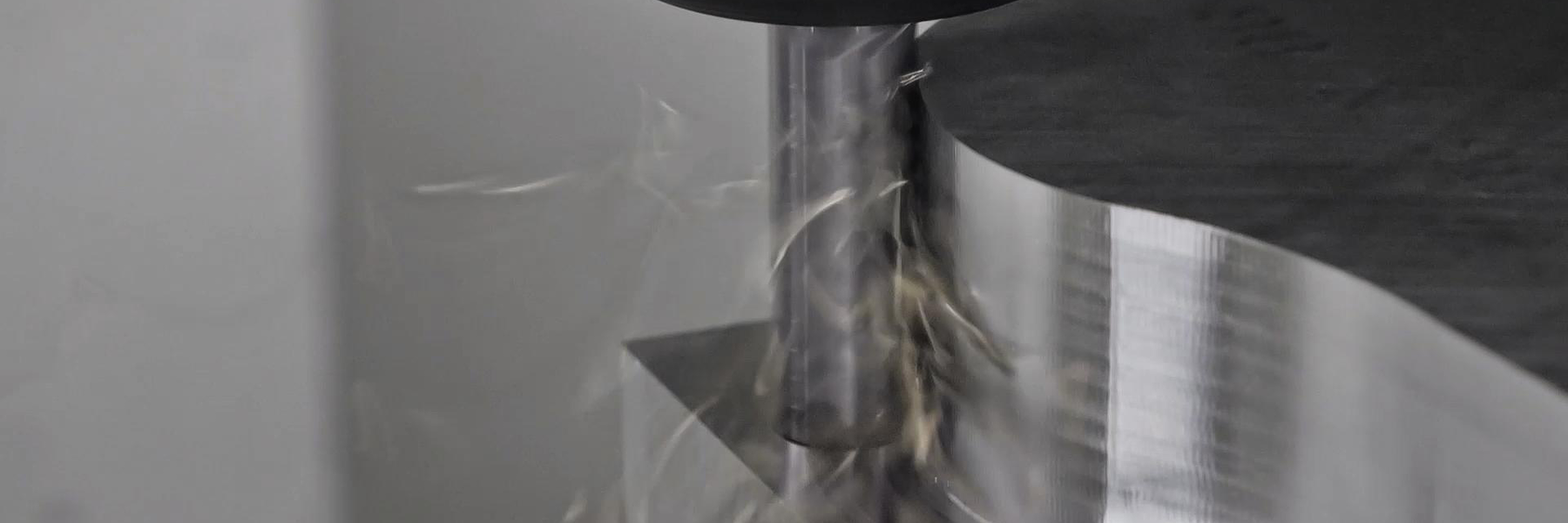

Dynamic Milling, on the other hand, hinges on maintaining a constant angle of engagement (AOE) or arc of contact (AOC) with the tool. Changes in an end mill's AOC with a workpiece affect the tool, workpiece itself and the machine tool. To extend tool life and produce better parts, Dynamic Milling ensures a consistent AOC between end mill and workpiece, along with sustainable speeds and feeds.
The strategy uses solid carbide multi-flute end mills with a cutting path program that involves large depths of cuts – often the full length of the flute – and shallower radial stepovers while maintaining a constant AOC. Greater AOCs increase the load on the tool as well as the machine and generate more friction and heat, which compromises tool life and surface finish.

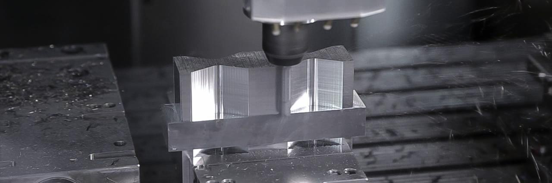

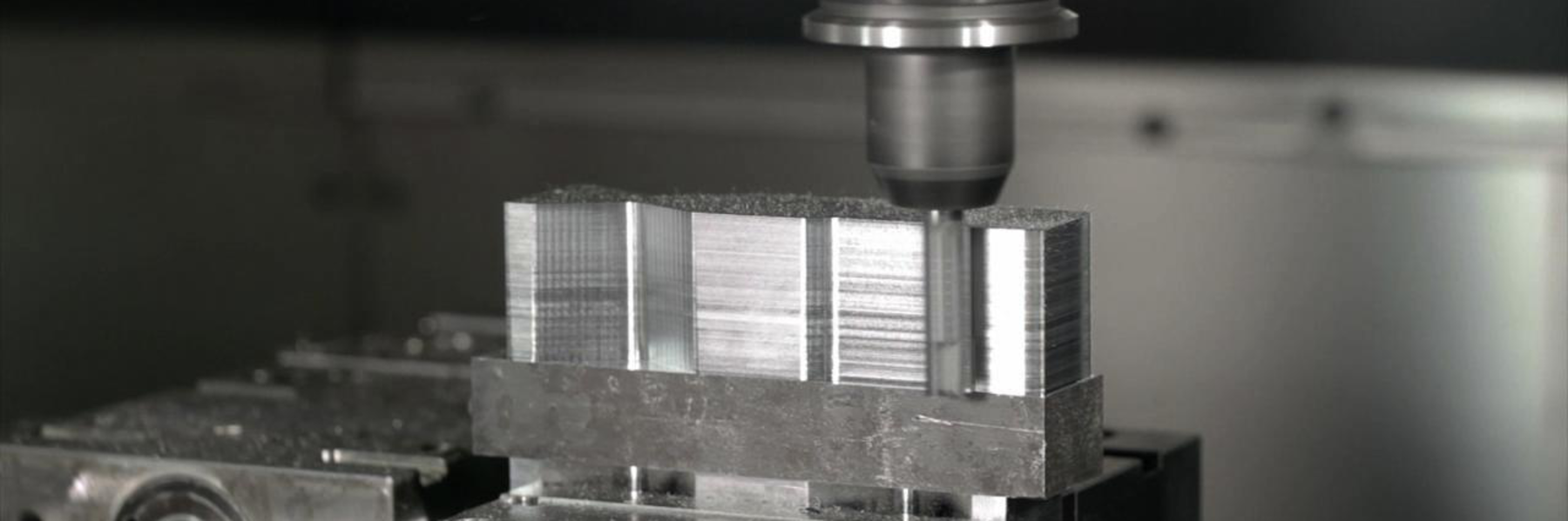

Dynamic Milling is ideal for machining outside profiles and pockets on 2D prismatic type parts such as those often found in the aerospace manufacturing and general engineering sectors. It is also effective for other part features that allow for using the whole flute length of the cutter at a 3 to 4xD, and in some instances 5xD, axial engagement. With its shallow stepovers and high depths of cut, Dynamic Milling makes it possible to machine parts three to four times faster while also significantly reducing tool wear, therefore, increasing tool life.
Its shallow stepovers, however, prevent the use of Dynamic Milling for complex 3-D contours and surface features. These types of parts may still be faster to rough out with Dynamic Milling in theory, but shops must consider the downstream effects. The strategy will produce 3-D surfaces with big stair steps left behind by the large depth of cuts, so even if it’s significantly faster than using another milling strategy, it will require additional semi-finishing passes to achieve a near-net shape.

Dynamic Milling generates massive amounts of long thin chips, and the more flutes a cutter has, the smaller/narrower its chip evacuation gullets. Using the strategy in pockets further magnifies the need for efficient chip evacuation. It is for this reason that Seco developed its chip splitters, specifically designed for dynamic machining. These chip splitters can be utilized for both dynamic roughing and finishing.
On a tool diameter of 10mm with a 40mm flute length (inch diameter 3/8" with a 1½" flute length) for instance, Seco imparts three special chip splitter grooves – with radial reliefs and axial clearance – on each flute, but these grooves are never in line with or overlap each other. The resulting shorter chips do not build up in the cutter flutes and are more easily evacuated through a machine’s air blast and standard chip conveyor.
