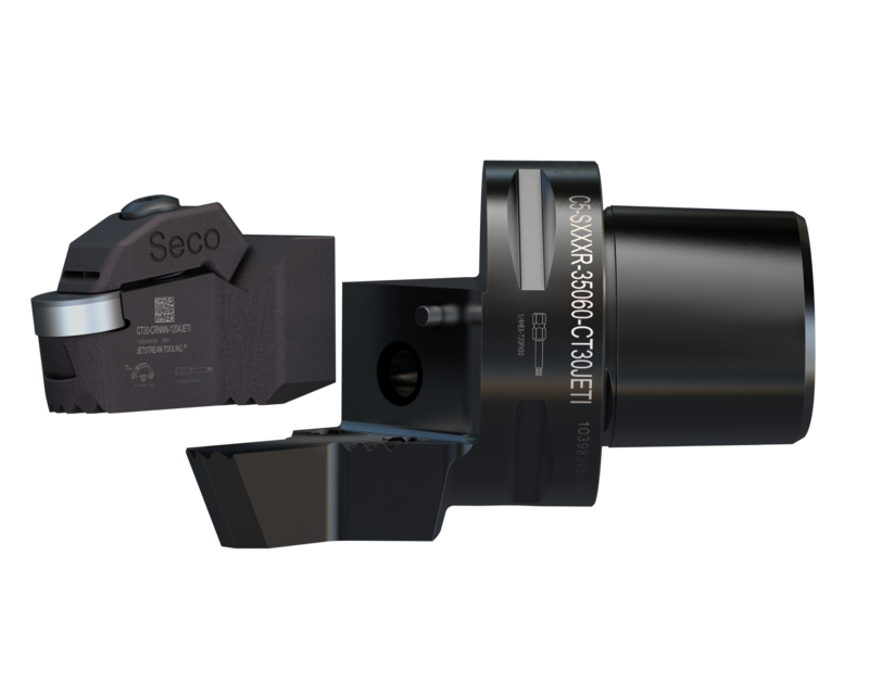

A modular system that keeps you agile

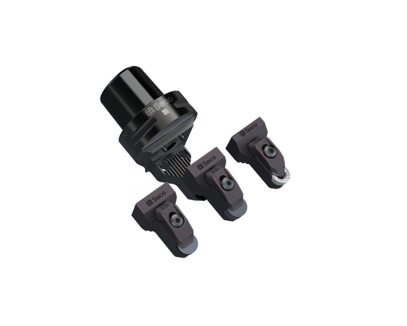

The updated Seco Capto™ cassette system lets you use one base toolholder with multiple AM‑produced cassettes. That means fewer complete toolholders to buy and store, faster changeovers, and more combinations which now include pockets for carbide, PCBN and ceramic inserts, all while maintaining the accuracy Seco Capto™ is known for.

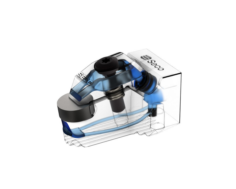

High‑pressure, internal coolant channels for impressive tool life
These new cassettes feature internal coolant channels and support both Jetstream Tooling® and Jetstream Tooling® Duo, delivering the coolant exactly where you want it. You get stable chip evacuation and notably longer tool life especially when running challenging materials.

Because the cassettes are made with additive manufacturing, we can create internal coolant paths and geometries that aren’t possible with traditional machining. You also get reduced weight, improved rigidity, and this method reduces waste and supports sustainable strategies.

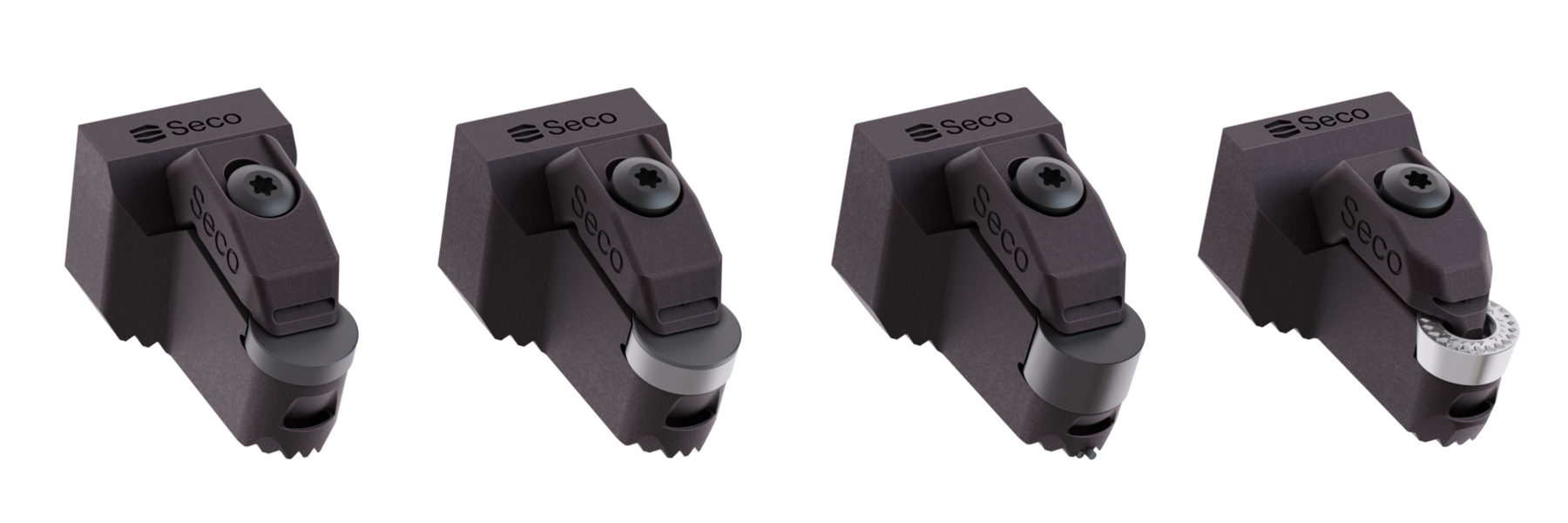

- Four Jetstream Tooling® Duo cassettes optimized for round size 12 inserts
- AM‑produced variants for ceramic, carbide, and PCBN inserts

- 12 Seco Capto™ base holders, including left, right and neutral versions across C4–C8

- AM‑designed internal coolant channels for improved control and heat stability
