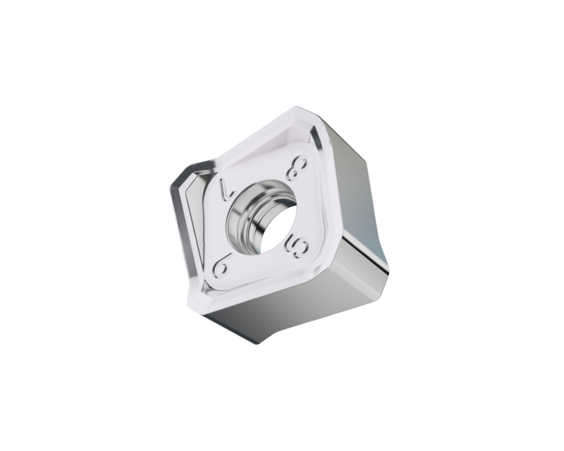

Wasting insert edges is money lost – it’s as simple as that. MS3501 ends the guessing game with Used Edge Detection technology, giving operators instant clarity on remaining edges. No missed corners. No premature discard. Just full utilization, lower tooling costs, and a more sustainable process. It’s intelligent, intuitive, and built for shops where efficiency is expected.
Your Challenge:
Operators unintentionally scrap inserts with unused edges, driving up tooling cost per component and creating unnecessary waste.
Our Solution:
Used Edge Detection makes edge status unmistakable and ensures every edge is used to its full potential before the insert is replaced.
