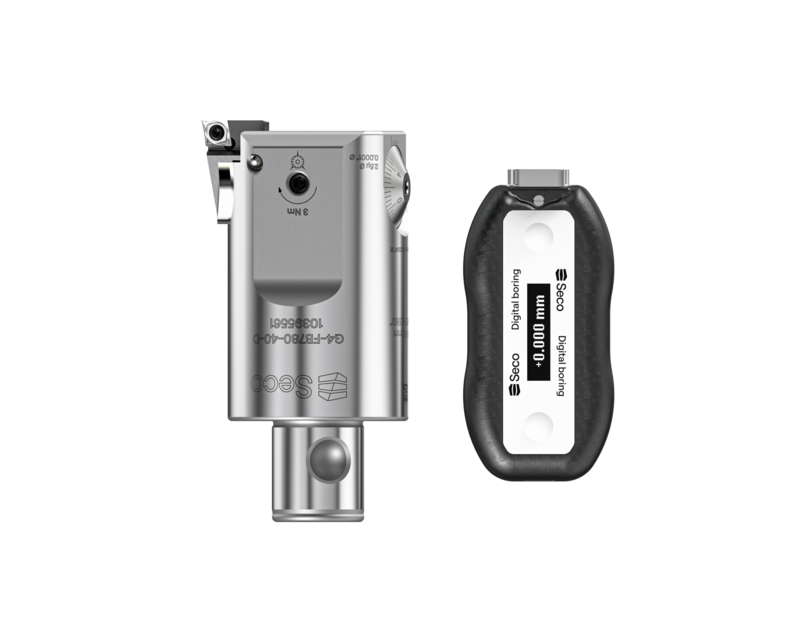

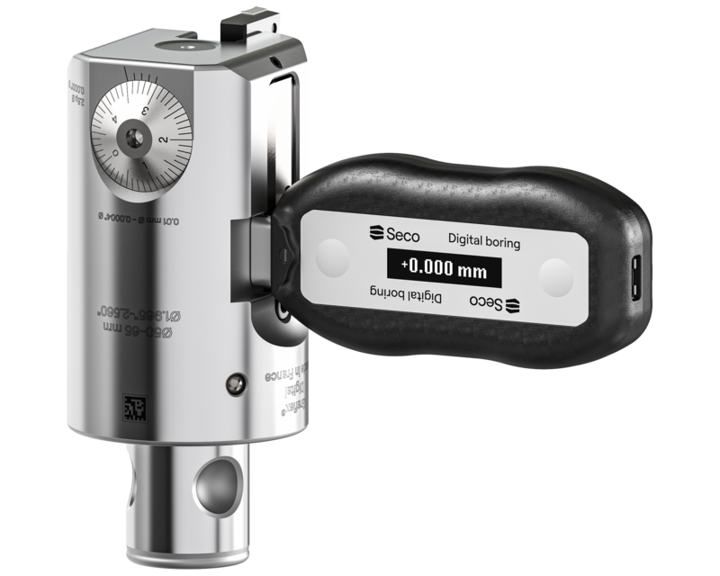

Experience fine‑boring precision with a 1 μm‑resolution digital display that transforms set-up accuracy. With a clear, wide, and reversible screen, operators avoid the guesswork of Vernier readings and, as one display works across all digital head sizes, your tooling ecosystem is simplified while quality and repeatability are elevated.

The digital display is built with a 100% recyclable plastic casing, it charges via a USB, and offers up to ~200 settings on a single cycle. With no battery inside the boring head, maintenance is reduced, disposal is simpler, and the tool is sealed, dust‑proof, and lubricated for life.
