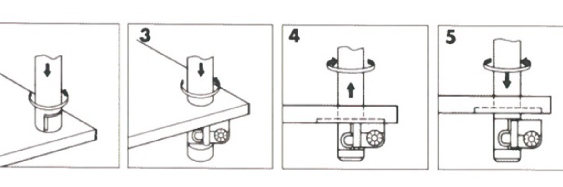

Erix Tool countersinks reduce countersink cycle time by 90%, eliminating the need to stop the program and manually operate the tool.How ERIX works
ERIX countersinks are a patented design consisting of a spindle and a tilt-mounted wing. In the first phase of the cycle, the tool rotates counterclockwise, which causes the wing to close in the spindle seat. Then the countersink passes through the prepared hole. After passing through the material, the direction of rotation should be changed to the direction consistent with the movement of the zegrar pointers and the working feed should be started. This will open the wing and bring the blade to the ready position. After countersinking, withdraw the blade in the direction away from the material and change the direction of rotation to counterclockwise again. Now you can withdraw the countersink from the hole, the wing will close automatically when it comes into contact with the material.

- Time-saving thanks to the possibility of chamfering face and back chamfers with one tool
- Machining in areas inaccessible to the operator, e.g. closed chambers
