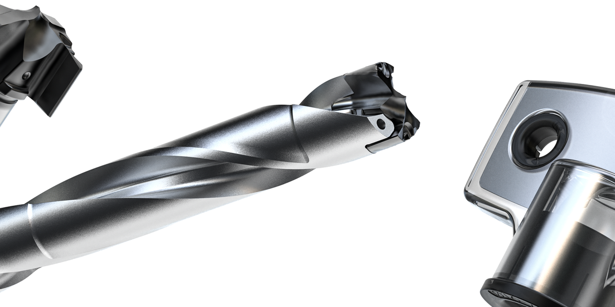

- Perfomax® indexable drills provide excellent hole accuracy thanks to a strong center insert and optimized cutting geometry, ensuring stable cutting conditions even at zero cutting speed in the drill center.
2. Poor chip evacuation in deep or difficult holes
Automotive components frequently require deep or interrupted holes in steel and cast iron. Poor chip evacuation can cause chip packing, deflection, and surface damage, increasing the risk of tool breakage.
Seco solution:
- Perfomax® drills are engineered for reliable chip control, enabling smooth evacuation and stable drilling performance in demanding applications.
- XTip® exchangeable tip drills offer optimized geometries that support efficient chip flow across a wide range of materials.

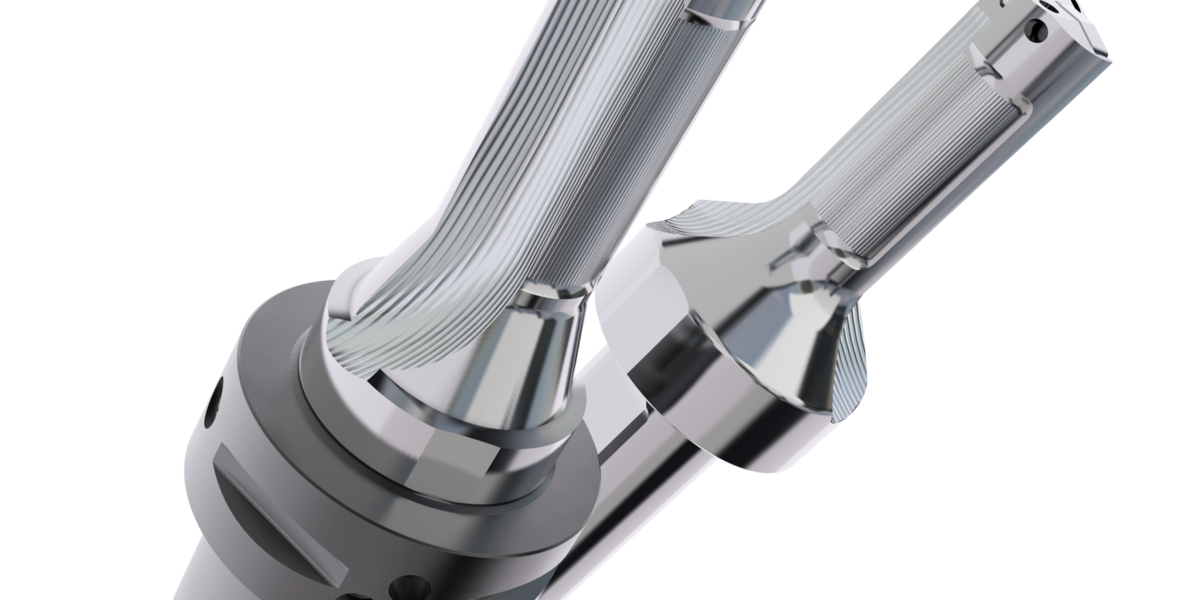

- XTip® exchangeable tip drilling systems simplify tooling by allowing quick tip changes without removing the drill body from the machine.
