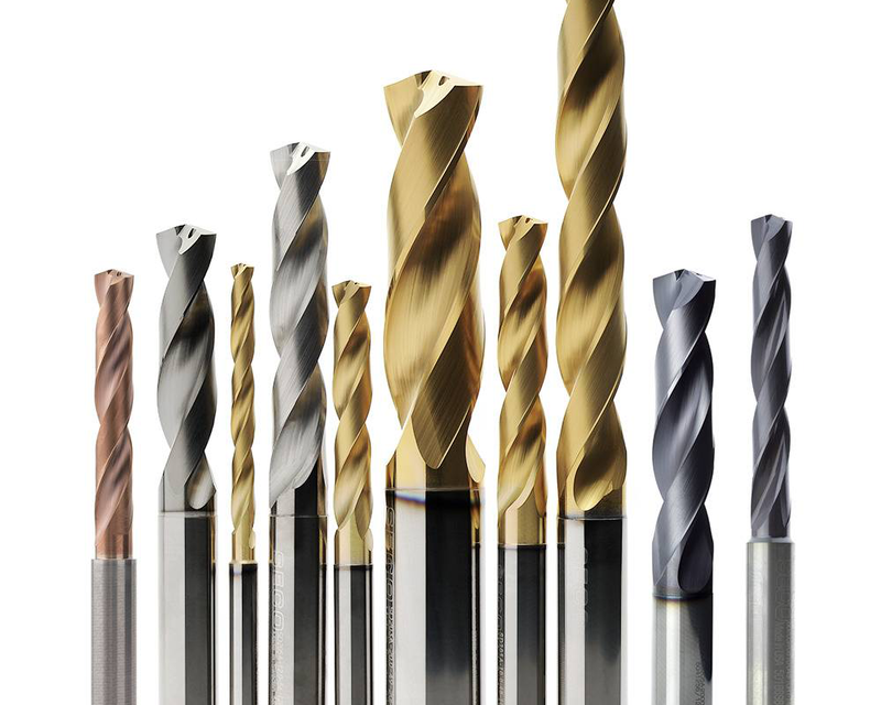

What kind of materials are drills made of and what can they machine?
Choosing a drill’s composition will vary depending on its use. Generally, drill bit materials are available in three categories.
High-speed Steel (HSS)
HSS drills are a good choice for drilling soft steels and plastic. They are economical and adaptable for many drilling applications.
High-speed Cobalt (HSCO)
With the addition of 5-8% of cobalt, HCSCO drills provide improved hardness and wear properties and are suitable for drilling steel, cast steel, titanium and other hard materials.

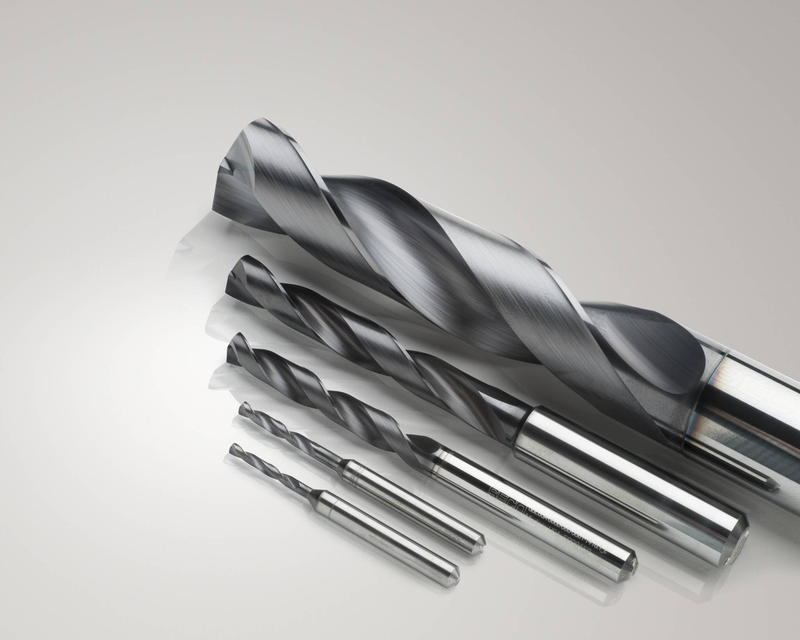

Carbide
Carbide drills maintain sharpness more than any other drill material and are best for the hardest materials, including ceramics, glass, stainless steel and cast iron. While outperforming all other drill materials, carbide drills are brittle and more expensive.

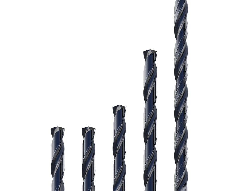

Drill lengths are also variable, however, there are defined types:
- Jobber length – The most common type of general-purpose drill made for a wide variety of jobs, combining strength and accuracy.
- Mechanics length – These drills have shorter flutes than jobber lengths, providing more strength and rigidity.
- Screw machine length – These are the shortest of the standard drill bits with more rigidity that reduces deflection.
- Extended length – Designed to drill deep holes, extended length drills incorporate long shafts and flutes.
- Taper length – These drills fall between the jobber and extended length bits in terms of dimension.

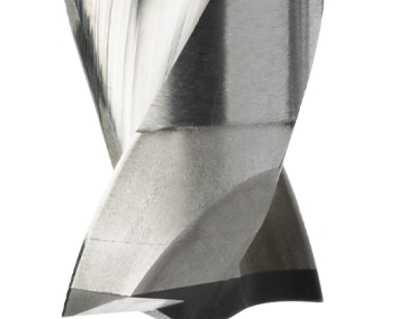

Cutting geometries
Drill geometry is the complex relationship between the various angles and aspects of the drill. The length and bore of the drill along with the configuration of its cutting edges, flute profile and point angle impact performance, accuracy and tool life.
Optimizing these relationships to the application, production goals and workpiece is essential to efficient, cost-effective drilling.
Components of drill geometry to be considered are:

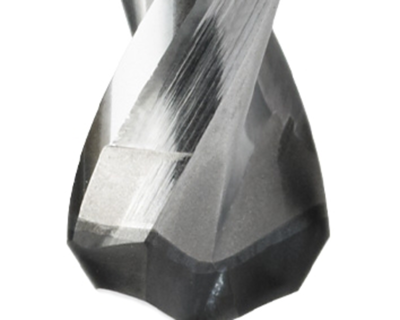

- Point angle – Located at the head of the drill bit, the point angle determines wandering, ease of centering, heat conduction and chip flow.
- Main cutting edges – Connected by the chisel edge, cutting edges perform the actual drilling process.
- Chisel edge – Located in the middle of the drill tip, the chisel edge length determines drill sharpness.
- Flute profile – Facilitates chip removal and coolant flow.
- Guide lands – Guide the drill as it works through the hole.

What drill coatings are available, and which are best for a given application?
There are a variety of coatings available for drills, each with specific advantages and more appropriate than others for specific applications. As in most tool selection questions, the answer to which is best is primarily driven by the operation and workpiece. Drill coatings also extend tool life, thereby reducing the overall cost per hole.
Coatings are generally applied to drill cutting edges via a process called Physical Vapor Deposition (PVD). PVD uses a physical process such as heating or sputtering to produce a vapor of material that is then deposited on the object being coated.
The most common drill coatings are:
- TiN, or titanium nitride, composed of titanium and nitrogen that has been shown to double and even quadruple tool life for general purpose drilling.
- TiAIN, or titanium aluminum nitride, which can extend tool life up to 10 times and offers excellent heat and oxidation resistance. Suitable for alloyed and stainless steels at medium to high cutting speeds.
- TiCN, or titanium carbonitride, provides very high hardness and wear resistance and can extend tool life up to five times that of uncoated tools. Works best on bronze and copper alloys as well as aluminum bronze and nickel alloys.
- ALTiN, or aluminum titanium nitride offers superior hardness for high-temperature applications when drilling very hard or abrasive workpieces.
The primary disadvantage of coated drills, however, is that they sometimes cannot be resharpened.

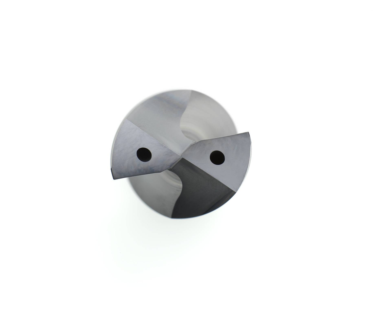

Internal coolant
Internal coolant is always recommended for drilling and is the best option for tough work materials such as super alloys and stainless steel. For effective internal cooling, through-cooling tools have cooling channels that direct coolant directly to the cutting zone.
External coolant
If external coolant is used, it is important to ensure the coolant flow is directed as parallel as possible to the drill as it reaches the cutting area. For acceptable chip evacuation, the maximum recommended drilling depth using external coolant should be no more than 3X diameter and reduce cutting speed by 20% as compared to operations using internal coolant.

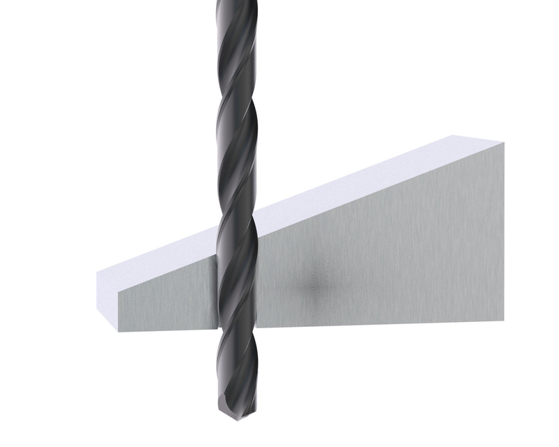

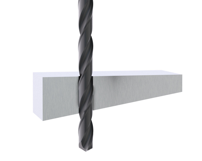

Angled Entrances
If drilling into an angled surface, machine a flat using a solid end mill via the interpolation method. If milling is not possible, reduce the drilling feed by 50% until the drill has reached full cut. Use a drill with multiple land margins and reduce feed rate by 30 to 50% during exit.

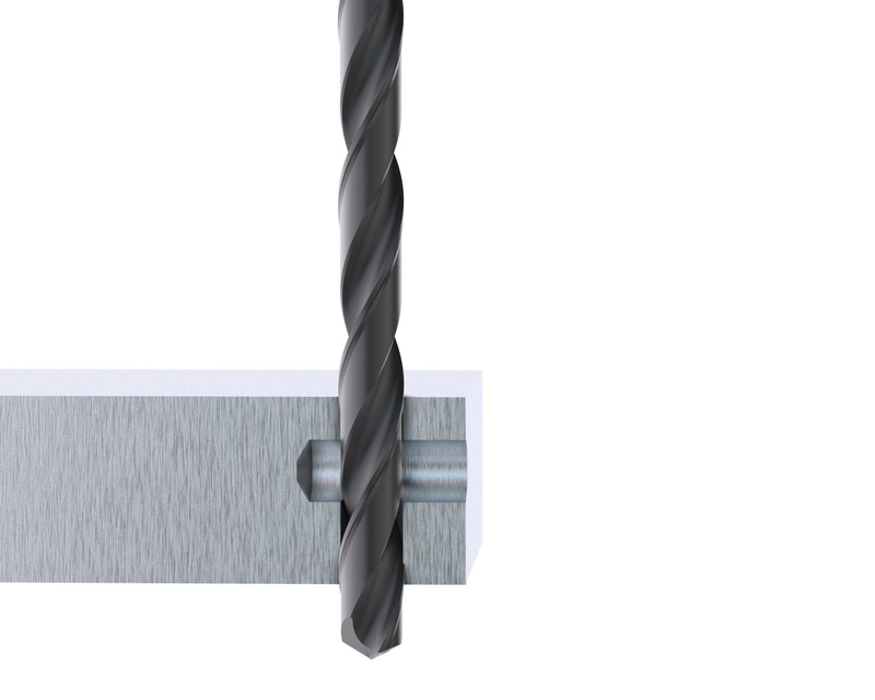

Cross holes
To drill cross holes, reduce feed by 50% 3mm before the crossing and maintain that low feed rate up to 3mm after passing the crossing hole. If possible, use a multiple land margins drill to improve guiding.

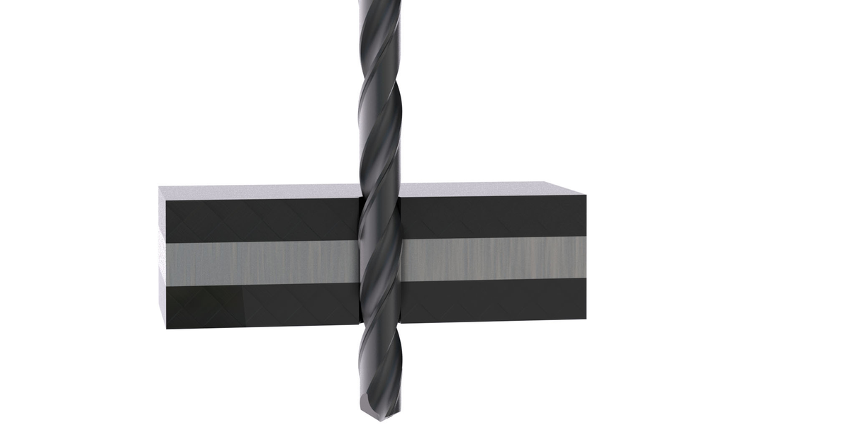

Stacked materials
Stacked materials can be drilled effectively as long as the workpieces are clamped securely so that there are no air gaps between them. Air gaps have a detrimental effect on chip evacuation and cause drill damage.
