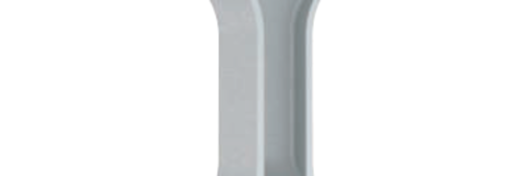

Connecting Rod
As the critical link between engine crankshaft and piston, connecting rods are forged and split into two parts by either a sawing or cracking process. Machining requires extremely strong and stable precision tooling and machines.

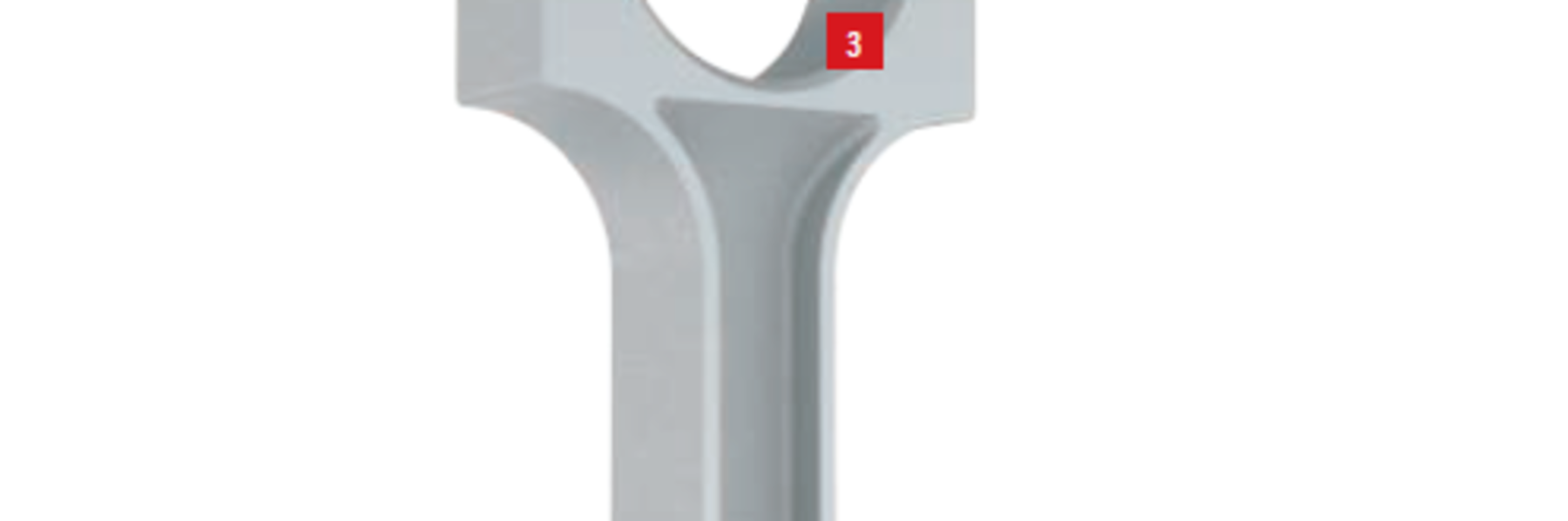

| | 3 - Roughing the crank bore
| Your Challenge: | | Productively and reliably producing both chamfers when roughing the crank bore. |
| Our Solution: | | This custom tool provides both crank bore roughing and chamfering by circular interpolation, with the ability to adjust the chamfer dimension by setting the insert with a fine adjustment screw. Through coolant holes increase tool life and chip evacuation, and the use of ISO/ANSI Duratomic® inserts maximize metal removal rates. Your benefits include greater process efficiency and reduced costs. |
| Product: | | Chamfering and Boring Bar |
