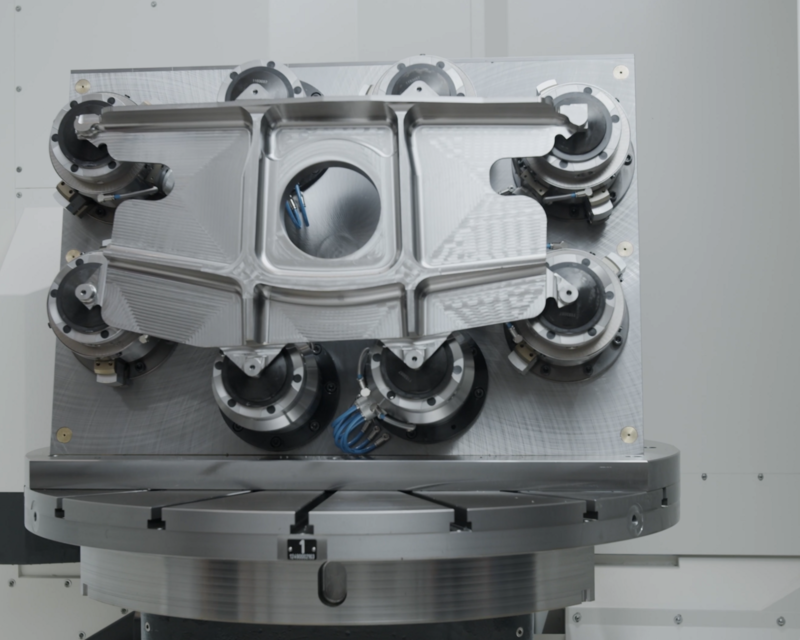

Manufacturing Challenge 1:
Front side. Small bridge on top
Key Manufacturing issues
- Remove large amounts of material.
- Avoid overloading the spindle.
- Maintain good chip control.
Challenges for this operation
- Optimize material removal from the top of the component.
- Maintain excellent chip control.
The Seco Solution
- Combine optimized cutting parameters with two high-feed solutions for maximized cutting parameters in aerospace machining.
- Use dynamic milling for high metal removal rates with a controlled spindle load and secure machining process.
- MP2050 insert combines excellent wear resistance with high edge integrity.
- New insert substrate provides increased toughness and tool life for excellent high-temperature properties with abrasive, sticky materials.

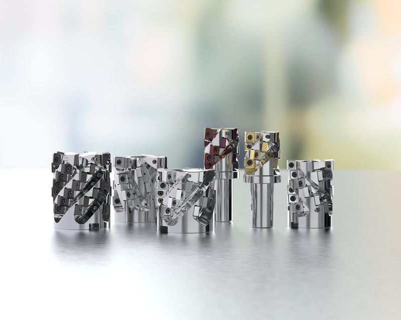

High Feed SP face mill
High Feed 2 face mill
MP2050 carbide/cermet inserts
Manufacturing Challenge 2:
All open pockets
- Remove large amounts of material in a stable, secure process.
- Achieve long, consistent tool life.
- Large amounts of material removal.
- Maintain high MRR in a productive, stable, secure process for aerospace machining.
- Maximize tool life.
The Seco Solution
- Combine an 8-edge helical mill with optimized cutting parameters for secure productivity.
- Dynamic milling with dedicated grades and geometries produce successful results in aerospace machining with titanium.
SN8 helical mill
Manufacturing Challenge 3:
Pocket in the middle
- Reach small-radius corners in deep-walled pockets.
- Maintain good chip control to avoid recutting that increases per-part costs through wasted time and material.
- Small-radius pocket corners require smaller-diameter cutters.
- Milling is difficult deep in the pocket wall.
- Good chip control is essential to avoid recutting of chips.
The Seco Solution
- Tooling provides a strong tapered core to reduce tool deflection and increase dimensional stability.
- Milling optimizes surfaces for finish machining.
- Advanced cutting parameters increase productivity in roughing and semi-finishing for aerospace machining.
Jabro JS720 solid carbide end mill
