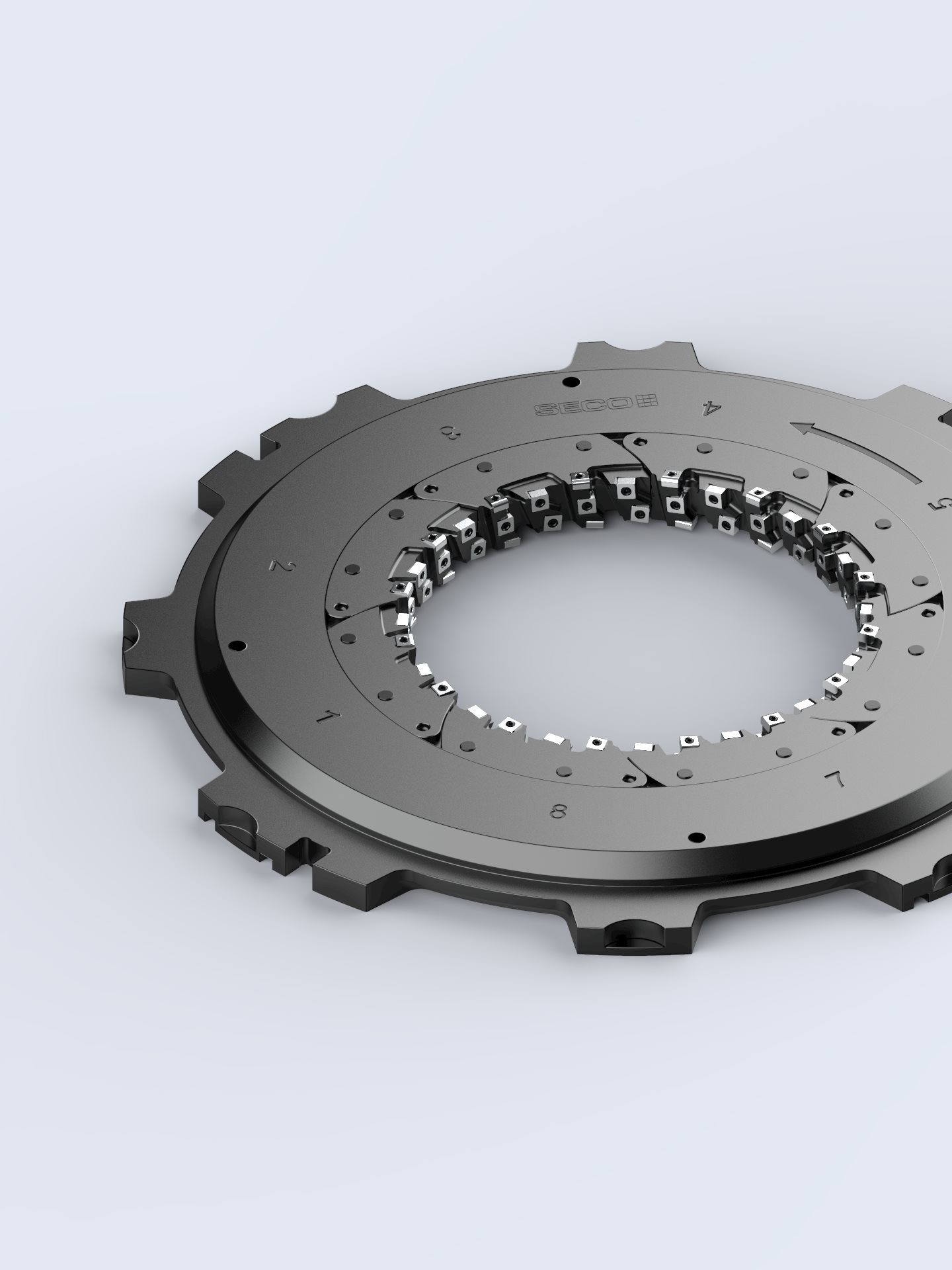

| 1 - Turning and broaching irregular stock |
Your Challenge: | | Efficiently turning and broaching irregular stock, interrupted cuts and impure surfaces. |
Our Solution: | | By incorporating various turning cartridges, the custom turn broaching disc can perform a variety of turning and grooving operations, from roughing with interruptions to finishing. Using standard, thick inserts in cartridges protected by carbide anvils, the tool offers high process stability and exceptional reliability. Your benefits include a cost-effective, flexible solution with limited machine tool investment. |
