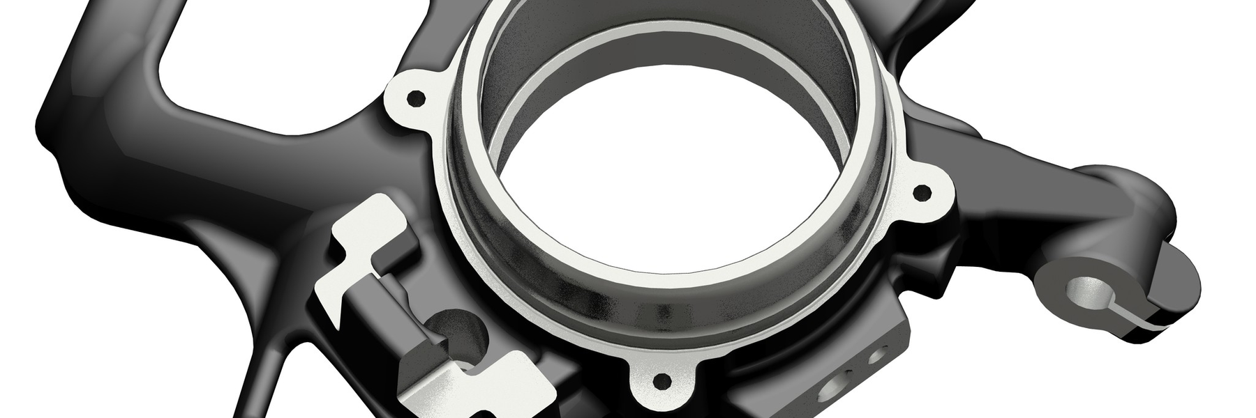

Optimized combination tools that accept off-the-shelf inserts make it easy to improve steering-knuckle manufacturing with fewer tools.Steering knuckles contain wheel hubs or spindles, and attach to the suspension components of a vehicle. Made from nodular cast iron, forged steel and aluminium, the components are critical to front suspension safety, so quality surface finishes, precision radii and perfect machined flatness are required.

The move to hybrid, electric and hydrogen vehicles makes many automotive parts obsolete and adds new ones to the production line. Steering knuckles remain part of the production mix, regardless of vehicle type. Their complexity – and the need to closely meet specifications and geometry – requires repeatable precision.
