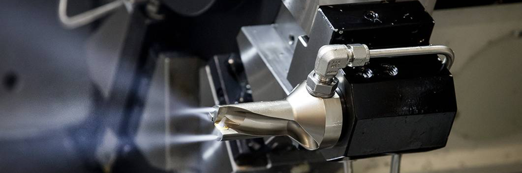

WORKING WITH HIS PhD students, he began experimenting with a substance known as supercritical carbon dioxide (CO2 ). Picture a high-pressure container, half filled with CO2 in its gaseous state, and half with liquid CO2 . Increase the pressure beyond the magic point of 1079 pounds per square inch and above 31 degrees Celsius, and you get matter of a different state: neither gas nor liquid. A fusion. And that fusion is, well, magical for machining. “I came at this from an environmental, health and safety standpoint,” says Skerlos. “And I said ‘wow, this is perfect in that respect.’”
When he and his students got the first results back and recognized that the substance far outshone regular machining fluids, he asked the students to check their protocols. “We’d never seen such low friction and lubricity, or been able to achieve speeds like that. The way it outperformed emulsions came as a massive surprise.”
Skerlos knew he had a revolutionary product on his hands. He checks off the advantages. It’s safe and bacteria-free. Tools last longer. It’s easy to apply to machine tools. CO2 is an inexpensive waste product. And unlike with fluids, there’s no mess. “Think about it…” he says.
“If you’re making biomedical implants, you don’t want to get machining fluid on them only to have to find a way to remove it. So far, we haven’t come across an application where we cannot replace emulsion, so this technology could ultimately replace emulsion everywhere. And that’s what should happen.”
SKERLOS HAS RECEIVED the support of the University of Michigan in developing and commercializing his patented supercritical CO2 process. The startup company he has founded is growing fast, selling the supercritical CO2 under the trade name Pure-Cut as a turnkey solution for strong cooling and enhanced lubrication. It’s the second company he has founded. The first built cytometers to identify microbial populations in machining fluids, and was eventually sold for over USD 200 million.
