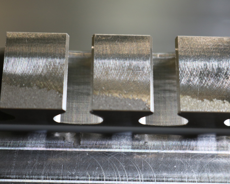

Turbine blade discs can require between 45 and 135 dovetails/fir trees with machining time dependent on disc thickness. The female profiles of disc dovetails and fir trees match the male profiles of turbine , compressor and fan blades. In pre-milling discs, advanced Seco high-performance and solid-carbide general machining cutters, along with special-profile cutters for dovetails and fir trees, enable you to balance time, cost and risk. The tools provide high-material removal rates to shorten cycle times without imparting stress on disc base material. While doing so, they also reduce the risk of tool breakage, part damage and scrap. For added cost savings and longer working life, Seco offers reconditioning and recycling programs for dovetail tooling.
Although several aerospace manufacturers have switched to milling disc dovetail slots, many are locked into roughing and semi-finishing them with the broaching method. In these instances, the combination of high-quality tailor made tools and inserts, such as single-tooth broaching bars, along with advanced broaching CNC programming strategies from Seco, enable you to achieve extremely tight tolerances and stringent surface finishes much faster in less overall processing time.

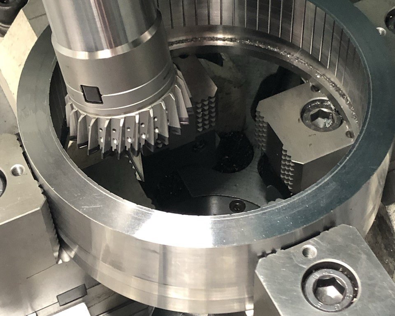

To generate turbine blade disc gear splines, aerospace manufacturers either use dedicated gear machines or opt for gear skiving on multi-tasking mill-turn machining centers. When splining on dedicated gear machines, Seco gear-milling solutions can shorten cycle times significantly critical for large-batch production. However, such specialty machines involve higher initial capital investments and the inevitable production bottlenecks of installation. They also add another machine to the overall turbine blade disc manufacturing process, increasing the risk of setup errors while consuming valuable production time.
Gear skiving turbine blade discs on multi-tasking machines with Seco gear skiving tools boosts part processing flexibility and eliminates the time-consuming setups required for multiple machine operations. With fewer setups, you also significantly lower the risk of errors and stacked tolerances.

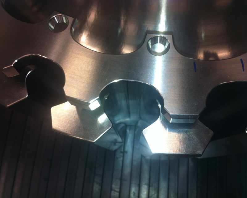

Any inconsistencies in deburring/edge profiling turbine blade discs can lead to part failure and catastrophic outcomes. Accordingly, you can perform the task as a mechanized CNC-controlled operation with Seco engineered edge profile tooling. Unlike time-consuming, inconsistent manual deburring that is harmful to workers, MEP removes humans from the equation and takes place in an enclosed machine. The part remains clamped after previous operations to maintain reference points, ensure reliability and high quality while maintaining the health and safety of operators.
The investments of equipment and time involved with manual deburring then shift to tooling for existing equipment. With Seco MEP tooling, you gain complete part feature accessibility – from the top, bottom or along varying radii – so no edge is missed.
