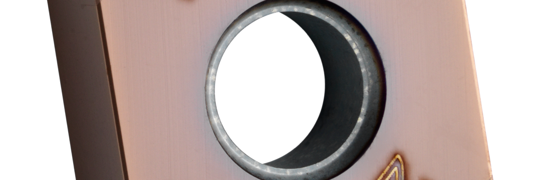

The new CH2540 has bimodal grain size distribution, where fine grained cBN (1 µm) with 15 µm grains added to the structure. One advantage of this type of structure is the crack deflection that the coarser grains cause.
Implementation of wiper geometries allows for feed rates of 300 percent of what could be attained with standard inserts, while achieving the same level of surface finish.
The tough CH2540 grade has once again proven successful during these cutting conditions.

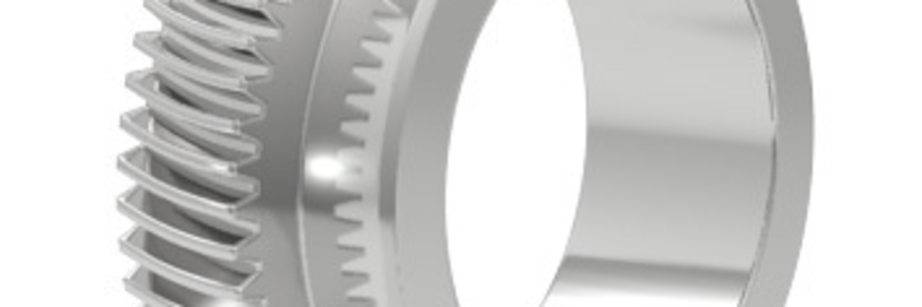

WORKPIECE
| Component | Ring Gear |
| Material | 16MnCr5, SMG-H3 | |
| Hardness | 60-62 Hrc | |
| Surface | Pre-machined |
| Tool life crit. | Ra | |
| CONDITIONS | | |
| Operation: | ID Turning, continuous cut | |
| | Competitor | Seco CH2540 |
| Insert: | CNGA120408….(Non wiper) | CNGA120408S-01525L1WZB CH2540 |
| Coolant: | No | No |
| Cutting speed: | 120 m/min | 120 m/min |
| Feed rate: | 0.14 mm/rev | 0.40 mm/rev |
| Depth of cut: | 0.12 mm | 0.12 mm |

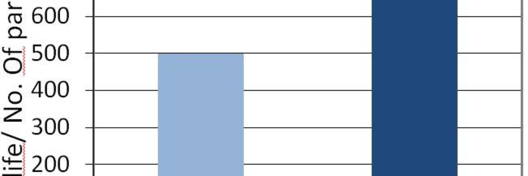

| Tool life: | 500 parts/edge | 800 parts/edge |
At this customer has feed rate been increased from 0.14 mm/rev to 0.40 mm/rev and tool life from 500 parts to 800 parts.
This is not just a reduction of Time in cut with 65% it is also an increased tool life with 65%.
This is a true winning solution that will give the customer a real and quick cost saving.
