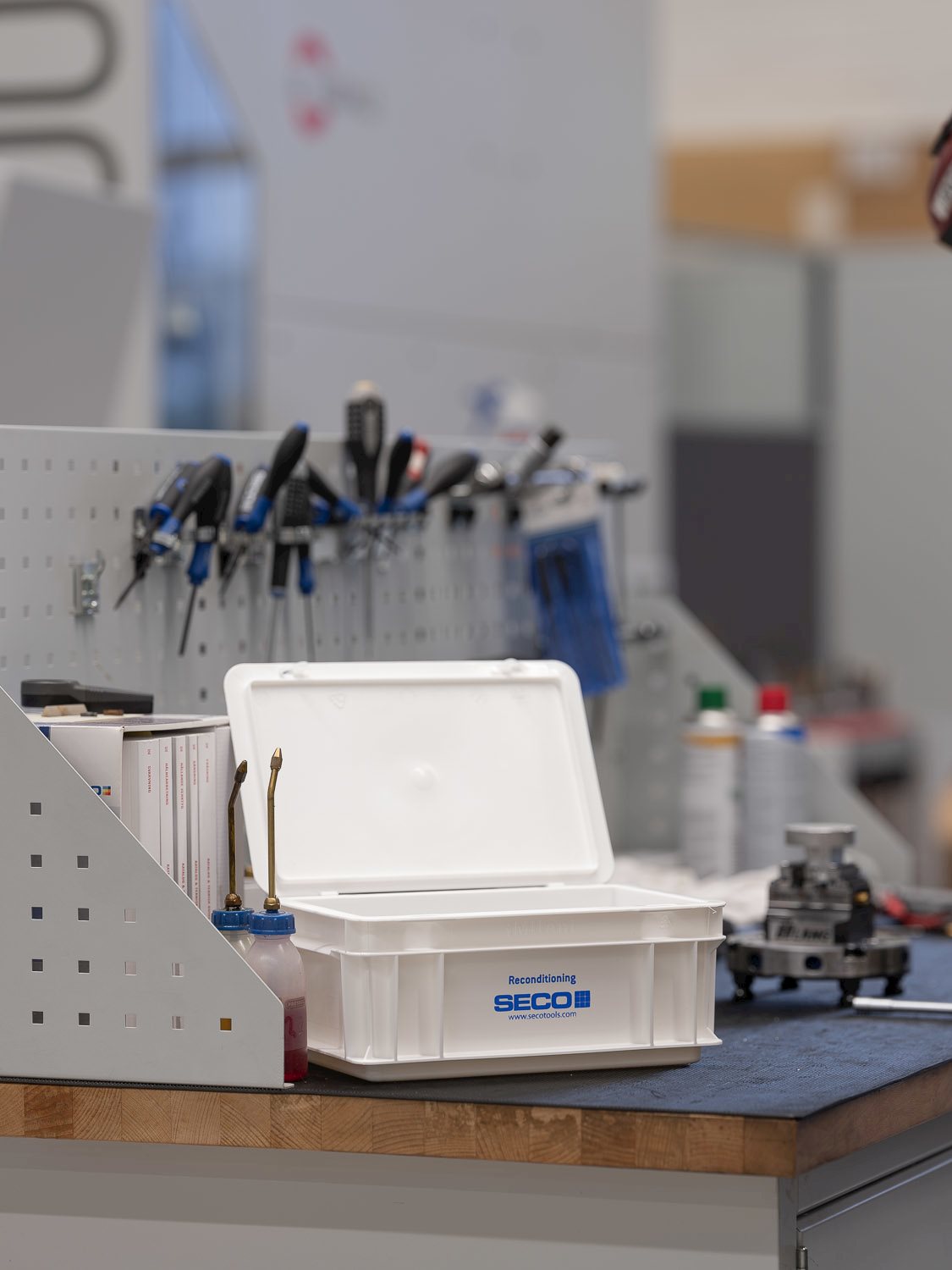

The reconditioning service of Seco is available for eligible Seco solid carbide tools, including selected drills, end mills and reamers.
The condition of the tool is an important factor in determining whether it can be successfully reconditioned. Tools with excessive wear or significant damage may not be suitable for restoration.
Please note: The reconditioning program of Seco is for eligible Seco tools and does not cover cutting tools from other manufacturers.
How to get your cutting tools reconditioned
The tool reconditioning service of Seco gives eligible solid carbide tools another productive life by restoring their cutting geometry and coating.
By reconditioning tools at the right time, manufacturers can extend tool life, reduce tooling costs, limit material waste and support more resource-efficient production.
Contact your local Seco representative to find out whether your cutting tools are eligible for reconditioning and how to get started.
