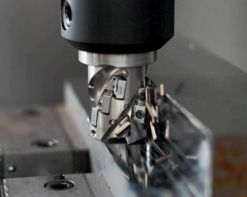

Insert tools for MMC machining
Selecting the right cutting inserts is especially crucial when machining MMCs. The general preference is for materials that have high abrasive wear resistance, such as fine-grain cemented carbide or polycrystalline diamond tooling, as they maintain a sharp edge to reduce built-up edge.

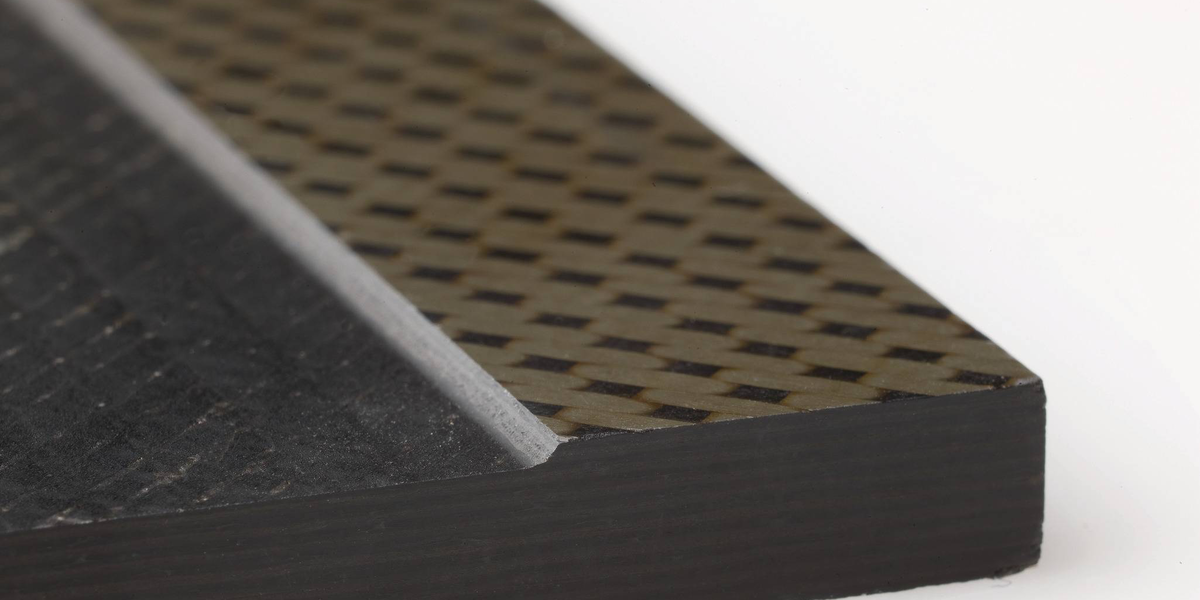

However, the emergence of novel MMC compositions, such as titanium alloys with long-fiber reinforcements, means the machinist needs to take a more nuanced approach.
“Long fiber materials can exert certain properties in certain directions, such as anisotropy, where there are different behaviors in different directions because the fibers only align in certain directions,” says Rachid M’Saoubi.
“In composite materials that’s quite often the case. For example, carbon-fiber reinforced plastic has fibers that are oriented in certain ways. That means you have to modify the orientation so that they give you an overall good mechanical property in multiple directions.”
M’Saoubi says short particles are less of a problem in MMCs (with a volume fraction of five up to 40%). But understanding their size and distribution in the material becomes paramount for achieving the best possible machining outcomes.
