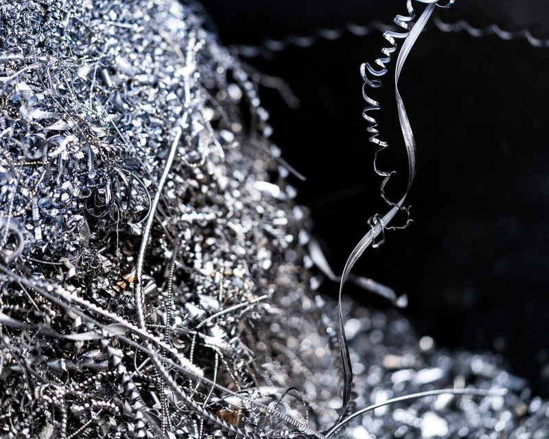

For that matter, duplex stainless steel is very demanding to cut and requires specifically designed inserts. Like many of today's stainless steel alloys, it creates swarf and chip problems, including longer chips and bird's nest configurations, especially in finishing operations. Stainless steel complicates surface finish work because of ductility, especially with austenitic and duplex stainless steels. Alloying elements cause built-up edge, which rubs and damages the finished surface. Strain or work hardening also causes chips to fly back and mar part surfaces.
