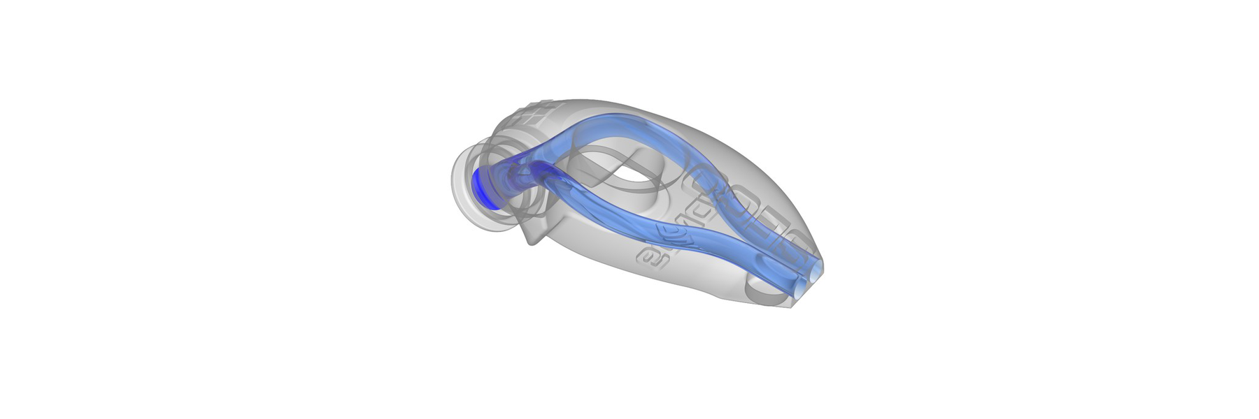

Trend #1: Improving coolant flow
Toolmakers look to additive manufacturing to add through coolant with better results than machining can achieve.
The machined technique produces a sharp edge that forces coolant to swirl rather than form a forceful stream.
The two-hole approach to coolant channels is unnecessary with 3D metal printing.
Tools built through additive manufacturing incorporate a single coolant channel, a structure that machining cannot produce.
Printed channels direct coolant to the cutting edge efficiently and reach areas that otherwise would escape the flow.
