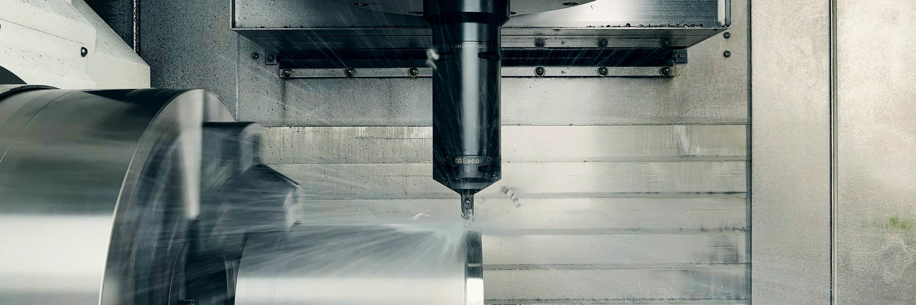

Seco JETI toolholders for round, positive turning inserts give you the power of dynamic turning. Combining the strength of a round insert geometry with the proven performance of Jetstream Tooling®, these toolholders can redefine your productivity and part quality when pocket machining.
Your challenge:
Effectively machine pockets in difficult-to-cut materials.
The Seco solution:
Employ dynamic turning strategies with round, positive turning inserts and high-pressure coolant toolholders.

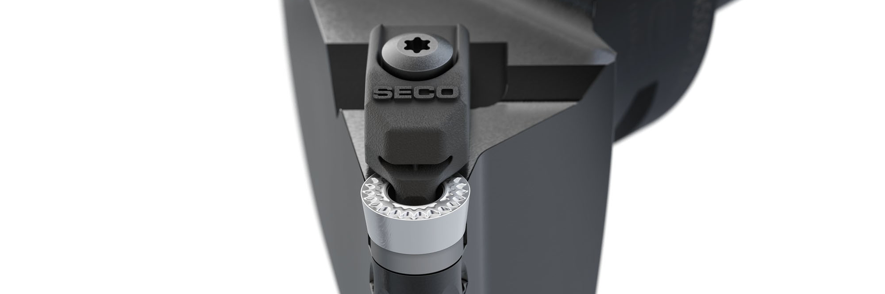

High-pressure coolant made easy
JETI toolholders offer fast and simple integration of high-pressure coolant. These toolholders require no hoses or extra parts. The single-screw coolant clamp design further streamlines the setup process. By 3D printing our coolant clamps, we deliver coolant precisely where it is needed most, with no extra effort on your part.
Your challenge:
Effectively control chips for higher process security.
The Seco solution:
Efficiently control and evacuate chips with precise high-pressure coolant.
Your challenge:
Avoid long setup times commonly associated with high-pressure coolant systems.
The Seco solution:
Eliminate external hoses and parts by using toolholders with internal coolant channels.
Your challenge:
Reduce insert indexing times.
The Seco solution:
Streamline setups with JETI toolholders that feature single-screw coolant clamp designs.

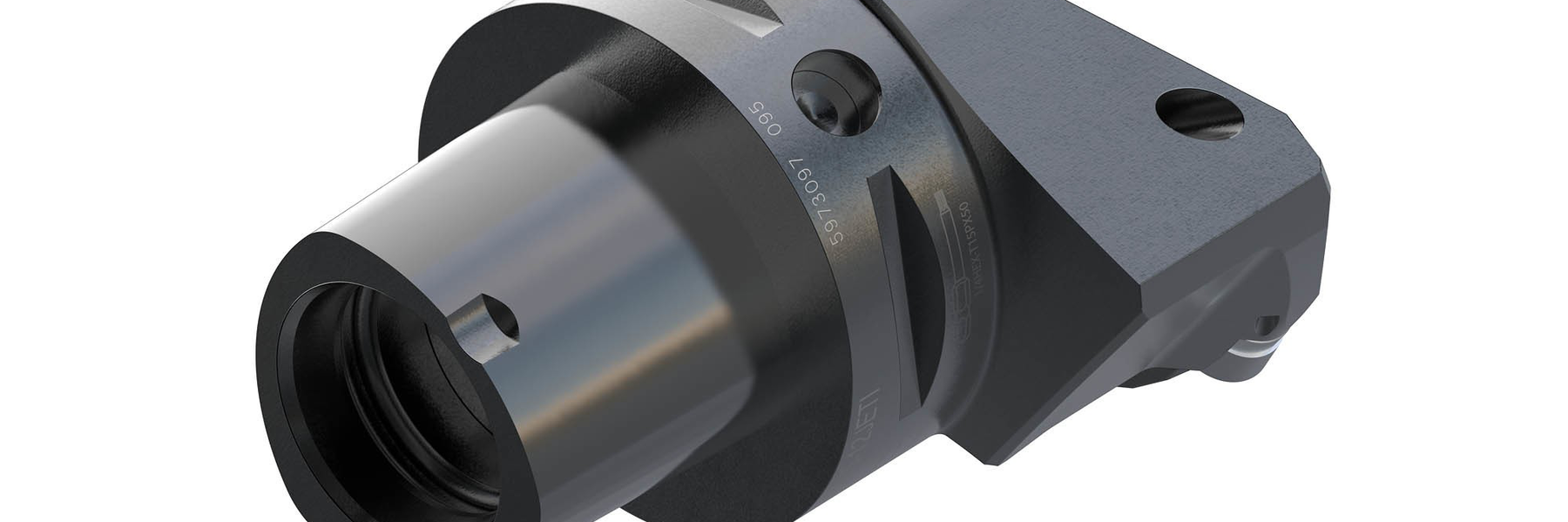

Ready for IIOT
JETI toolholders with a Seco-Capto™ connection come with a pre-drilled hole to install a Balluff chip.
With this feature, you can incorporate the toolholders into an RFID system to manage data gathering and transfer without manual entry.
Your challenge:
Increase operator efficiency and productivity.
The Seco solution:
Eliminate manual work with RFID identification.

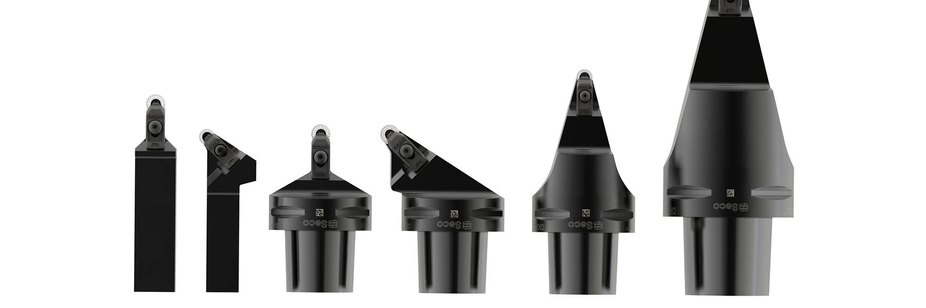

Discover the JETI toolholders range
