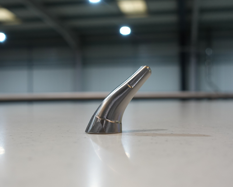

Single-machine processing of humeral stems

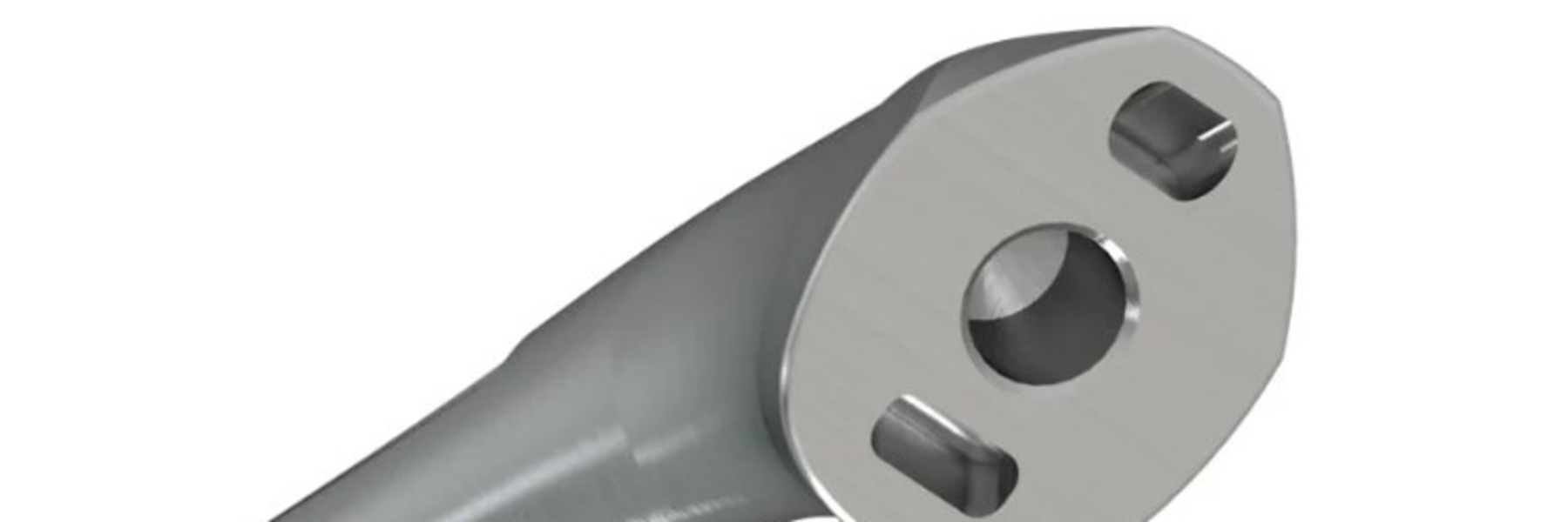

The humeral stem connects the arm to the ball and socket joint and requires processing difficult-to-machine titanium while maintaining high accuracy and exceptional surface finishes. Historically, humeral stems were forged then machined to shape. That process, however, presented production challenges such as multiple setups on multiple machines, downtime and inefficiency, decreased accuracy and unacceptable surface finishes. The current trend, however, is to use a single 5-axis, dual-spindle mill/turn machine with B-axis capability to rough round titanium bar stock into concentric shape then perform necessary finishing operations.

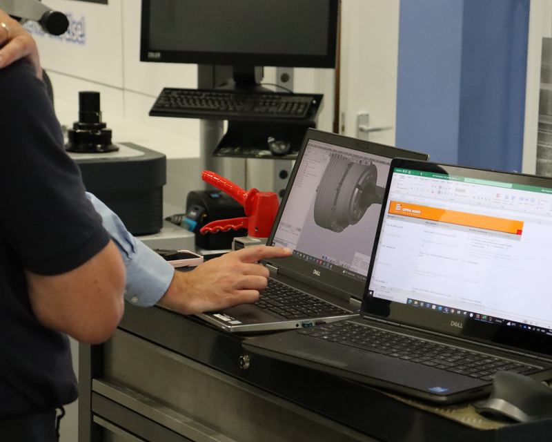

Seco has developed an entire process including design and programming strategies, machining, tooling and workholding solutions based on this single-multitasking machine processing strategy for unmanned production. Using this strategy, manufacturers overcome several industry challenges, such as reducing the need for skilled labor, to meet the production challenges while improving accuracy, maintaining required surface finishes and ensuring quality control for regulatory compliance. Advanced multitasking machine technology also streamlines production of these complex parts and enables manufacturers to keep pace with advances in material technology.

Milling the humeral stem’s connection face requires precision milling with extremely tight surface finish tolerance control. An advanced roughing strategy was chosen utilizing the JS750 series high-performance solid carbide square shoulder end mills and ball nose cutters.
This range is optimized for challenging materials with proven geometries and coatings, often improving tool life by 25 to 40%. An advanced roughing strategy will also reduce the tool inventory list for these components. Reconditioning of these tools is also available, allowing the manufacturer to amortize costs and reduce the Cost Per Part further.
