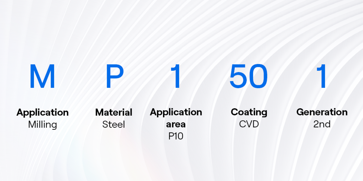

A shop’s overall tooling strategy also plays a role. Some grades are suited to machining the wide variety of materials and applications found in high-mix/low-volume production; however, their versatility comes at the expense of high performance for a particular process encountered in low-mix/high-volume manufacturing. As a result, shops must decide whether a more universal, all-round performance grade will cost-effectively meet their requirements, such as F40M, or whether they will need a number of more specific grades to perform well in specific recurring situations, such as MP1501 and MP2050.
