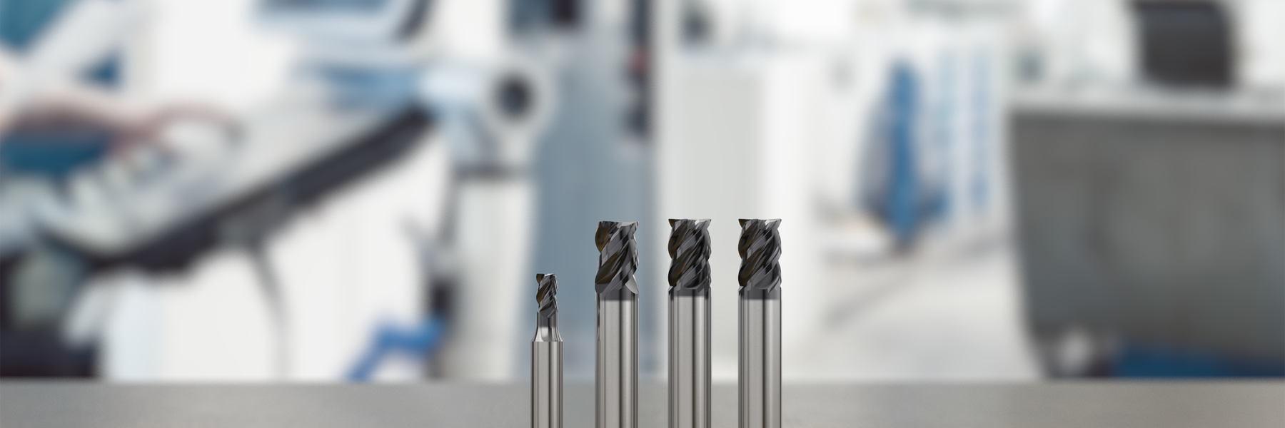

For Multi-Tasking Machines, shorter tooling is better as the machining processes entail complicated toolpaths and multiple tool changes when using standard-length or long-reach tools. In most instances, only the very ends of these tools are in the cut, so large portions of their cutting edges go unused. Plus, longer tools tend to lack stability, which can shorten tool life.
Conversely, shorter cutting tool lengths are perfect for premium real estate in the machine work envelope. They allow for more maneuverability around the workpiece, and manufacturers reduce waste by using the entire tool not just half its cutting edge length. Plus, shorter tools require less carbide to produce and are more cost-effective.
For optimum performance and stability, Seco designed its JS550 Stub Series endmill geometries with an SIRA coating and its industry-proven JS754 geometry Stub Series with the unique HXT coating. The tools are made for use in second spindles or live rotary milling turrets of Multi-Tasking Machines and developed by Seco specifically for ISO-P, M and S materials. The combination of geometry, coating and shorter protrusion length increases tool life by 20% to 40% when compared to conventional size tools.

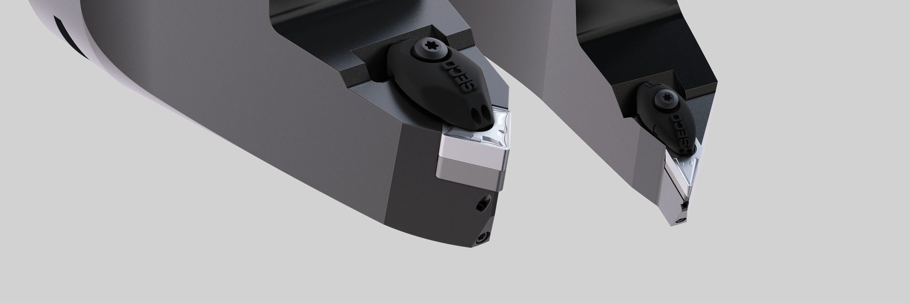

For 45° B-axis turning on Multi-Tasking Machines, specially designed toolholders provide greater reach and less overhang while reducing the risks of collisions and ensuring greater productivity. For those machines with dual turning spindles, these toolholders allow shops to use one set of tooling/inserts for 45° B-axis turning applications on both spindles instead of right and left hand tooling. At the same time, they reduce cutting tool vibration and chatter for better parts and surface finishes.
One such holder designed for 45° B-axis turning is the Seco-Capto MTM JETI Toolholder for general ISO turning. The holder features a unique 3D-printed coolant clamp that secures with one screw for quick setup and insert indexing. With Jetstream Tooling® technology, the toolholder delivers high-speed cutting fluid directly to the cut for efficient chip management and extended tool life – even at higher speeds and feeds – to improve surface finishes and part quality. Multiple clamping sizes accommodate various materials and depths of cut, from standard machining to extreme roughing.
