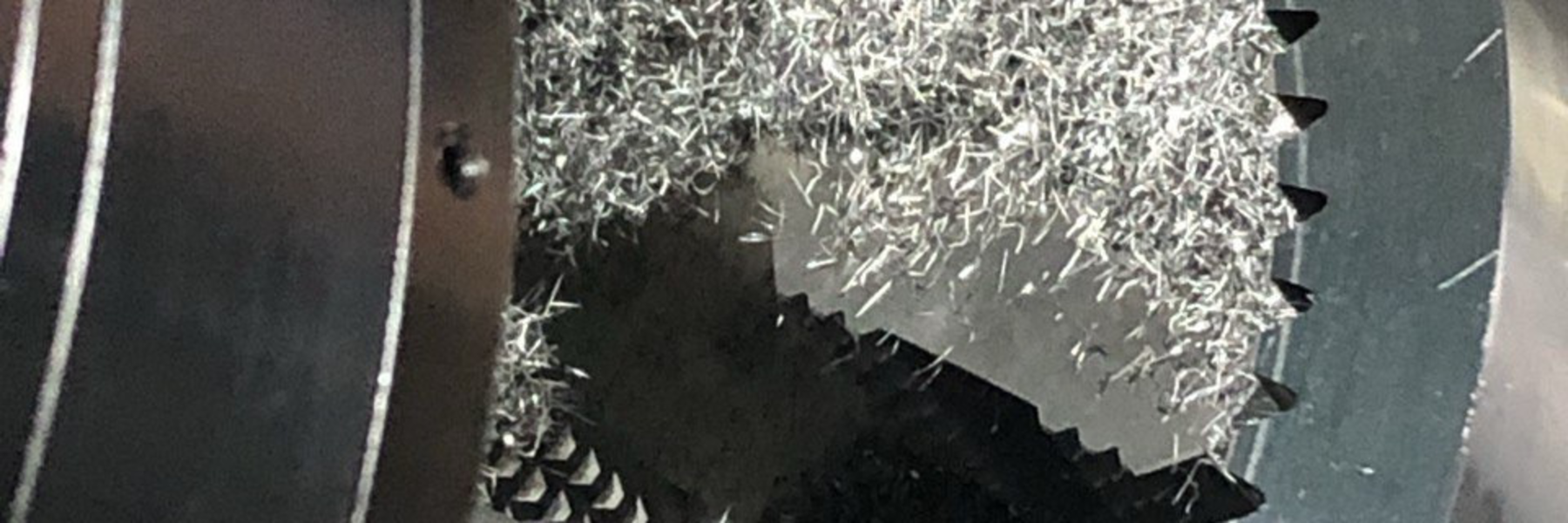

However, the main drawback of gear hobbing is that it can only run on external gears or splines, making them unsuitable for internal gears and splines that are features of jet turbine discs. It also takes longer, sometimes a few hours, whereas gear skiving is like removing a small chip extremely fast, peeling away the layer by 0.5 to 0.6mm with each step. In fact, gear skiving’s alternative designation of power skiving is well named because it can be three to four times faster than gear hobbing, with cycle times of minutes instead of hours.
In addition to this, if you need a short exit – for example, if you have a wall like you have on a turbine disc – using gear hobbing can lead to a collision with the stock, which can cause deviations. In this sense, gear skiving has more maneuverability because the shape of the skiving head is like an ellipse and the exit distance will be less than half that of gear hobbing.

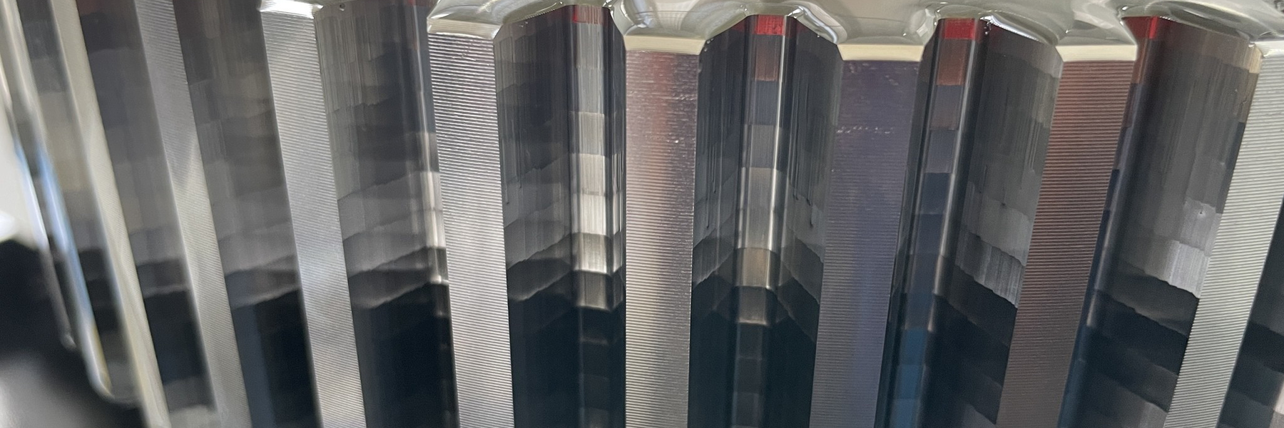

Producing more accurate components: Above all, gear skiving is highly accurate. It can produce gear shapes that are sufficiently complex and precise gear shapes to meet the exacting demands of airplane turbine disc manufacturers, where there is no room for error. Gears produced by gear skiving mesh together smoothly on the turbine disc and in turn that reduces wear and tear, as well as improving this crucial component’s overall performance levels.
Less risk of tolerance deviations: Because gear skiving is a continuous cutting process there are no interruptions during the machining operation, which avoids the risk of tolerance deviations. This and the lesser heat generation of gear skiving can result in smoother and more consistent surface finishes, improving the structural quality of the turbine disc. These smooth surface finishes help minimize friction on the turbine disc, which lessens the risk of the stress fatigue that causes dangerous cracks in parts. Again, this helps to address the aerospace industry’s ever-present reliability and safety concerns.
