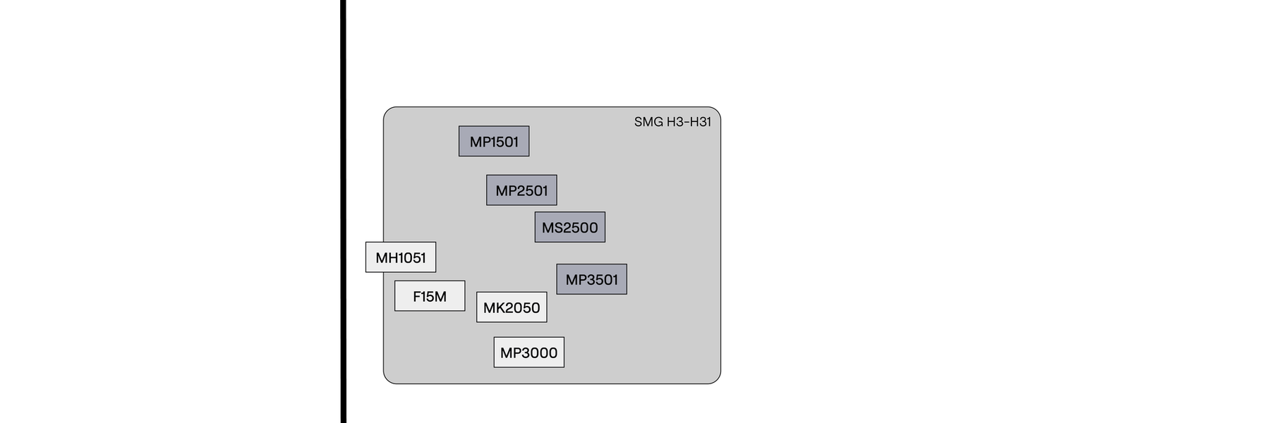

SMG H (Hard Material) is divided in 8 sub-groups, to capture specific material characteristics and reduce the complexity of every specific material.
Based on grade portfolio, first and second choices are provided for each sub-groups. This is a starting grade recommendation which can be optimized depending on the application, based on below mentioned grade mapping.

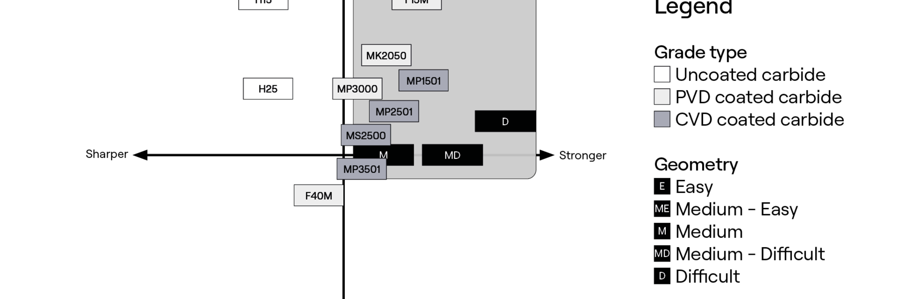

Mapping of Hard Materials milling grades

Get to know our grades for Hard Materials
