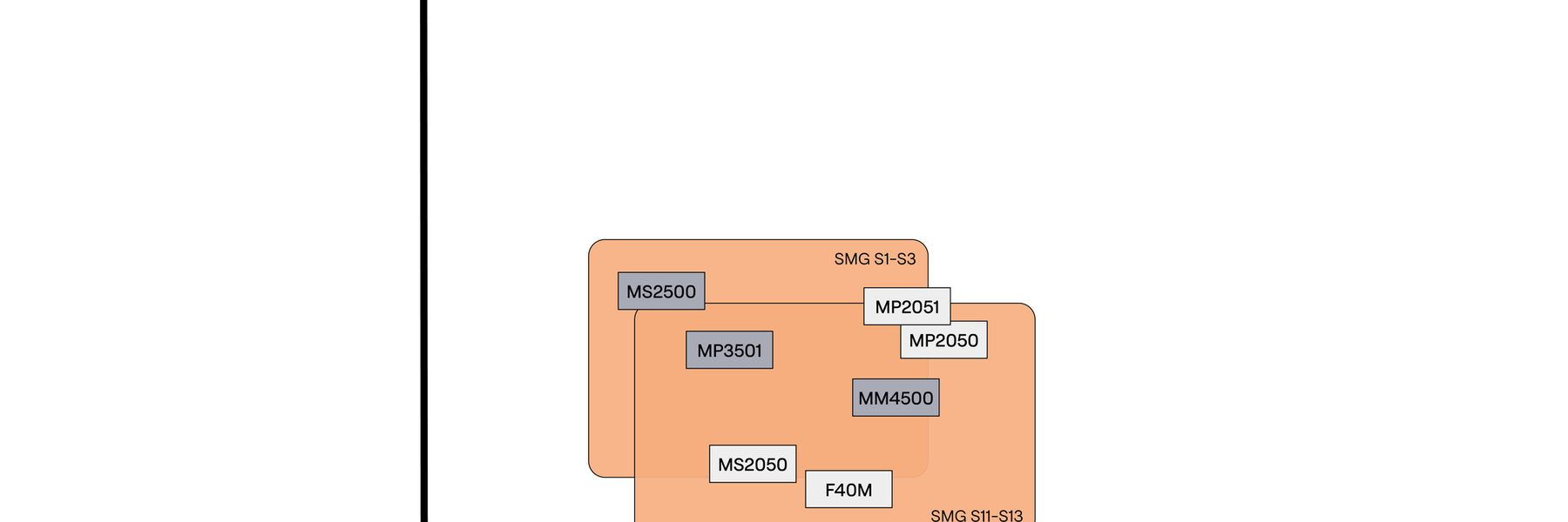

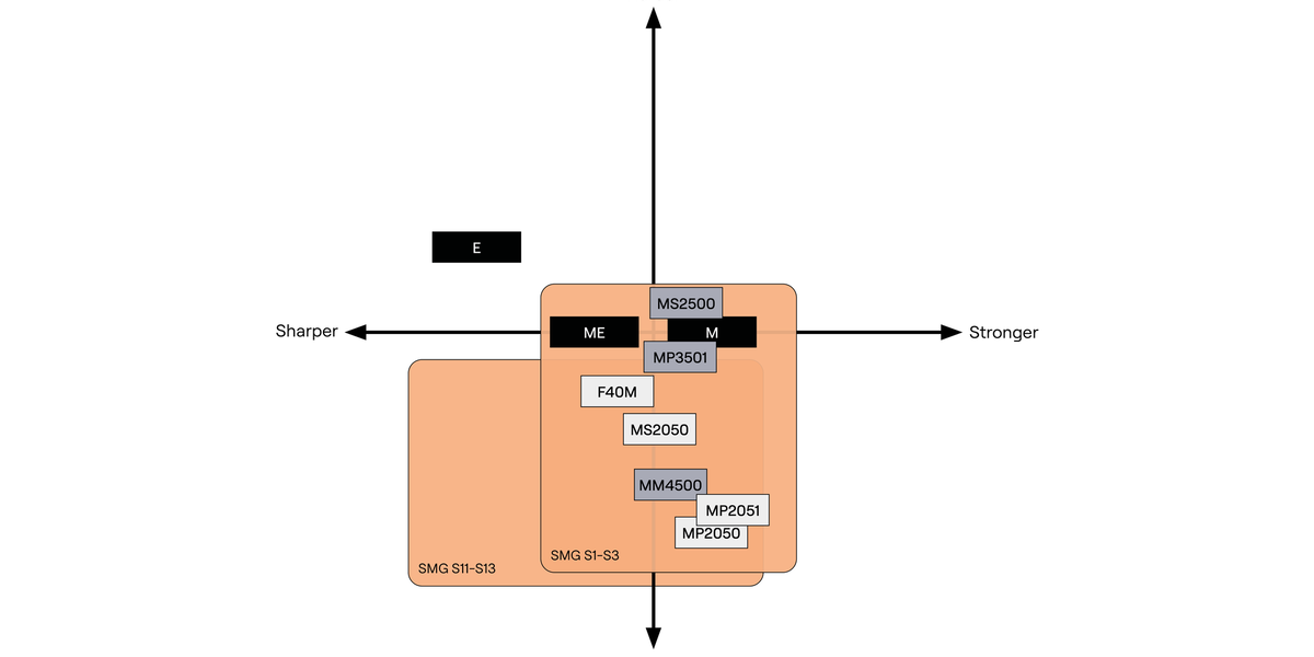

A mapping of Superalloys Milling grades and how to select the right one.Material grouping and Grades references for Superalloys / Titanium
SMG S (Superalloys and Titanium) is divided in 6 sub-groups, to capture specific material characteristics and reduce the complexity of every specific material.
Based on grade portfolio, first and second choices are provided for each sub-groups. This is a starting grade recommendation which can be optimized depending on the application, based on below mentioned grade mapping.

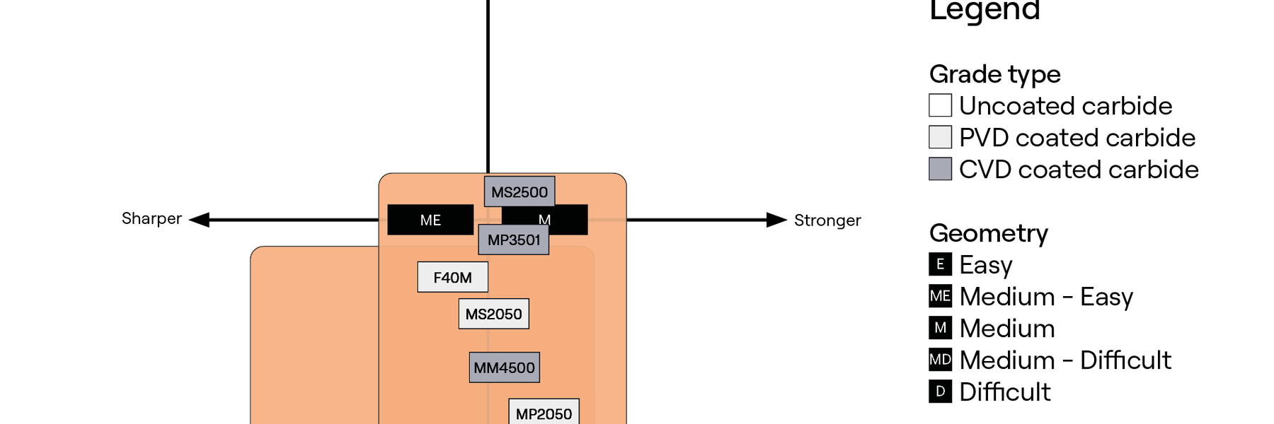

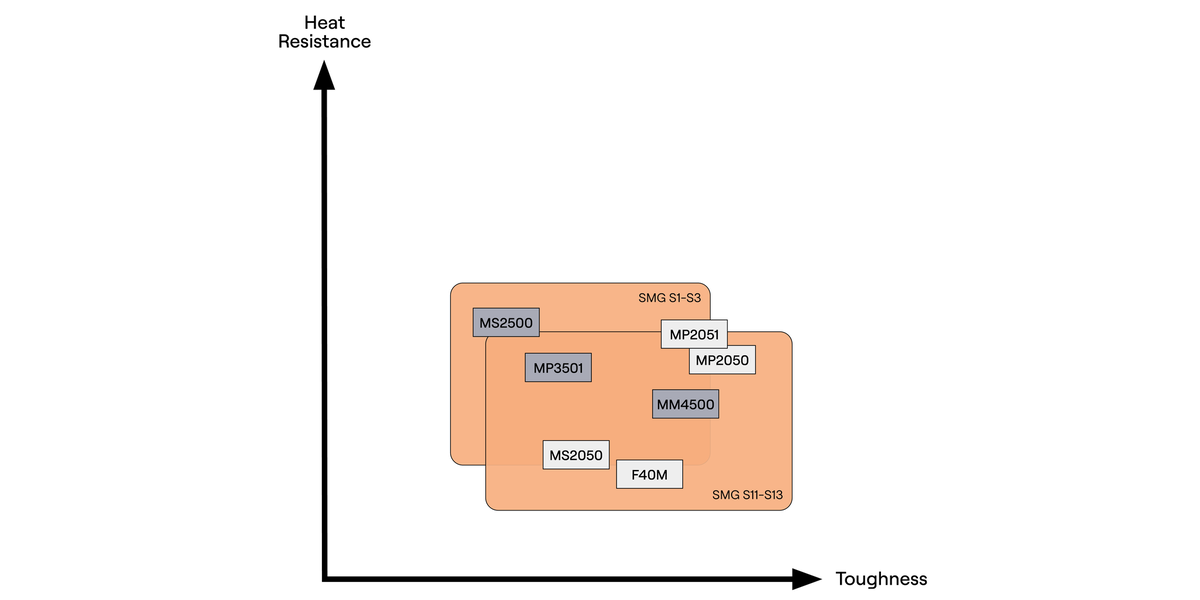

Mapping of Superalloys / Titanium milling grades
Discover our Product Range
Get to know our grades for Superalloys / Titanium

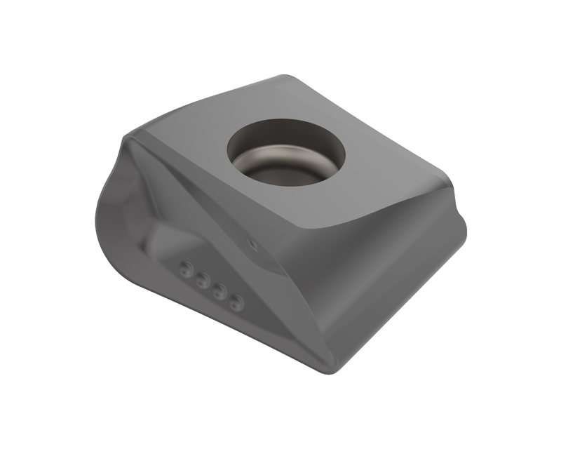

MS2500
Carbide P30 / medium grained
Coating medium thick CVD Ti(C,N) + Al2O3
Color Black
SMG P4 – P12 / M1 – M5 / S1 – S13
Coolant Dry + Wet
Application Grade with a tough CVD coating structure which is beneficial for rough milling of superalloy materials, tool steels as well as high alloyed stainless steels.
Tougher Grade Option MP3501
Harder Grade Option MP2501

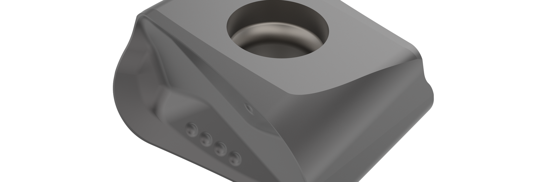

MP3501
Carbide P35 / medium grained
Coating medium CVD Ti(C,N) + Al2O3
Color Silver (Used Edge Detection Layer)
SMG P1 – P12 / M1 – M5 / K4 - K8
Coolant Dry + Wet
Application Your first choice for maximizing manufacturing output when dealing with wide variations in stability, versatility and workpiece material requirements. A versatile and reliable grade ideal for milling in steel, stainless steel and superalloys under both stable and unstable conditions. It is a tougher alternative to MP2501 to overcome issues like edge chipping. Can be applied under dry and wet machining conditions.
Tougher Grade Option MM4500

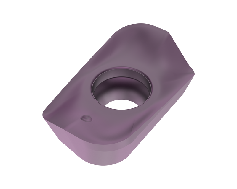

Application Most universal grade that can handle all materials. High performance in low to medium alloyed steels, stainless steels as well as titanium based materials. PVD-coated grade for fine to medium rough milling. First choice for milling with small feeds and/or low cutting speeds. Excellent for milling when there is a risk of vibrations and when coolant is used.
Tougher Grade Option MP2050
Harder Grade Option MS2050

MP2050
Carbide P40 / coarse grain
Coating PVD TiAlSiN
Color Purplish
SMG P11 - P12 / M1 – M5 / S1 – S13
Coolant Dry
Application High performance and extremly tough PVD-coated grade for tough machining conditions when facing vibrations, interrupted cuts, hard crusts and high temperatures. Made for martensitic steels, austenitic stainless steel as well as super alloys in unstable conditions. Ideal for dry machining conditions but a bit more cutting speed sensative under wet cutting conditions.
