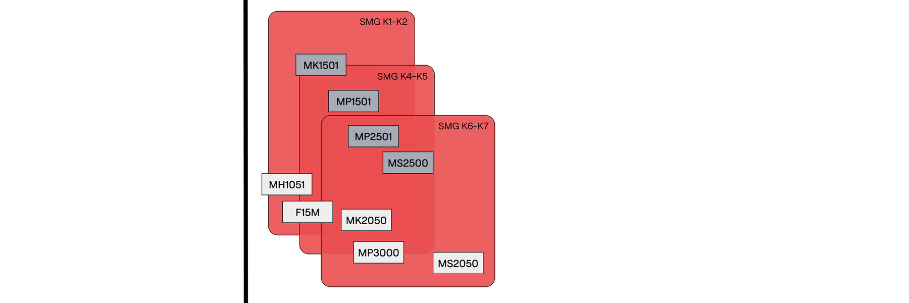

A mapping of Cast Iron Milling grades and how to select the right one.Material grouping and Grades references for Cast Iron
SMG K (Cast Iron) is divided in 7 sub-groups, to capture specific material characteristics and reduce the complexity of every specific material.
Based on grade portfolio, first and second choices are provided for each sub-groups. This is a starting grade recommendation which can be optimized depending on the application, based on below mentioned grade mapping.

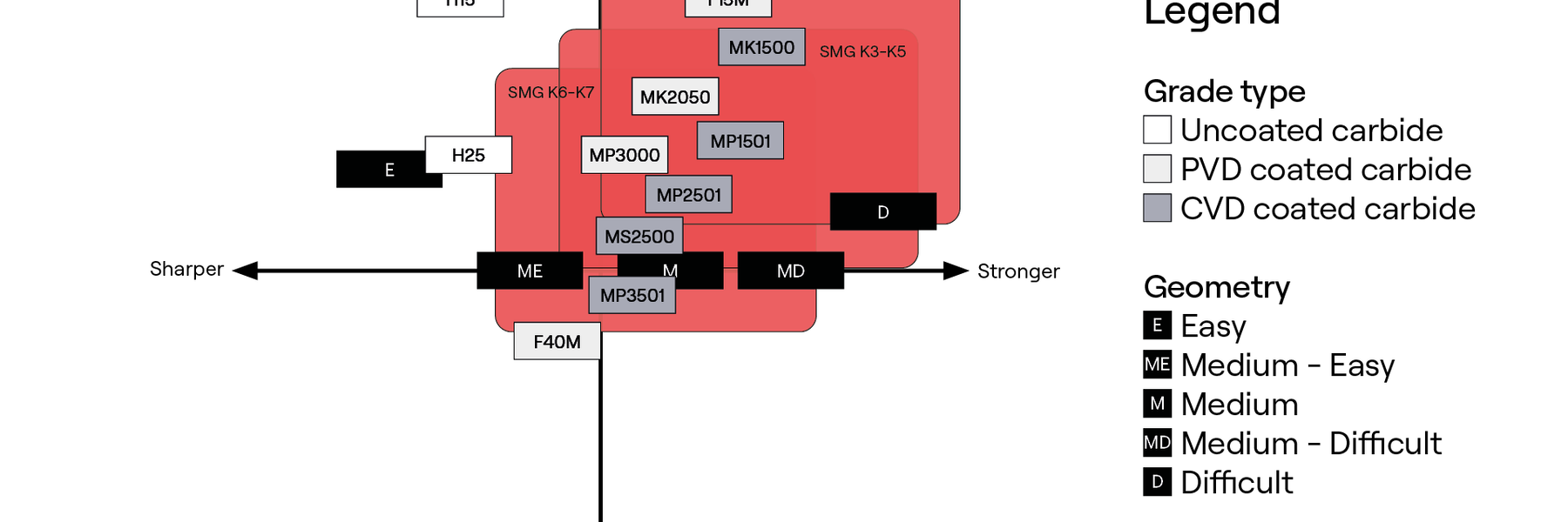

Mapping of Cast Iron milling grades
