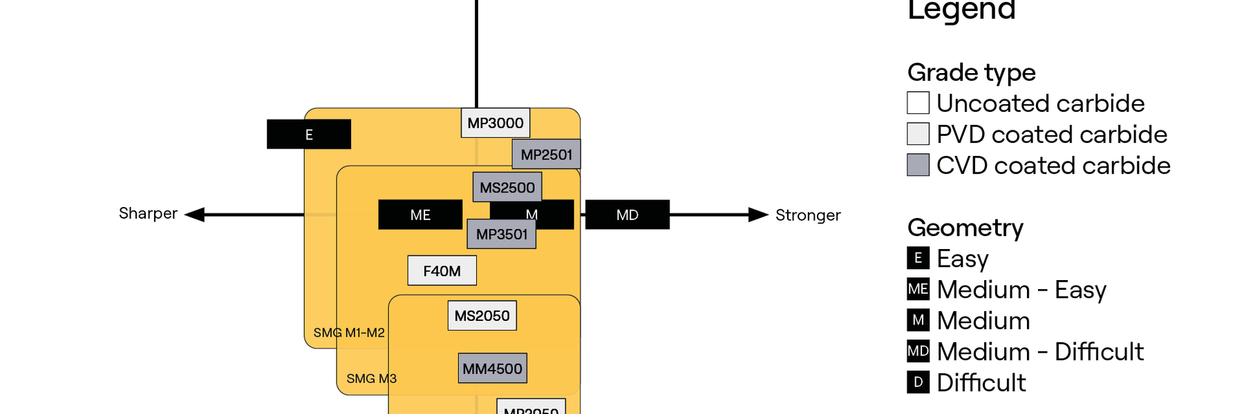

A mapping of Stainless Steel Milling grades and how to select the right one.Material grouping and Grades references for Stainless Steel
SMG M (Stainless Steel) is divided in 5 sub-groups, to capture specific material characteristics and reduce the complexity of every specific material.
Based on grade portfolio, first and second choices are provided for each sub-groups. This is a starting grade recommendation which can be optimized depending on the application, based on below mentioned grade mapping.

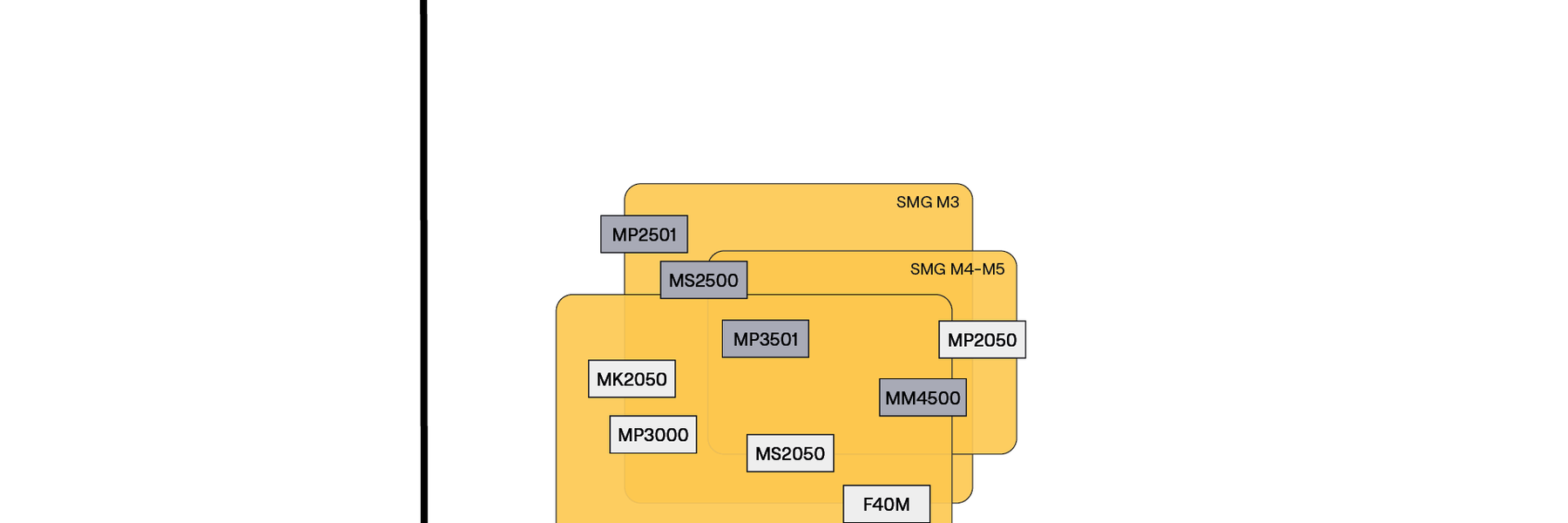

Discover this material in details
Mapping of Stainless Steel Milling grades
Discover our Product Range
