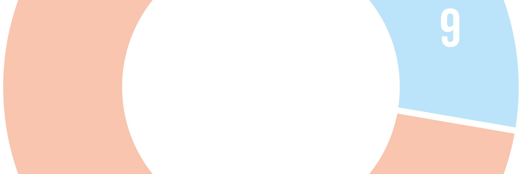

GLOBAL PRODUCTION ECONOMY IS DEFINED AS “ASSURING MAXIMUM SECURITY IN AND PREDICTABILITY OF THE PROCESS, WHILE MAINTAINING THE HIGHEST PRODUCTIVITY AND LOWEST PRODUCTION COSTS.” THIS DEFINITION LEADS THE WAY TO ACHIEVE THE FINAL GOAL OF EVERY MANUFACTURING PROCESS: PRODUCE CORRECT AND FINISHED WORKPIECES WITH MINIMUM EFFORT, IN THE SHORTEST TOTAL TIME AND AT THE LOWEST POSSIBLE COST.
- Productive Time
- Tool Handling
- Problem Solving
- Workpiece Handling
- Machine Set-up
| 6. Cutting Tools
7. Coolant
8. Other tools
9. Overhead
10. Machine Labour
Microeconomic analysis of costs and time in metal cutting production illustrates several points.
- The overall production process spends a large amount of time on machine setup, tool handling and problem solving. Easy-to-use, versatile tooling minimizes this and increases the time available for effective production.
- Once setup is complete, the next priority should be to use the available productive time as efficiently as possible.
- Tooling represents a relatively low percentage of the total cost picture. A well-used and functioning tool costs less than a non-working tool that halts production and thereby costs a fortune.

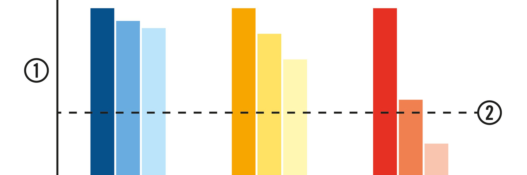

Productivity means higher cutting conditions, but...security?
1. Tool Life
2. Minimum Security level
ap for 5 / 5.5 / 6 mm
f for 0.50 / 0.55 / 0.60 mm/rev
Vc for 200 / 220 / 240 m/min
As an example, increasing cutting conditions by 10% increases metal removal rate (productivity by 10%. But costs and security?
THROUGHOUT OPTIMIZATION, THE PRIMARY CONCERN ALWAYS MUST BE TO KEEP THE PROCESS SAFE AND RELIABLE. NO ONE IS INTERESTED IN FAST PRODUCTION OF CHEAP BUT DEFECTIVE WORKPIECES. MAXIMUM SECURITY AND PREDICTABILITY OF METAL CUTTING CAN BE ACHIEVED ONLY THROUGH A PROFOUND UNDERSTANDING OF THE PROCESS AND THE INTERACTION AMONG ALL ITS VARIABLES.
For example, which cutting condition should we increase to reduce machining time? We could work with depth of cut, feeds or cutting speeds. All three would help us achieve our target of reduced machining time, but the impact on process reliability is dramatically different depending on the cutting condition we alter. Depth of cut has no serious impact on tool life (security and costs, but stability can be an issue), but cutting speed makes a very big difference. High cutting speed influences cutting tool costs considerably, as well as process reliability.

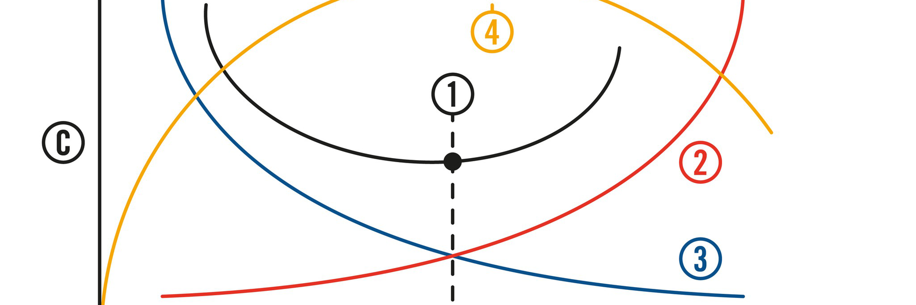

Production costs represent the sum of tool costs and machine costs
When we evaluate these costs, we observe increased cutting speeds produce lower costs, but that at a certain point, costs begin to increase again. At a certain cutting speed, tool life becomes so short and cutting edges must be replaced so often that decreased machine cost has a smaller effect on the total picture than fast-increasing tool cost. The goal is to find the cutting speed at which the sum of the two costs balances to the minimum total cost. This is called the economical cutting speed, and the accompanying tool life is called the economical tool life.*
Production Economy - Cost
A. Machining Costs / workpiece
1. Economic Cutting Data
2. Tool Costs
3. Machine Costs
ECONOMIC CUTTING DATA FORMULA
1 Kg
TC = ( ___ - 1 ) ___________
m KL + CMT
m = Taylor constant
TC = Tool Life Minimum Cost
Kg = Tool Cost
KL = Machine Cost
CMT = Labour Cost

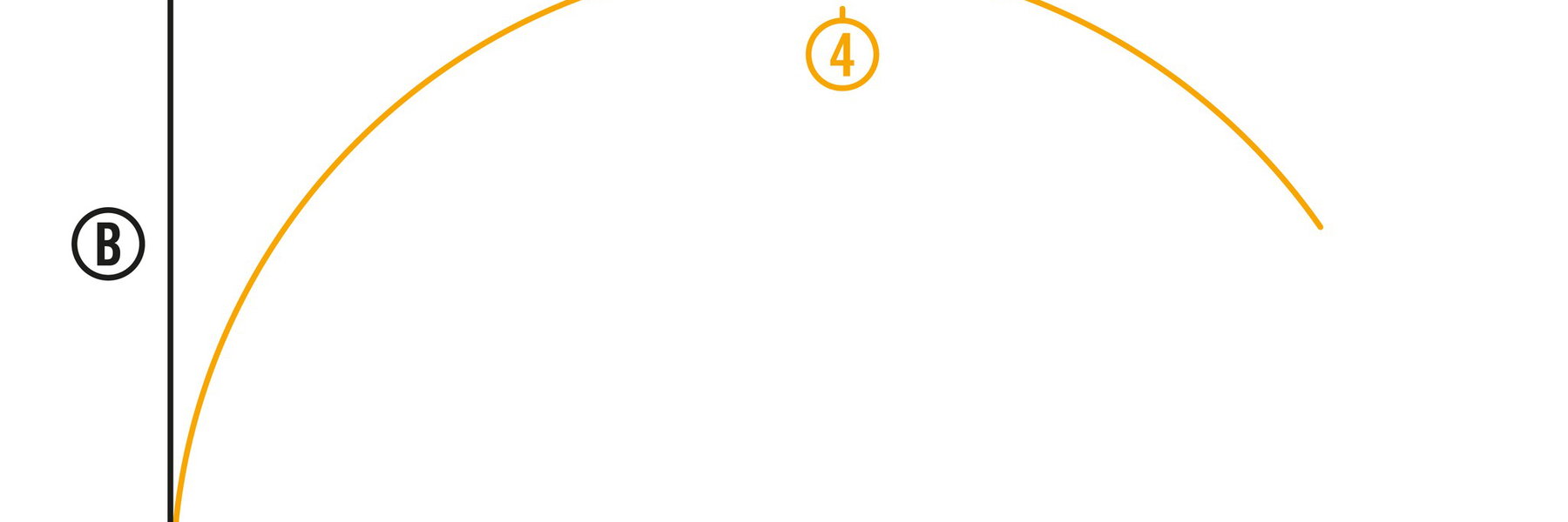

Production Economy - Productivity
B. Productivity
4. Cutting Data for Maximum Production
1
Tm = ( ___ - 1 ) TCT
m
m = Taylor constant
Tm = Tool Life Maximum Production
TCT = Time to Change the cutting edge
Production Economy - Minimum Cost and Maximum Productivity
C. Minimum Cost and Maximum Production
2. Tool Costs
3. Machine Costs
4 Cutting Data for Maximum Production
We can take this same approach to productivity. When cutting speed increases, MRR goes up and productivity increases. At some cutting speed, however, this effect reverses. Tool life becomes so short that the time gained through faster cutting is less important than the time lost because of the indexing times of worn-out cutting edges. This balanced cutting speed is called the cutting speed for maximum production, and the corresponding tool life is the tool life for maximum production.*
WHEN WE BRING COST EFFICIENCY AND PRODUCTIVITY TOGETHER, WE CLEARLY SEE HOW TO DEFINE THE CORRECT CUTTING SPEED. WHEN THE SELECTED CUTTING SPEED APPROACHES BOTH THE ECONOMICAL CUTTING SPEED AND THE CUTTING SPEED FOR MAXIMUM PRODUCTION, THE CUTTING SPEED IS CALLED THE HIGH-EFFICIENCY CUTTING SPEED (THE HE CUTTING SPEED).
