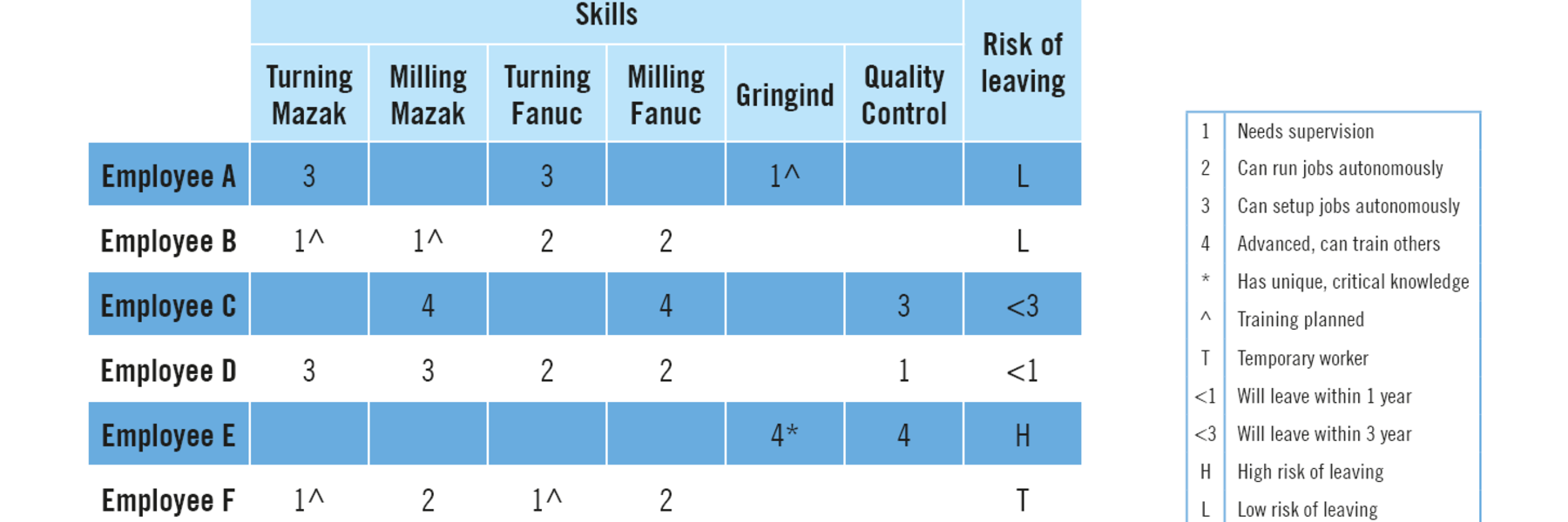

1) Update your Company's skills matrix
To start, conduct an overview of the situation and measure the extent of your problem. Many manufacturers already have a skills matrix of some sort where they track the skill level of every operator and which machines they are able to run. If this information is only in the head of your production manager, it is high time to put it on paper so that everyone – managers, HR, but also operators themselves – have a clear understanding of the situation.
While having a proper, up to date skills matrix is a good start, best practice is to add other layers to it, such as a risk assessment. A good skills matrix should help visualize which employees are likely to leave soon. You need to identify any upcoming retirements and the number of temporary workers you have along with any individuals who have expressed dissatisfaction with their job. You must also determine those individuals with critical knowledge that makes them difficult to replace, both upstream and downstream in your manufacturing process. For instance, they are the only ones who can run a particular machine or perform a complex task. Crossing these layers of information – knowledge, skills and risk – will ensure you can always serve your customers even if you lose key workers.
Download here an example file for a skills matrix
Example of a skill matrix
