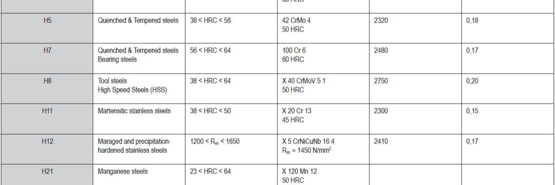

SMG H materials - Hard materials
ISO H Tab extract
