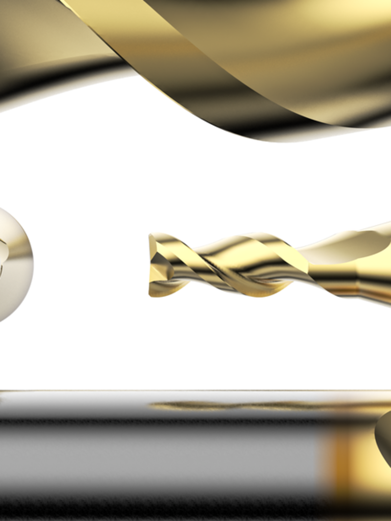

INCREASE TOOL LIFE WITH ELITE TOOL COATINGS
ALL ABOUT TOOLING COATINGSWHAT DO COATINGS DO?
In short, coatings increase tool life. They provide a thermal barrier between the cutting edge & the workpiece. Coatings increase the hardness on the surface of the tool. Coatings also increase lubricity for better chip flow and evacuation, causing less heat. They minimize built-up edge, improving surface finish, and reduce abrasive wear.
PVD COATINGS
- TiN - TITANIUM NITRIDEA general-purpose coating for HSS, HSCO, and Solid Carbide end mills that provides effective protection against wear, abrasion, and edge buildup. Primary applications are milling steels in a non-hardened condition.
