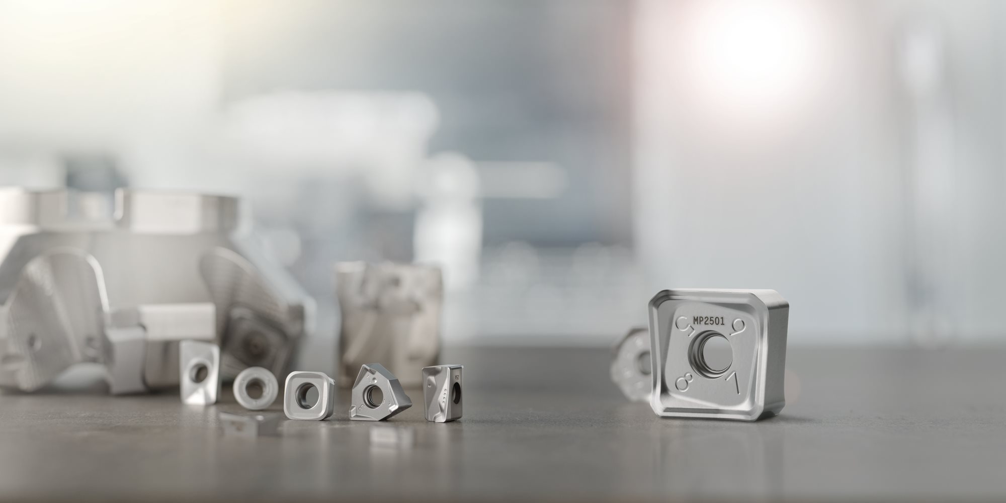

Increase your process security and cost-effectiveness for savings of up to 20 percent with the MP1501, MP2501 and MP3501 milling grades from Seco Tools, which deliver high reliability for steel and cast iron machining.Discover the product range
Inconsistent and unreliable milling processes can keep you from being profitable and competitive. Increase your process security and cost-effectiveness for savings of up to 20 percent with the MP1501, MP2501 and MP3501 milling grades from Seco Tools, which deliver high reliability for steel and cast iron machining. These Duratomic® grades with improved coating offer exceptional toughness and edge strength that prevent comb cracks and unexpected breakage. This offers the highest level of productivity, tool life predictability and process reliability. Used edge detection will make it obvious which insert edges are used and prevent insert waste.
- MP1501 for medium-rough milling for hardened steel (up to 45HRC) and roughing grey as well as nodular cast iron
- MP2501 for milling steel and easy/medium stainless steel, suitable for machining with or without coolant and provides excellent finishing ability
- MP3501 is our latest developed grade. With increased toughness and with good heat resistance for substantially increased tool life and improved process security, MP3501 complements the grade chain within the CVD area for machining steel materials.
- All new Duratomic® MP grades feature the newly improved coating and chrome colored used edge detection
Your main benefits:
- Improved coating provides improved toughness and strength
- Used edge detection reduces unnecessary waste and subsequently the average cost per edge
- A choice between longer tool life for cost-effectiveness or increased productivity/cutting speeds
- Greater process predictability in steels and cast irons
